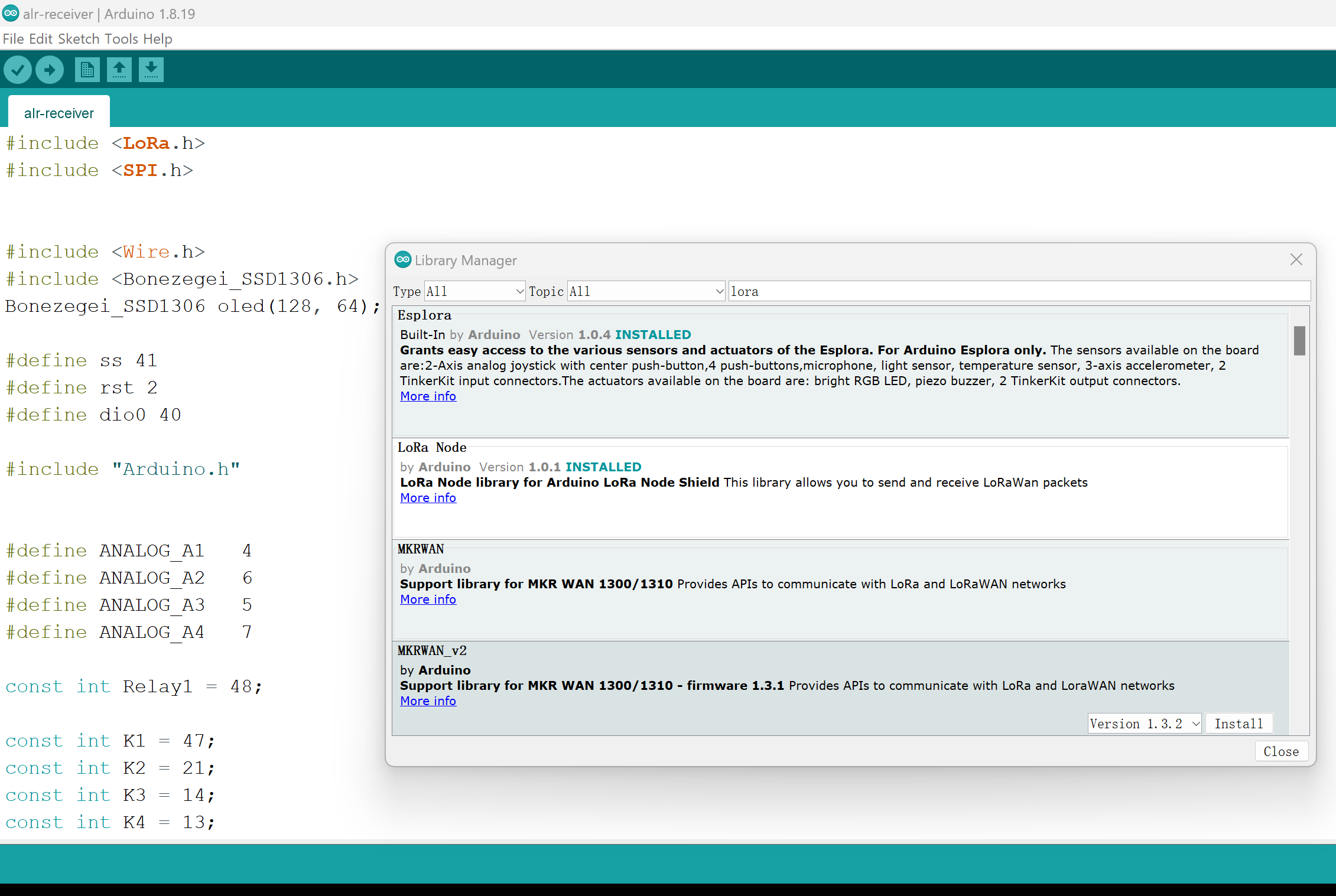

before use this code, need to install LoRa SX1278 arduino library firstly.
[attachment=5665]
[attachment=5791]
i have done these instruction. it doesn't work.
Error Msg in Arduino:
LoRa_Receicer_KC868:7:10: fatal error: LoRa.h: No such file or directory
#include <LoRa.h>
compilation terminated.
exit status 1
the lib is installed!
I found the Solution:
I had to download the ZIP-File and then to use the Option: ADD Zip Library
downloaded from https://github.com/sandeepmistry/arduino-LoRa
I have found the solution:
download from: https://github.com/sandeepmistry/arduino-LoRa
