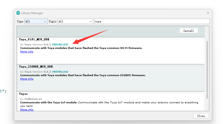

if you want to compile with Tuya arduino code. you need to install tuya wifi module arduino library firstly.
[attachment=5759]
(08-04-2024, 11:59 PM)admin Wrote: [ -> ]if you want to compile with Tuya arduino code. you need to install tuya wifi module arduino library firstly.
Thank you very much, I checked and have all the librairies installed, I'm using ESPHome and not Arduino IDE by the way so I presume that for the first time my ESPHome cannot locate the librairie....it's weird but it can be.
