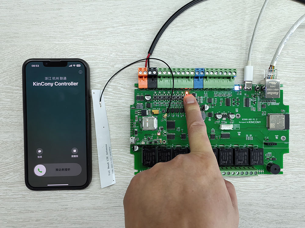

Full Version: how to use binary sensor make VOICE CALL by SIM7600E 4G module in ESPHome
the ESPHome yaml demo made for KinCony KC868-A8S relay board. Actually you can use for any KinCony SIM7600 relay board, just replace 4G module's TXD,RXD define.

# UART configuration for SIM7600E
uart:
  tx_pin: GPIO13
  rx_pin: GPIO15
  baud_rate: 115200
  debug:
    direction: BOTH
    dummy_receiver: true
    after:
      timeout: 10ms
    sequence:
      - lambda: UARTDebug::log_string(direction, bytes);
binary_sensor:
  - platform: gpio
    on_press:
      then:
        - uart.write:
            data: "ATD15381188302;\r\n"  # Replace with the phone number you want to dial
    pin:
      pcf8574: pcf8574_hub_in_1
      number: 0
      mode: INPUT
      inverted: true

I just bought the A2 + SIM7600
Could you please make an example how to receive a call and trigger one or more outputs depending on the caller ID?
thank you so much
when have free time, i will have a test. when received a call let relay ON?
post new code at here: https://www.kincony.com/forum/showthread.php?tid=6763
voice call turn on relay1 ESPHome yaml for KC868-A2 board.
