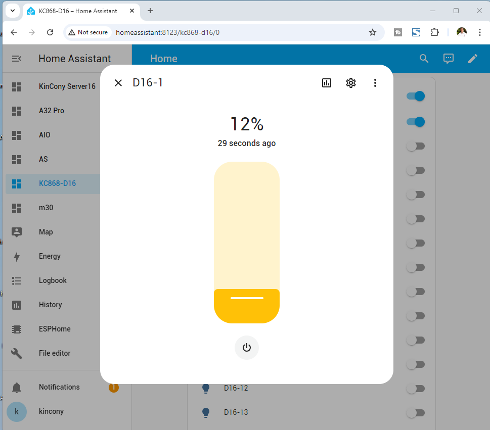

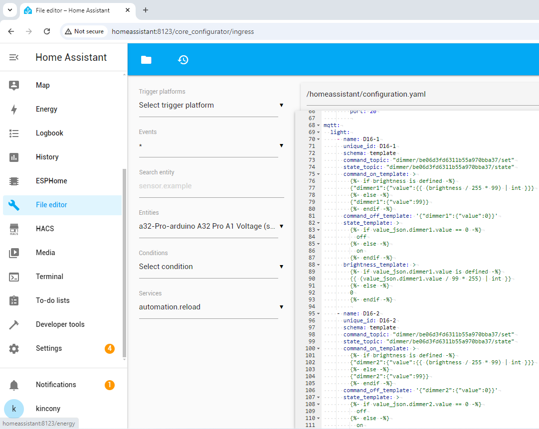

new configuration.yaml file for home assistant MQTT. this file fixed linear issue.
[attachment=5901]
[attachment=5902]

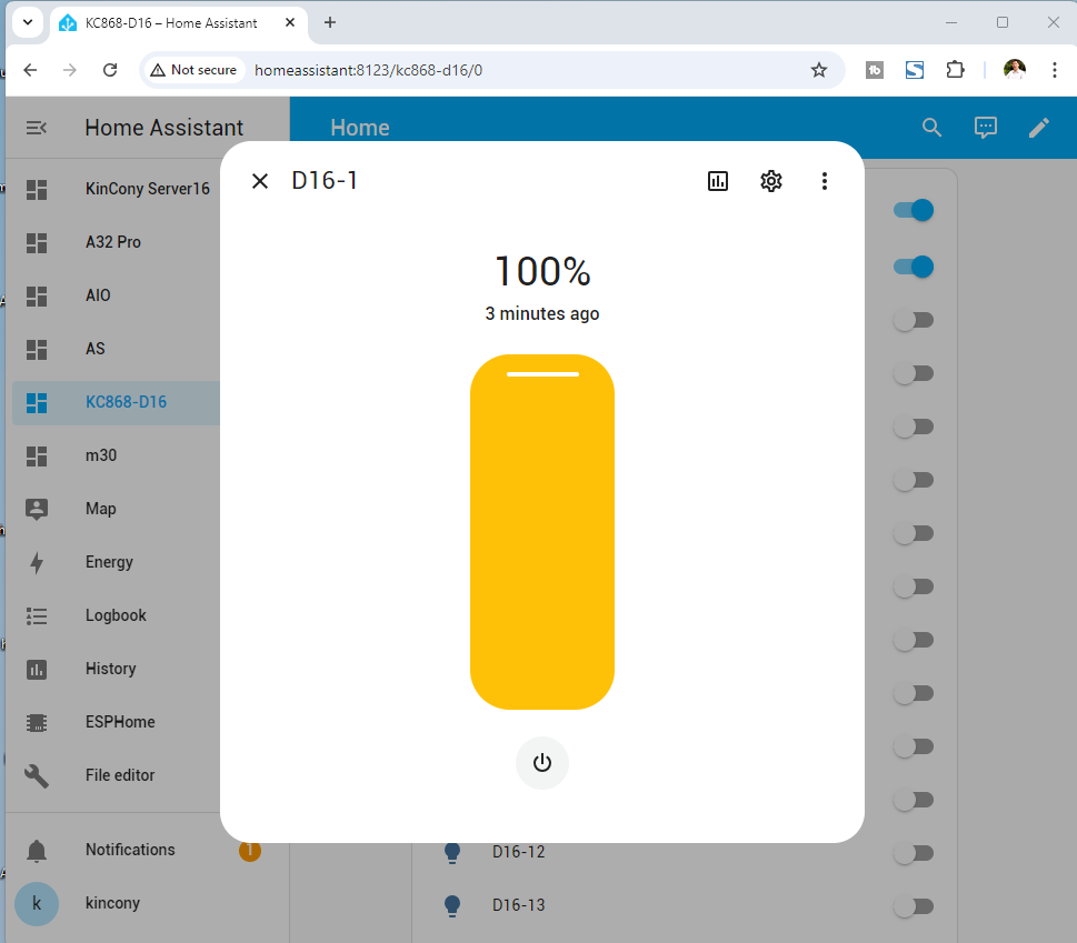

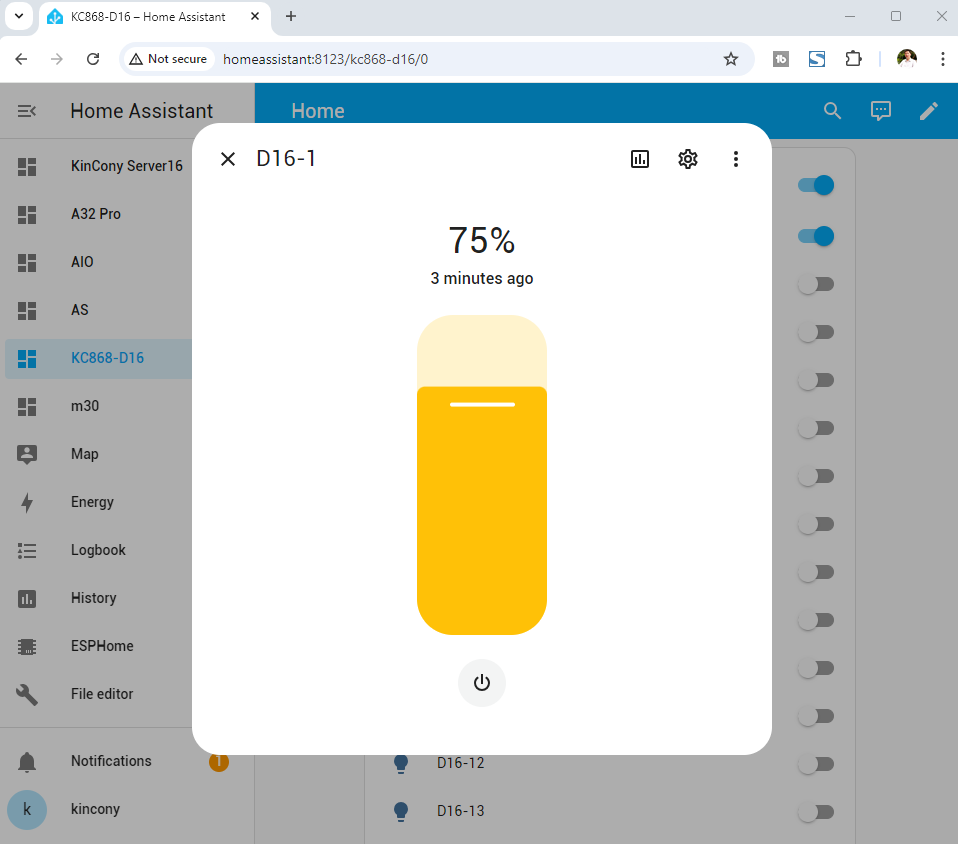

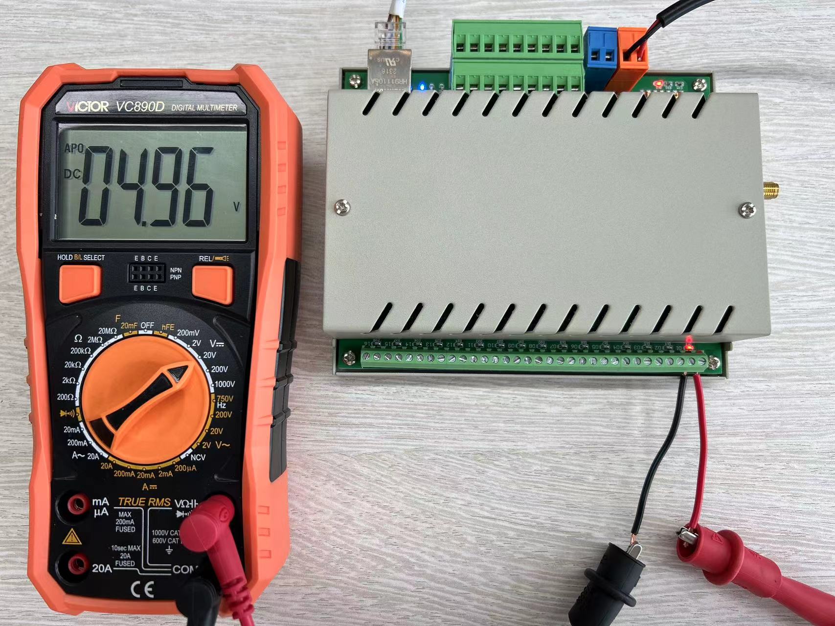

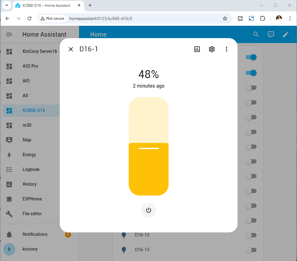

yaml file download: [attachment=5903]
[attachment=5904]
[attachment=5908]
[attachment=5905]
[attachment=5909]
[attachment=5906]
[attachment=5910]
[attachment=5907]
[attachment=5911]
linedddar issuedd
