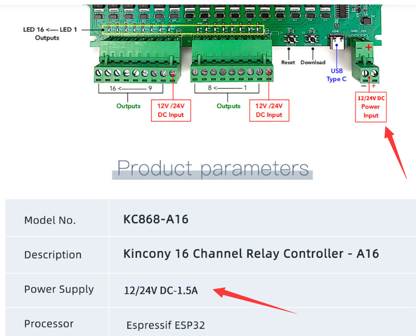

Have you considered updating documentation and inscriptions on the board? This is hidden feature right now Wink

ok, updated in our webpage.
[attachment=5935]
