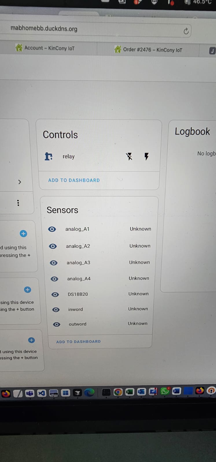

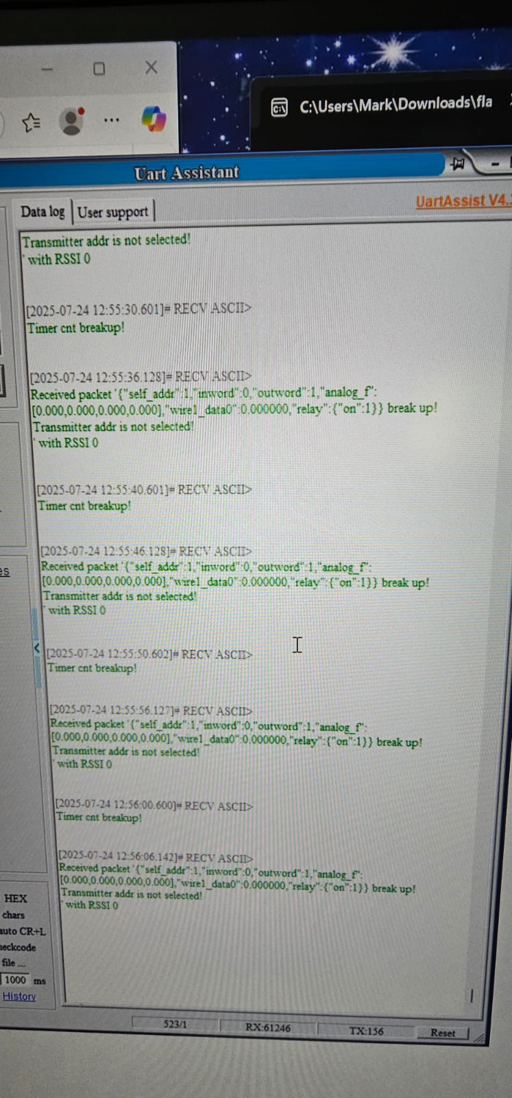

[attachment=8017][attachment=8018][attachment=8019]
(07-24-2025, 07:06 AM)markbrewer Wrote: [ -> ]Hi, I am able to transfer the transmit firmware to both boards, however when I flash the ALR-Receive firmware ALR-RECEIVER-20240904.ino.merged it uploads but when I reboot the device the KinCony is displayed on the screen. What am I missing?
Ok it was installing the firmware and was waiting for me to configure the wifi and mqtt settings.
In Home Assist, although I can control the relay, the status of the relay and the analogue values are not shown. See attached images.
