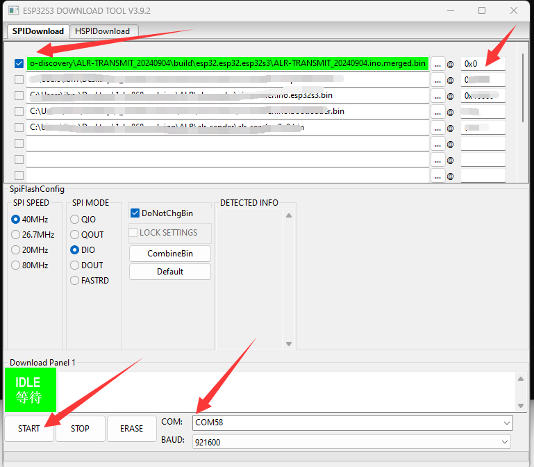

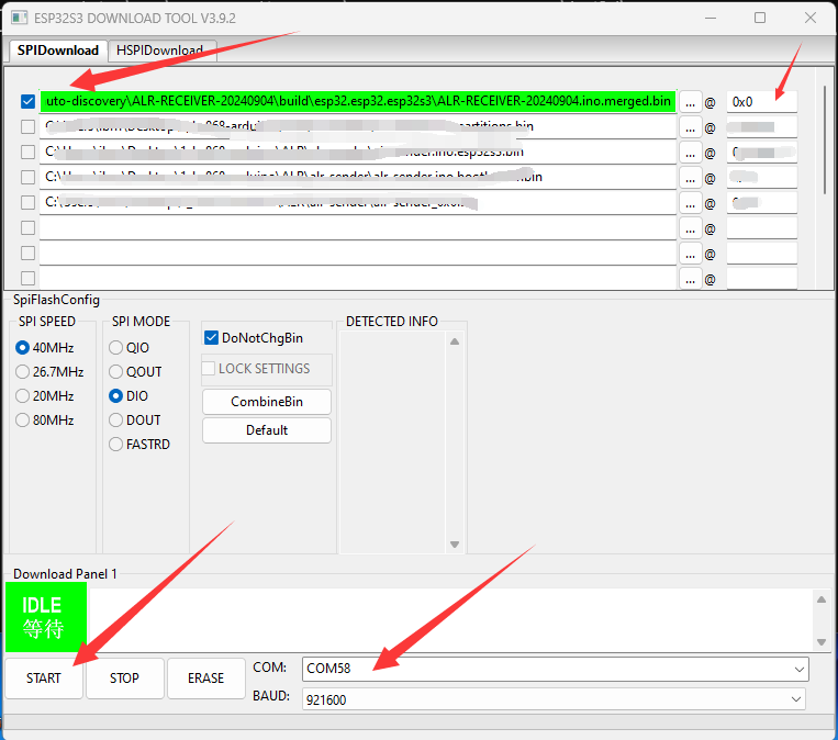

download firmware by ESP32 DOWNLOAD TOOL:
[attachment=5967]
chose ESP32-S3 and USB mode.

chose RECEIVER board's firmware and set address to 0x0

chose TRANSMIT board's firmware and set address to 0x0

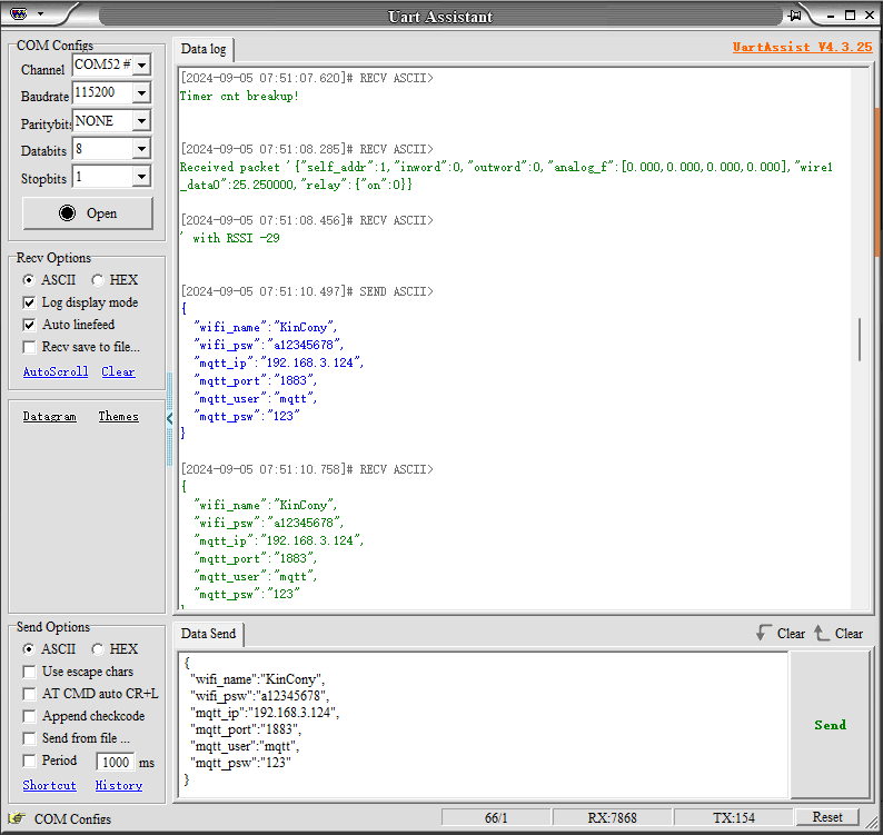

set router's wifi ssid, password, mqtt broker ip, mqtt port, mqtt username, mqtt password for RECEIVER board via USB-C cable.
config json command:
  "wifi_name":"KinCony",
  "wifi_psw":"a12345678",
  "mqtt_ip":"192.168.3.124",
  "mqtt_port":"1883",
  "mqtt_user":"mqtt",
  "mqtt_psw":"123"
[attachment=5970]

Hello, I have problems to write code and now I need to test original firmware.
While uploading my installed code is not removed.
The flash tools says finish, but I hear the my old code (which reboots ever second) was not overwritten.
In the flasher cmd windows I see following prompt:
Uploading stub...
Running stub...
Stub running...
Changing baud rate to 921600
Changed.
NO XMC flash detected!
SPI_BOOT_CRYPT_CNT 0
SECURE_BOOT_EN False
is stub and send flash finish
it detects following info:
AP: DCDA0C7B7EE5 STA: DCDA0C7B7EE4
BT: DCDA0C7B7EE6 ETHERNET:
The display keeps dark.
Any Idea what I should do?
Thanks, Martin
All fine. I found problem..I did not check mark the box of the bin file :-)

I have followed the instructions posted above and found them to be pretty easy to follow be connecting a few dots in places where it was unclear to me, I'm a novice here, so there are gaps in my knowledge that can be challenging to overcome at times. Ultimately, I believe I have the UART Assist working with the board after using the ESP download tool to load the reciever firmware. When I connect the UART Assist at 921600 baud and match the other settings found in the forum, I get a "begin LoRa Initializing OK!" message. Then I modify the Wifi and MQTT settings and click Send, but I get no confirmation, should I be getting something back or should the board display itself show something other than "KinCony"?

I wanted to add a note that I have checked on my WiFi router and the LoRa board is not seen as an attached device after uploading the WiFi network id and password using UART Assistant. I assume that it should attach to the network even if it does not have LoRa data to forward via MQTT to HA.
