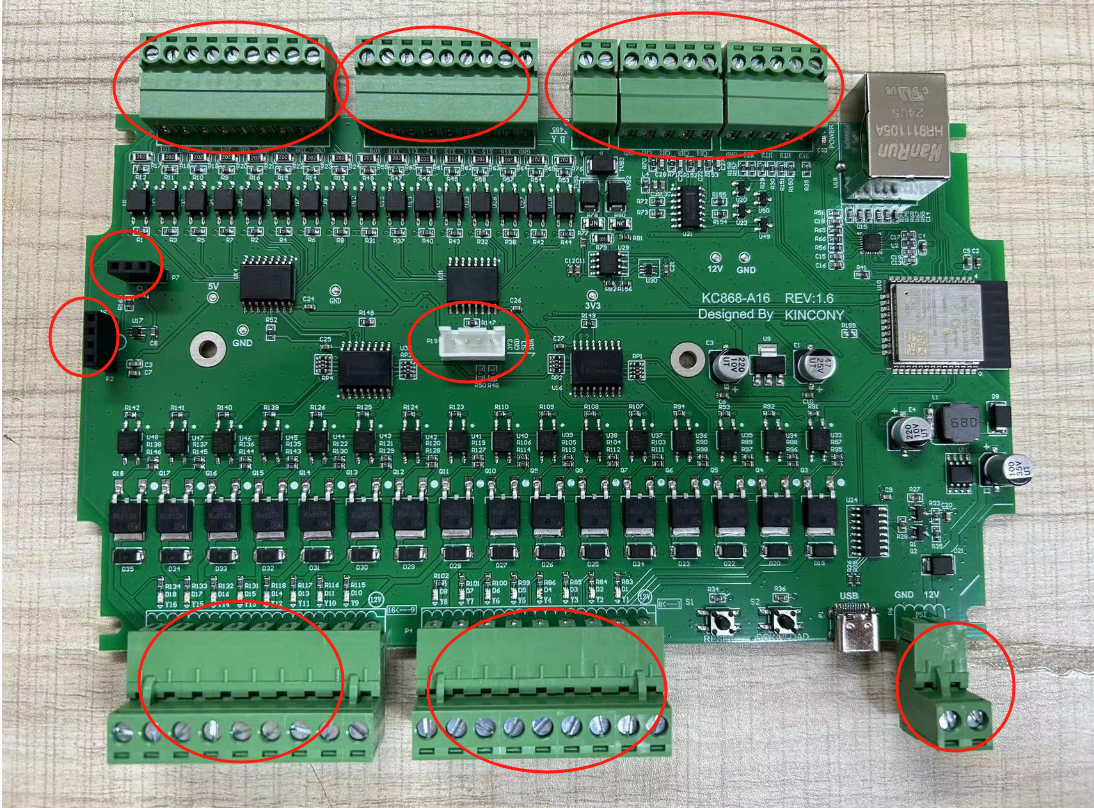

The pictures of the KC868-A16 show that the RF sender/receiver and the I2C don't have sockets. Is the correct? If so, is it possible to get the board with the sockets soldered on?
now KC868-A16 have weld all sockets. just webpage photo not updated. see here:
[attachment=6088]
