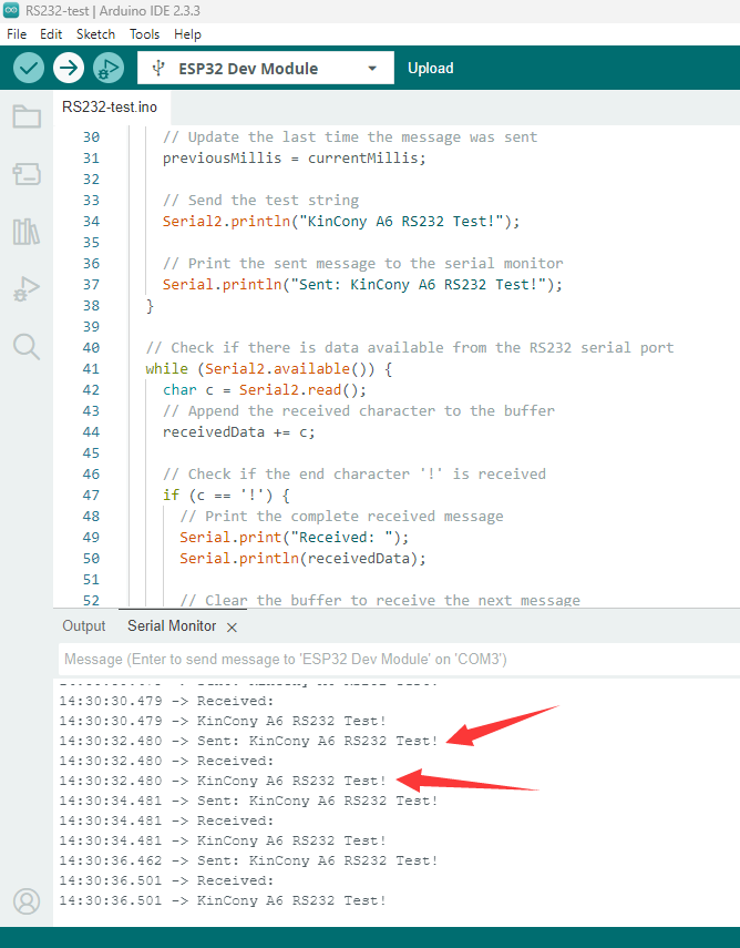

use this arduino code to test RS232:
// Define GPIO pins for RS232 interface
#define RS232_TXD 17
#define RS232_RXD 16
unsigned long previousMillis = 0;  // To store the last time the message was sent
const long interval = 2000;        // Interval between messages (2 seconds)
String receivedData = "";  // Buffer to store received data
void setup() {
  // Initialize the serial port for debugging
  Serial.begin(115200);
  while (!Serial) {
    ; // Wait for the serial port to initialize
  // Initialize the RS232 serial port
  Serial2.begin(9600, SERIAL_8N1, RS232_RXD, RS232_TXD);
  // Wait for the serial communication to stabilize
  delay(1000);
void loop() {
  // Get the current time
  unsigned long currentMillis = millis();
  // Check if 2 seconds have passed since the last message was sent
  if (currentMillis - previousMillis >= interval) {
    // Update the last time the message was sent
    previousMillis = currentMillis;
    // Send the test string
    Serial2.println("KinCony A6 RS232 Test!");
    // Print the sent message to the serial monitor
    Serial.println("Sent: KinCony A6 RS232 Test!");
  // Check if there is data available from the RS232 serial port
  while (Serial2.available()) {
    char c = Serial2.read();
    // Append the received character to the buffer
    receivedData += c;
    // Check if the end character '!' is received
    if (c == '!') {
      // Print the complete received message
      Serial.print("Received: ");
      Serial.println(receivedData);
      // Clear the buffer to receive the next message
      receivedData = "";
[attachment=6167]

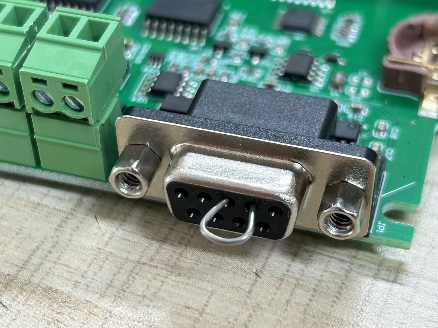

short RXD,TXD of RS232 port.
[attachment=6168]
You will send TEXT sent by RS232 and received, it will print by USB.
here is BIN file can directly to download at 0x0 address.
[attachment=6169]
I don't receive any answer
can you weld U14 chip: SP3232EEN
Do you mean remove it? Or what?
can you weld it again, if also can't work, maybe need replace a new one.
I don't understand what I have to do. I have to bridge tx and Rx?
