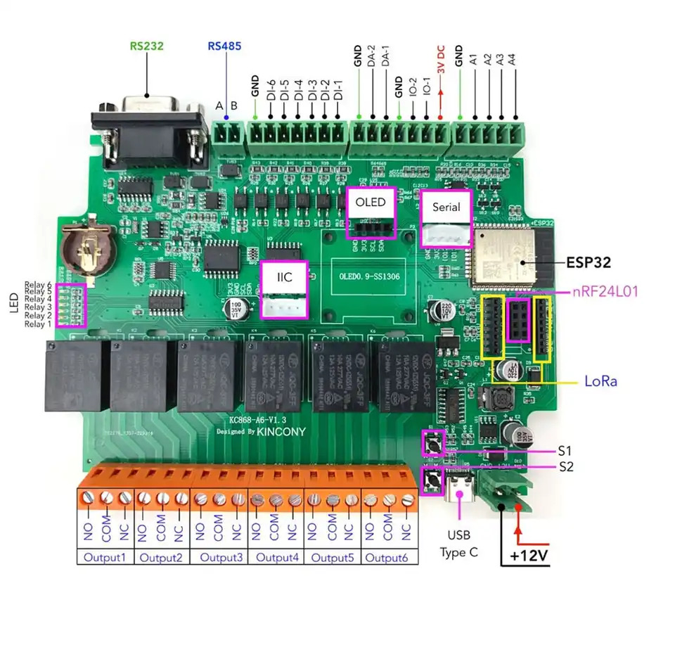

I explained it wrong. I want to read pwm input. Which GPIO pin is free i dont know but i know i use all input and output ports and serial port for hmi. Which pin is free and how can i access it ? Can you explain with schemes if needed ?
[attachment=6166]
10-01-2024, 10:20 PM
on the TOP-RIGHT photo, there label IO-1 and IO-2 you can use. they are GPIO32, GPIO33.
To read a PWM signal on a specific pin of the ESP32, you can't directly capture the PWM signal as an input in hardware. However, you can use the pulseIn() function in code to measure the high and low durations of the PWM signal, and from there, calculate the frequency and duty cycle.
