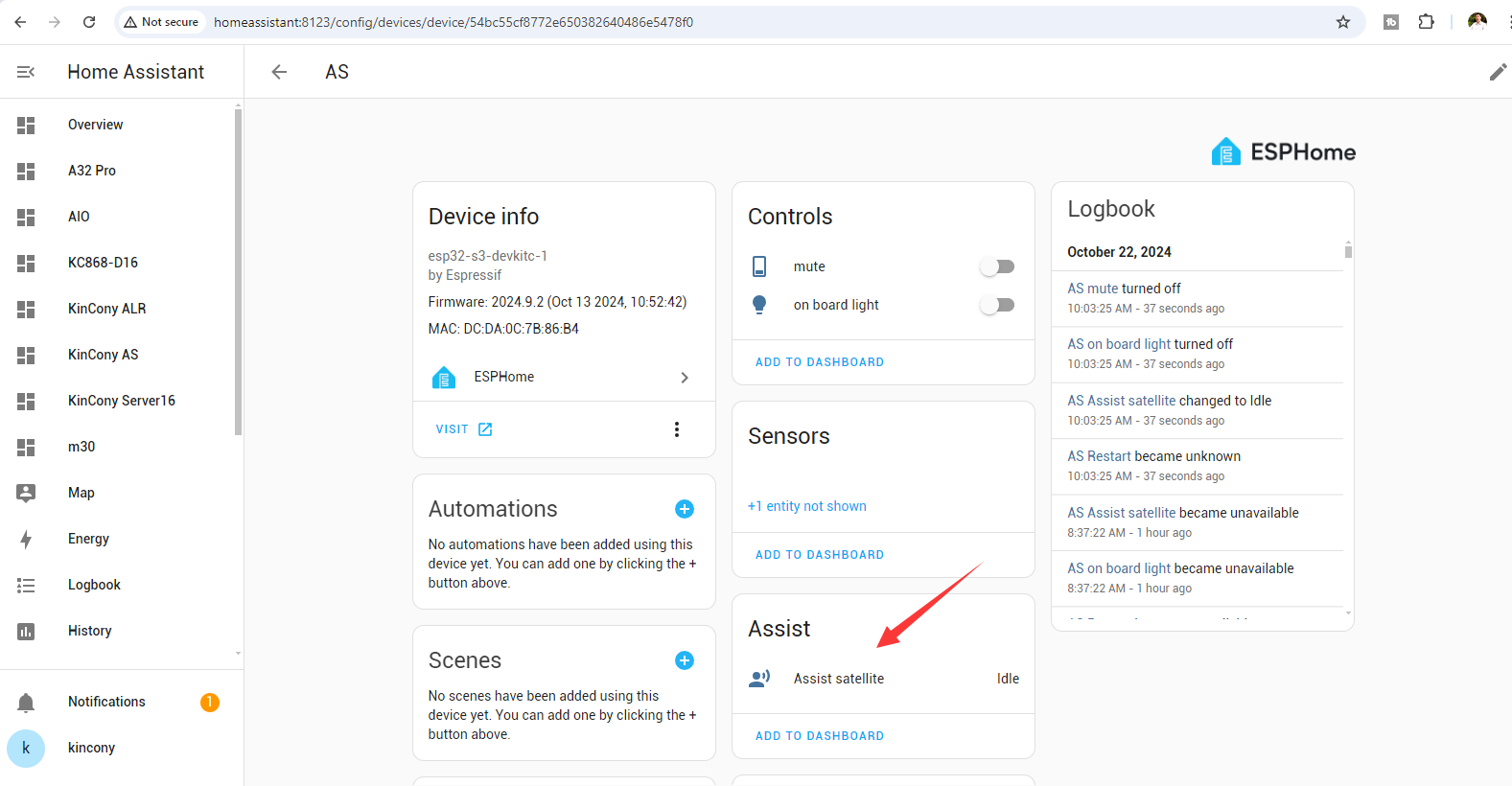

10-19-2024, 12:09 PM
[attachment=6317]
yaml file download:[attachment=6246]
