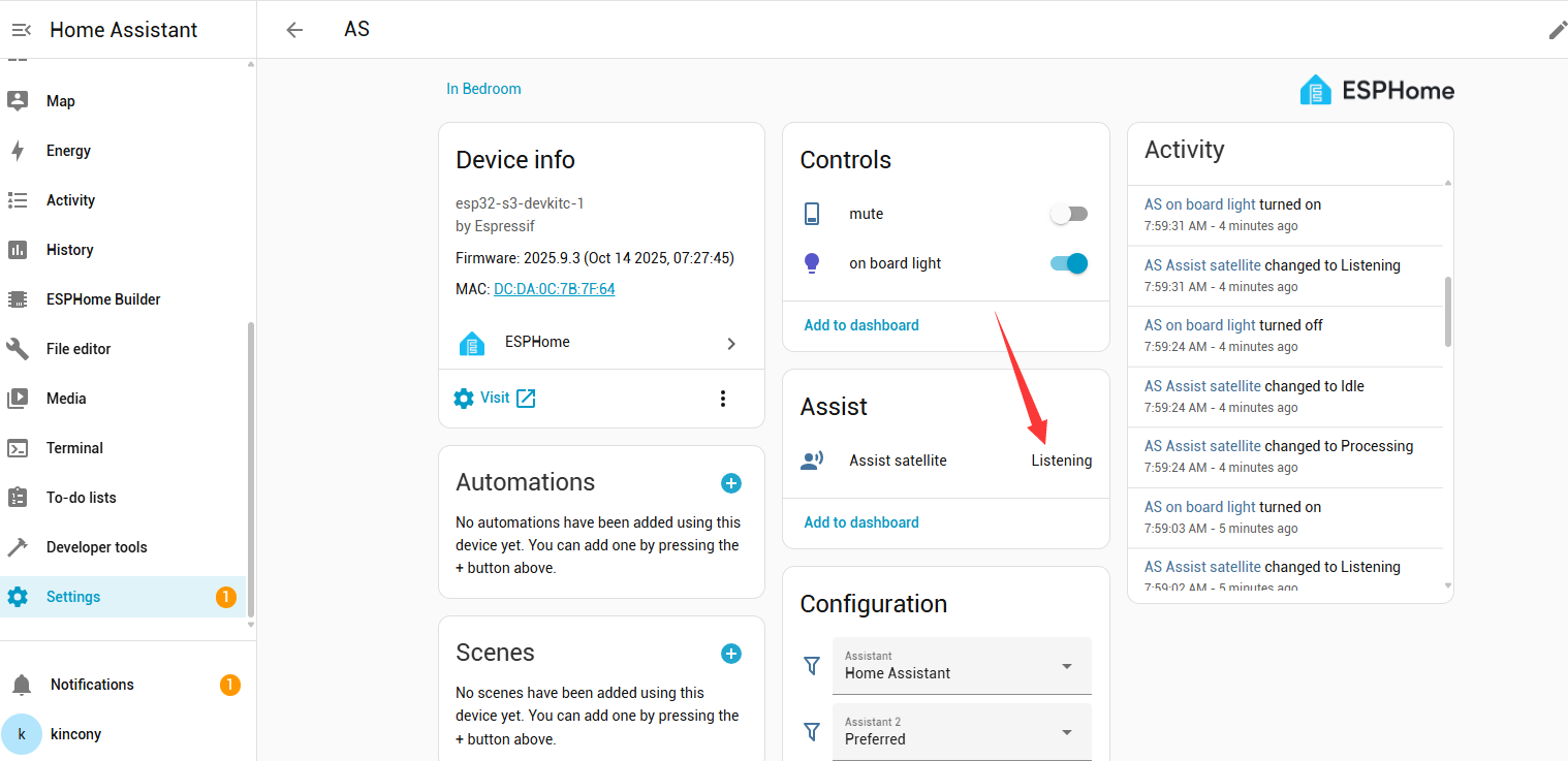

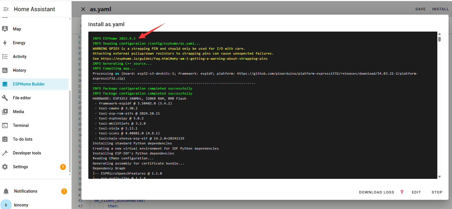

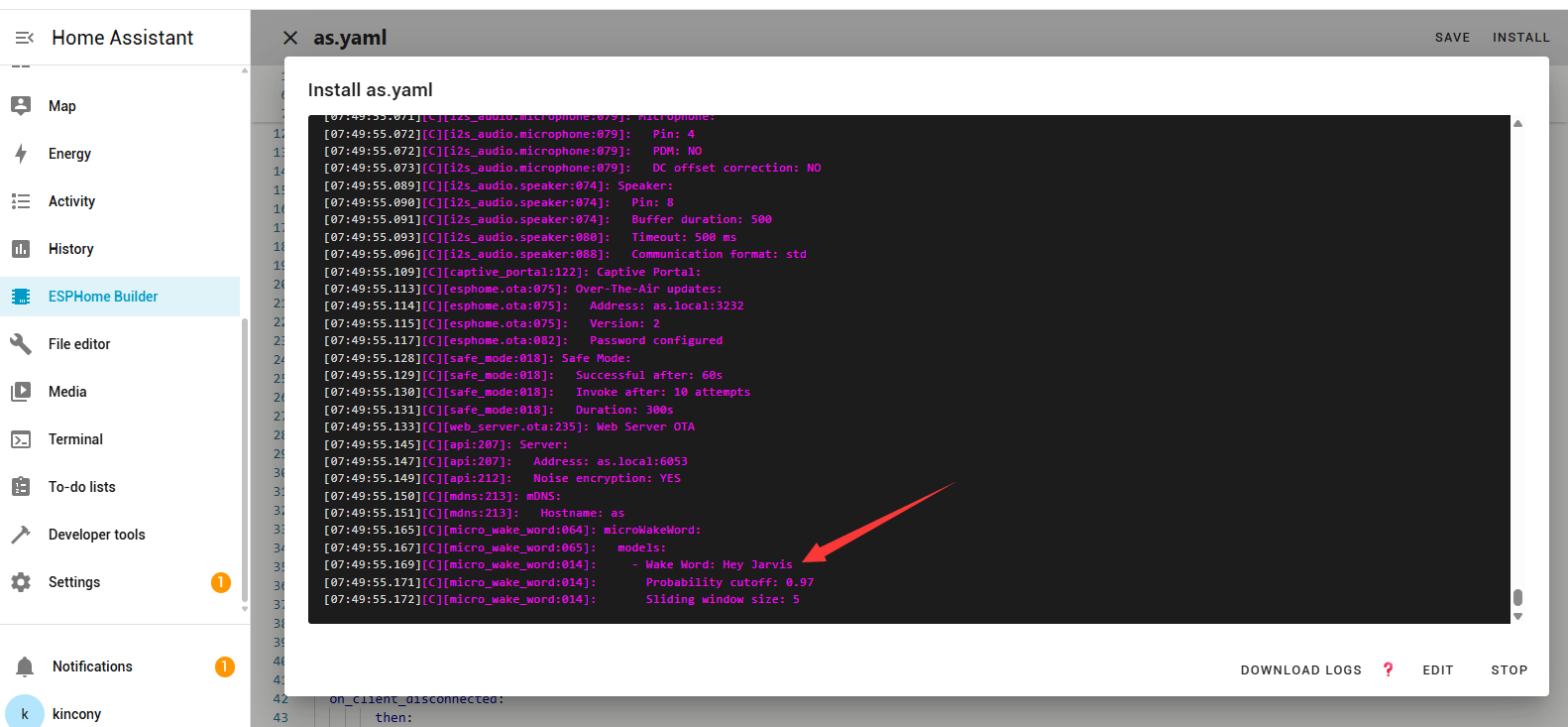

this is yaml file i have used, compiled with newest esphome, it can work well.
