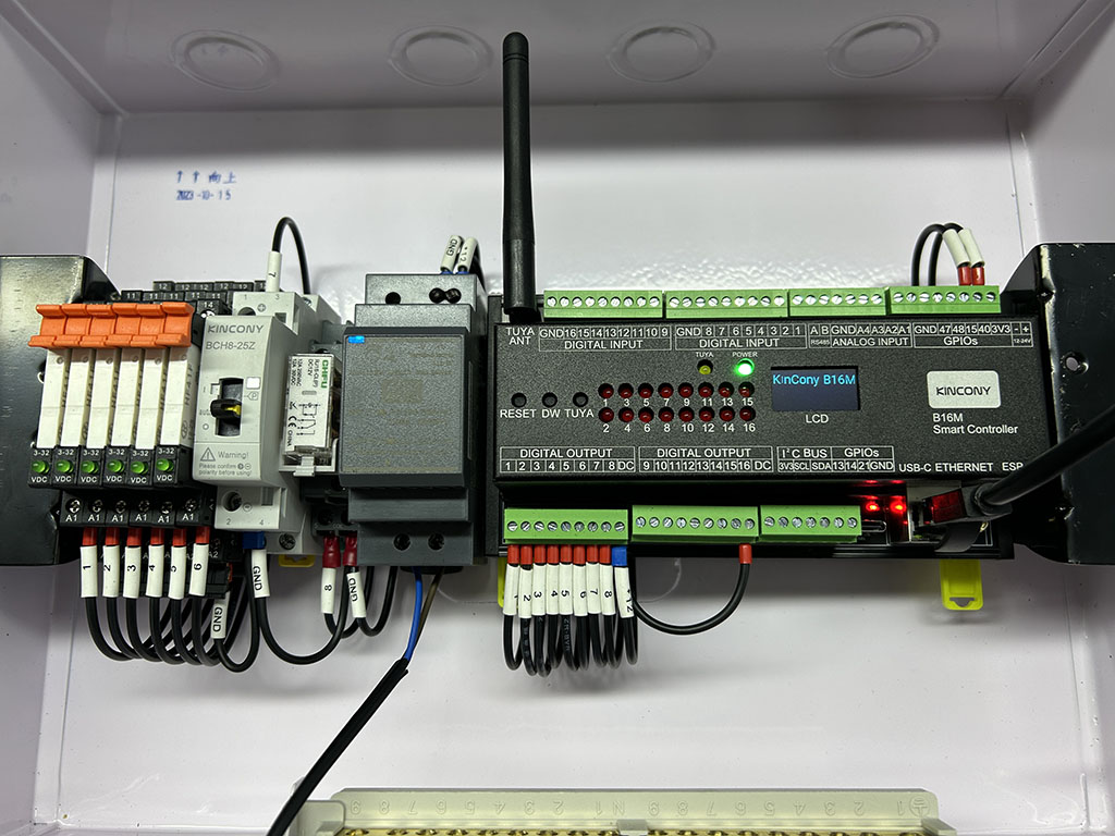

[attachment=6292]

  - platform: tuya_wifi_mcu
    dp_id: 126
    bind_binary_sensor_id: b16m_input16
    internal: true
##pull-up resistance on PCB
  - platform: gpio
    pin:
      number: 40
      inverted: true
  - platform: gpio
    pin:
      number: 15
      inverted: true
  - platform: gpio
    pin:
      number: 48
      inverted: true
  - platform: gpio
    pin:
      number: 47
      inverted: true
## without resistance on PCB
  - platform: gpio
    pin:
      number: 13
      inverted: false
  - platform: gpio
    pin:
      number: 14
      inverted:  false
  - platform: gpio
    pin:
      number: 21
      inverted: false
ads1115:
  - address: 0x48
sensor:
  - platform: ads1115
    multiplexer: 'A0_GND'
    gain: 6.144
    resolution: 16_BITS
    name: "ADS1115 Channel A0-GND"
    update_interval: 5s
  - platform: ads1115
    multiplexer: 'A1_GND'
    gain: 6.144
    name: "ADS1115 Channel A1-GND"
    update_interval: 5s
  - platform: ads1115
    multiplexer: 'A2_GND'
    gain: 6.144
    name: "ADS1115 Channel A2-GND"
    update_interval: 5s
  - platform: ads1115
    multiplexer: 'A3_GND'
    gain: 6.144
    name: "ADS1115 Channel A3-GND"
    update_interval: 5s
web_server:
  port: 80
font:
  - file: "gfonts://Roboto"
display:
  - platform: ssd1306_i2c
    i2c_id: bus_a
    model: "SSD1306 128x64"
    address: 0x3C
    lambda: |-
      it.printf(0, 0, id(roboto), "KinCony B16M");
ESPHome yaml file download:
[attachment=6291]
