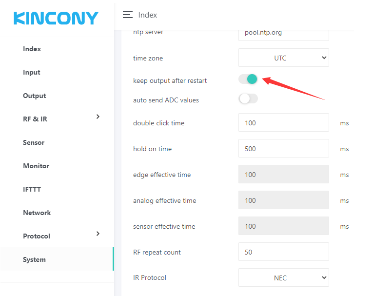

what's your means? if you enable KCS "remember output state" function, it just save last state, it don't cost many memory.
(11-05-2024, 12:19 AM)admin Wrote: [ -> ]what's your means? if you enable KCS "remember output state" function, it just save last state, it don't cost many memory.
I don't see any setting for this in KCS?

This is what I'm referring to, that it's saving the state every time there is a state change on the output. I'm not concerned with how much memory it's using but rather that it's using NVS, doesn't this mean it gets saved to flash? I want to avoid wearing out the flash as much as possible.
Hope this makes sense.
By the way writing my own firmware wasn't as difficult as I thought so this might be the solution for me for now as I primarily only care about the output's as they will be used to drive a bunch of relays.
Hi thank you for taking the time to add the screenshot. This was one of the things I tried initially but as far as I can tell it will still persist the state to NVS. E.g. whether or not output 1, 2 etc is enabled or disabled (or whenever the state changes). I made some good progress with my own firmware so I think I might cover my own needs for now.
