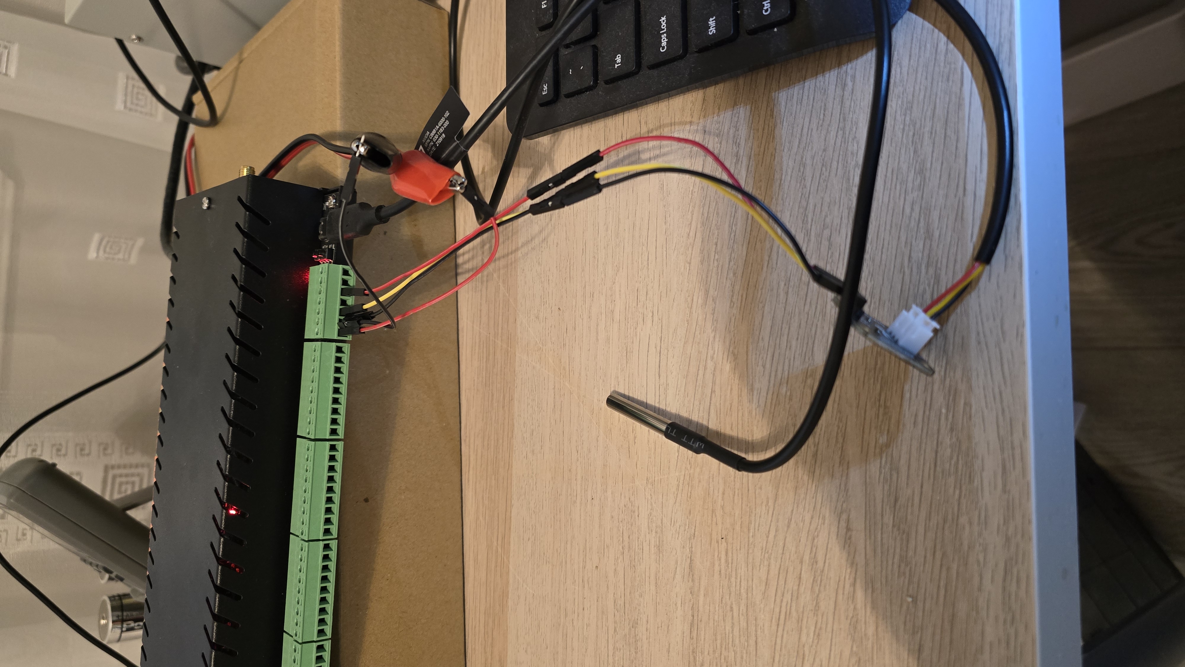

I am trying to connect  DS18b20 temperature sensor to KC868-AIO and get sensor ID from ESPHome logs
My configuration:
one_wire:
  - pin: GPIO01
    platform: gpio
This is what I am getting:
[10:58:55][C][gpio.one_wire:020]: GPIO 1-wire bus:
[10:58:55][C][gpio.one_wire:021]:  Pin: GPIO1
[10:58:55][W][gpio.one_wire:078]:  Found no devices!
[attachment=6462]
you can see esp32 pin define for KC868-AIO: https://www.kincony.com/forum/showthread.php?tid=2735
the 1-wire sensor gpio are:
DS18B20/DHT11/DHT21/LED strip -(TP1): GPIO14
DS18B20/DHT11/DHT21/LED strip -(TP2): GPIO5
so you use gpio14 or gpio5, NOT "gpio1"
Thanks. It works now with GPIO14.
