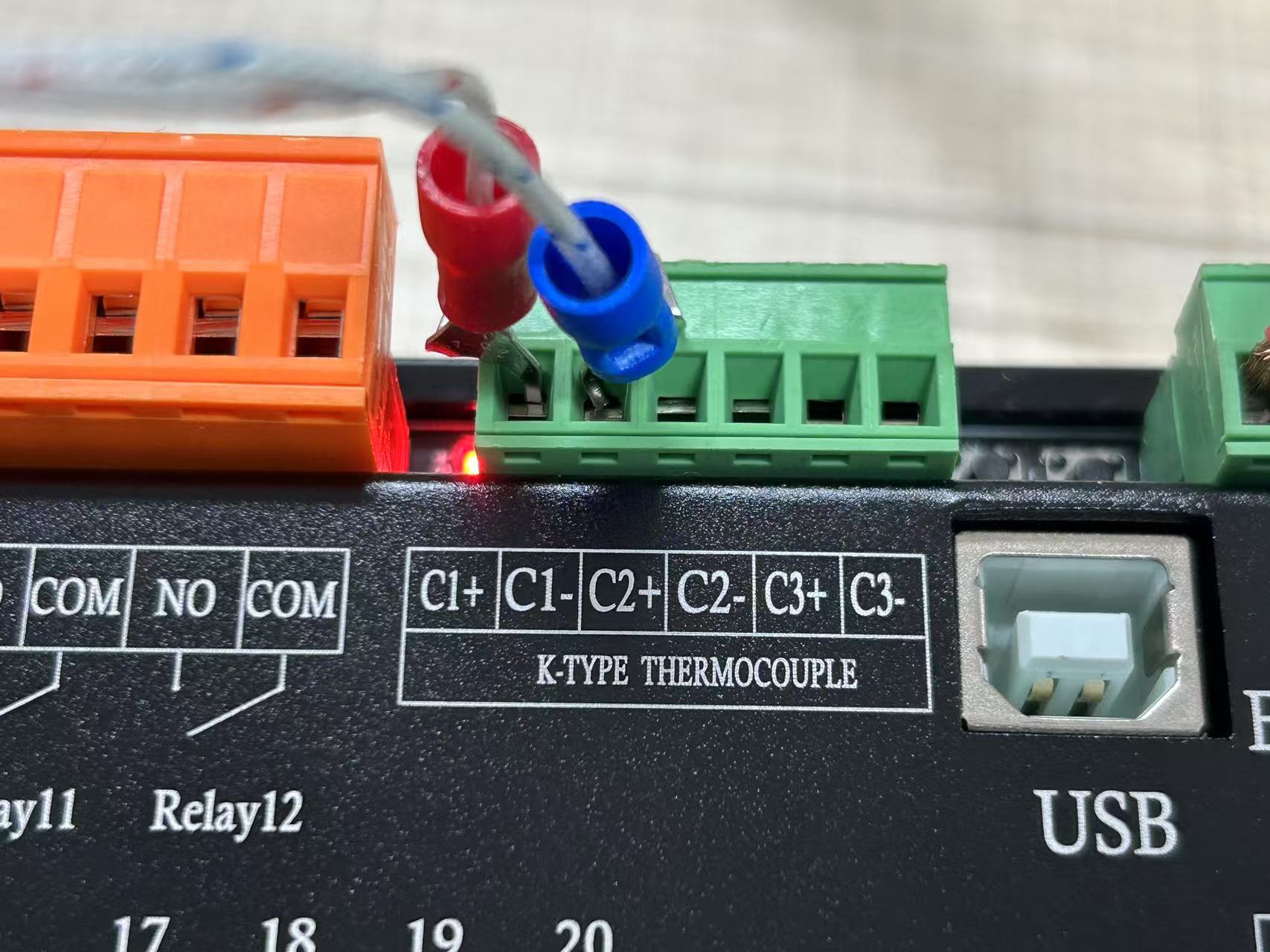

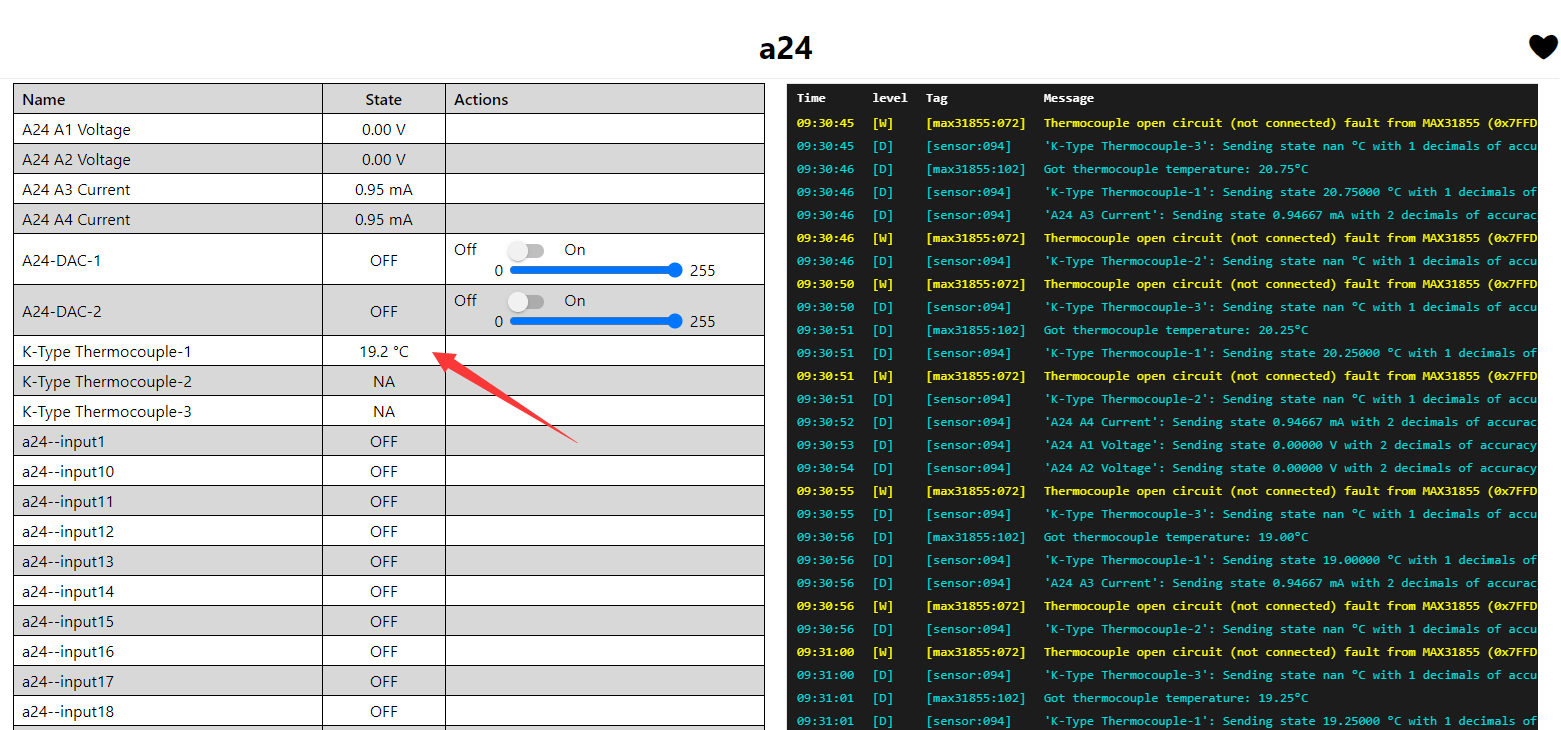

Full Version: A24 work with K-Type Thermocouple by web service
[attachment=6504]
[attachment=6505]
[attachment=6506]
