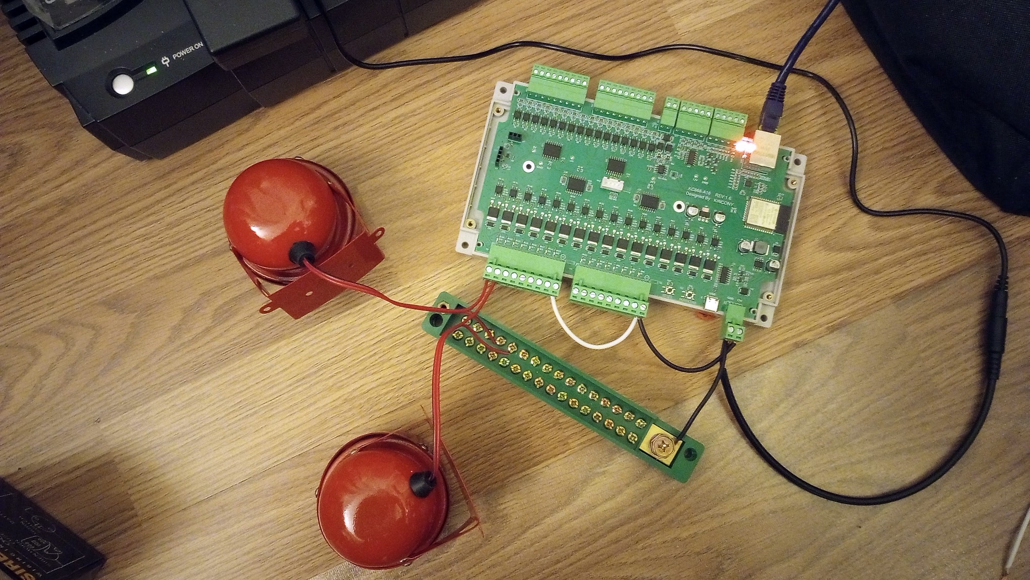

take a photo of your device. i want to see how you wire.
Sure, here is how I wired two sirens for testing purposes. I am using the junction terminal block seen here as an easy way to connect each of the negative siren wires to the same ground terminal of the power supply, since otherwise they would not all fit inside that terminal. The positive wires of the sirens are in output 15 and output 16.
[attachment=6600]
the WHITE color wire - Vin, you can connect with extend big power supply for your load. if you use multi power supply, just connect all GROUND together.
I'm sorry, I don't fully understand, do I need to purchase 2 additional separate power supplies, and connect one to each of the 8-output blocks (12V x 8 = 96 volts to each side)? I've already connected the ground wires of both siren devices together via the terminal block seen in the picture.
Or, would this be eaier/safer if I somehow connected a separate relay module board, or would I need a different device altogether, such as the KC868-A16S relay board?
I don't have very much experience working with electronics boards and the correct ways to connect and power devices; most of my prior experience is working with the software instead, i.e. Home Assistant, and wireless plug-and-play devices.  For this project, all I want is the ability to switch on/off multiple wired devices using Home Assistant, ensuring each device has enough power so that they can all be switched on at the same time.
your photo is right. the simplest way, just replace one DC12V power supply with large current version is ok.

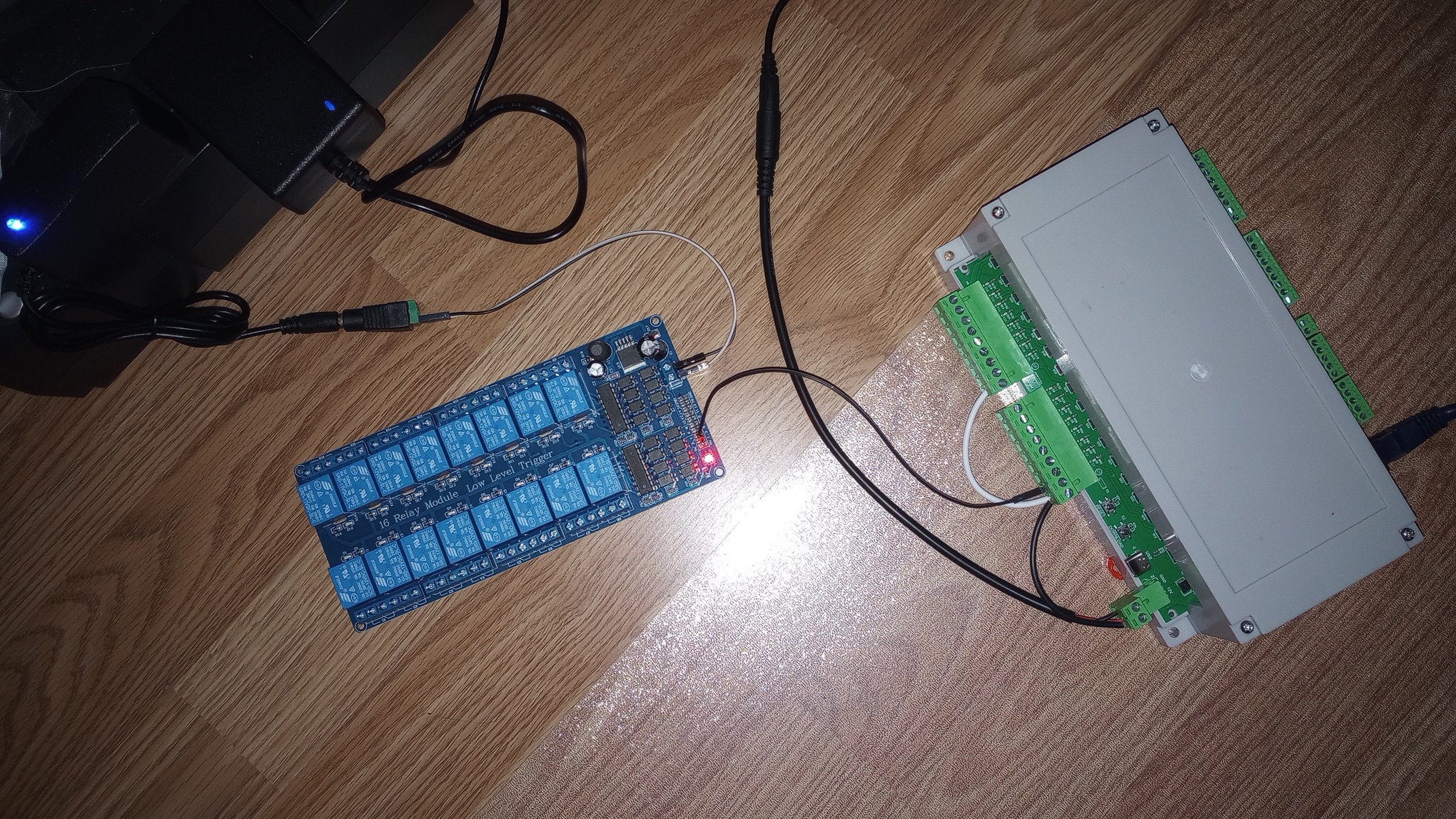

Instead of trying to connect a 96-volt power supply to each of the 8-channel outputs on the KC868-A16 board, I decided to order a 12V 16-channel relay module for arduino (An example of this board is seen here: https://www.desertcart.ae/products/11707...vr-pic-arm).
If I can get this setup working the way I'm hoping, each of the devices I connect to the relay module can be powered by its own separate 12V 3A power supply.
How can I use this relay module with the KC868-A16, such that the A16 outputs can control each of the respective relay switches?  Do I just need to connect each of the 16 outputs on the A16 to the 1-16 input pins on the relay module? And will the relay module need its own power supply, or will the A16 board be able to supply power to it somehow?
Instead of connecting a 96-volt power supply to each of the 8-channel outputs on the KC868-A16 board, I decided to order a 12V 16-channel relay module for arduino (An example of this board is seen in the attached picture).
KC868-A16 mosfet output 12v for extend relay. just use 12V 3A power supply for KC868-A16, not need add extend power supply.
Ok, I finally received the relay module and set it up as you can see in the picture.  I also attached a single cable from the KC868-A16 output 1 to the port 1 pin on the relay module, for testing.  That did not work to power the relay module (no LED light came on on the relay module), so I attached a separate 12V 1A power supply to the relay module which did cause the LED to turn on.
The problem I am having now, is that even though the relay module now has its own power, switching on the output 1 through the A16 does NOT turn on the relay 1 on the relay module like I want it to.  I have attached my wires as seen in the picture.  May you please let me know what I am doing wrong here? Thanks!
