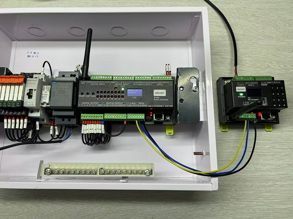

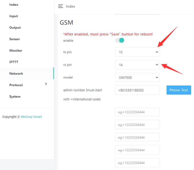

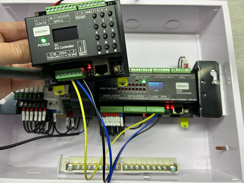

function: Use KinCony G1 module to transparently transmit AT commands of SIM7600 4G module to gpio13 and gpio14 of esp23-s3. So that KinCony Controller can connect with extend G1 4G module by KCS v3 firmware.
[attachment=6635]
[attachment=6636]
[attachment=6586]
