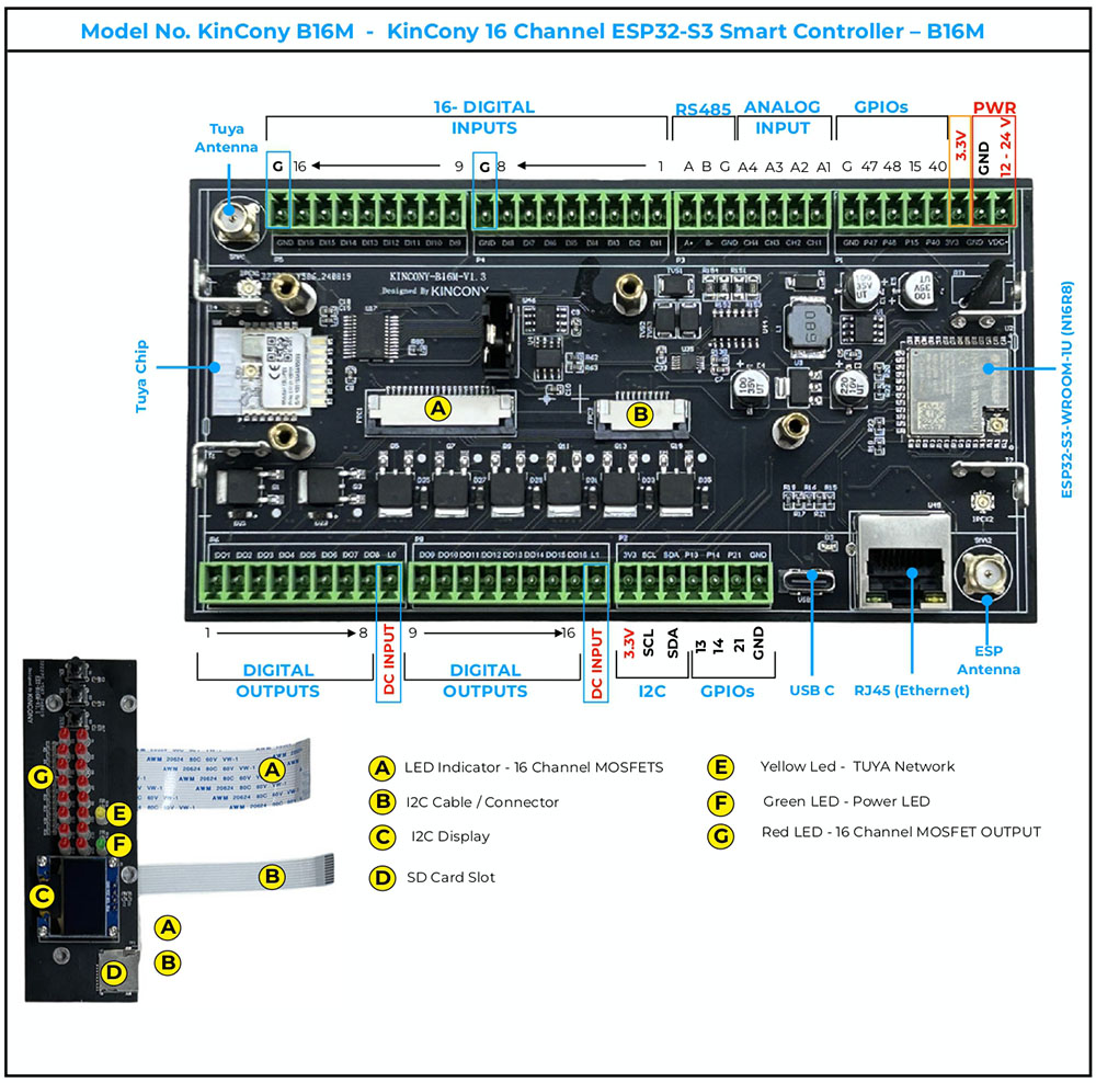

Understand, so then we Miss some Extensions Boards for i2c sensors, Analog Out. B16M would be great with such extras
Or maybe those extra GPIO could be programmed for those features ( i2c sensors, Analog Out )?
[attachment=6712]
In every Smart home / controlled Environment you need multiple sensors and based on that you control. So if I'm not mistaken currently Kincony boards do not have such option.
As my thinking is if i pick Kincony ESP32-S3 products, dont want to hassle with additional HW like arduino.
Loxone (act like Master) <-> F16 16CH ESP32-S3 (slave) -> I2C expander boards (act as sub-slave)
Would be awesome.
[attachment=6712]
Would be awesome.
