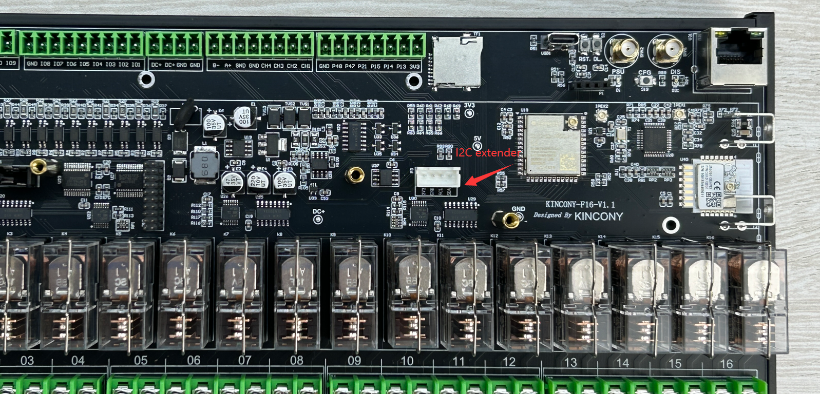

2. This is the I2C socket, as on some other board from Kincony (see pic)?
If so do you have some cable for that white port <--> with other side screw socket to connect multiple sensors or other I2C devices together?
2.1 Sensor you suggested it's fine but i have already multiple SHT31 on stock (pic attached)

2. here is the photo showed i2c extender on the F16 PCB. this i2c sensor SHT31 have used this white socket:
https://shop.kincony.com/products/sht30-...tion-cable
[attachment=6705]
now i2c bus only support one sensor. But in future, i think we will update firmware define another i2c bus by two free gpios on the GREEN terminal, so that not need open the BLACK box connect with i2c sensor.
