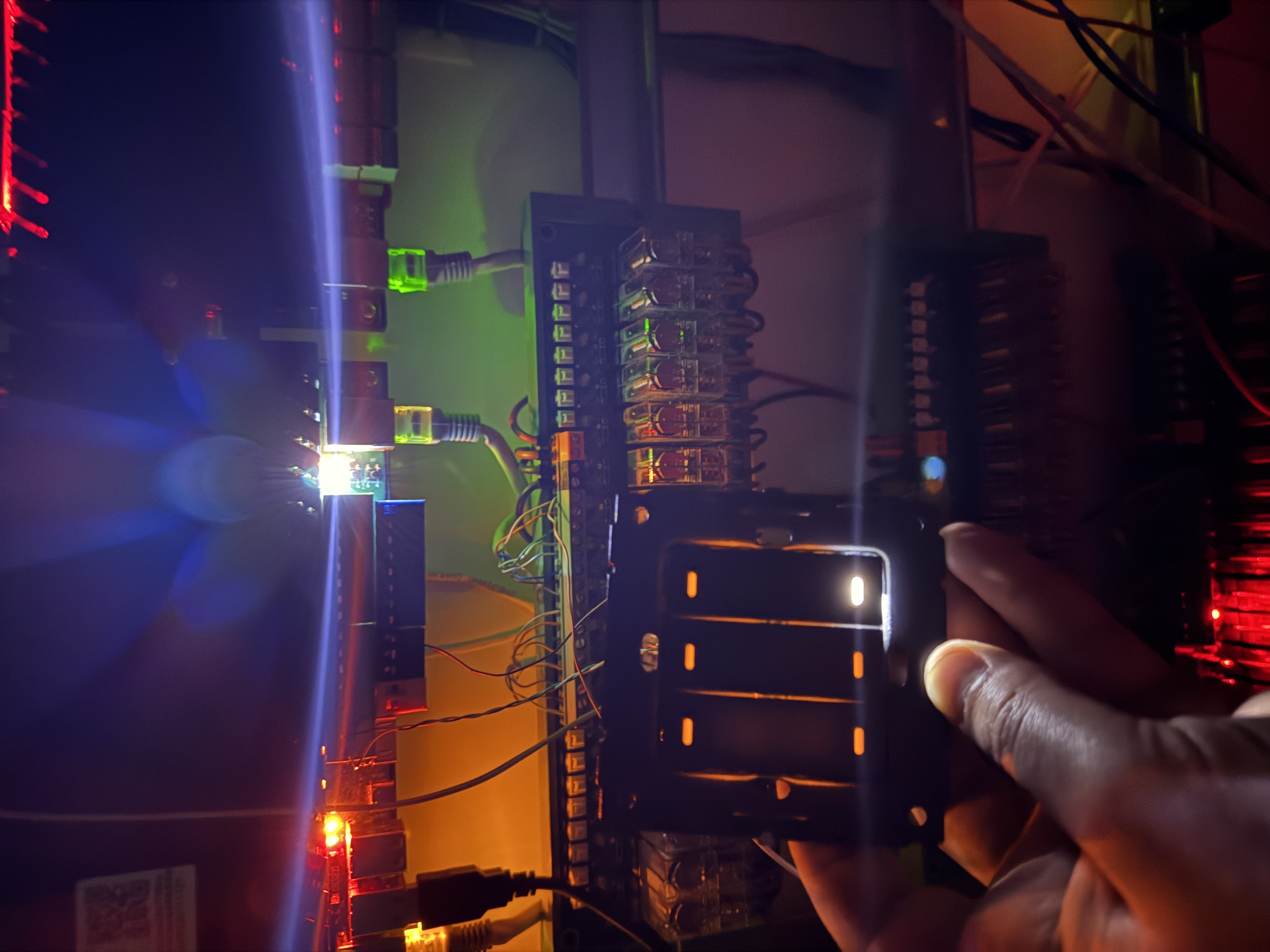

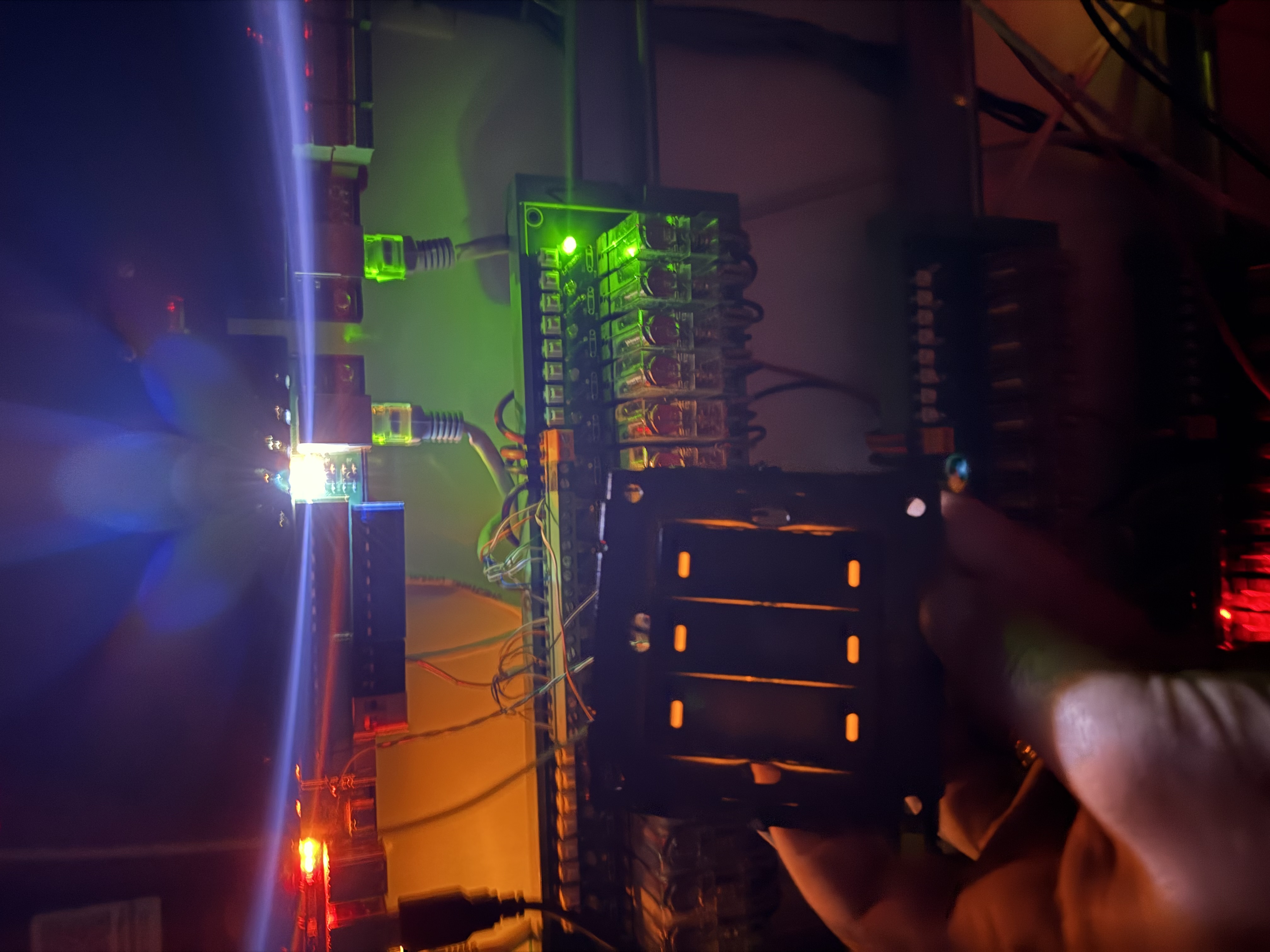

04-02-2025, 06:59 PM
[attachment=7350][attachment=7351]
Still not able to set.
I attached two pictures
When Relay is Off, LED D1 is ON
When Relay is ON, LED D1 is OFF
Looks like i need to invers somehow the signal.
Could you help?
Could you help?
04-02-2025, 10:20 PM
KC868-E16v2 relay's coin terminal connect to switch panel's "Dx". switch panel's COMMON connect to GND.
