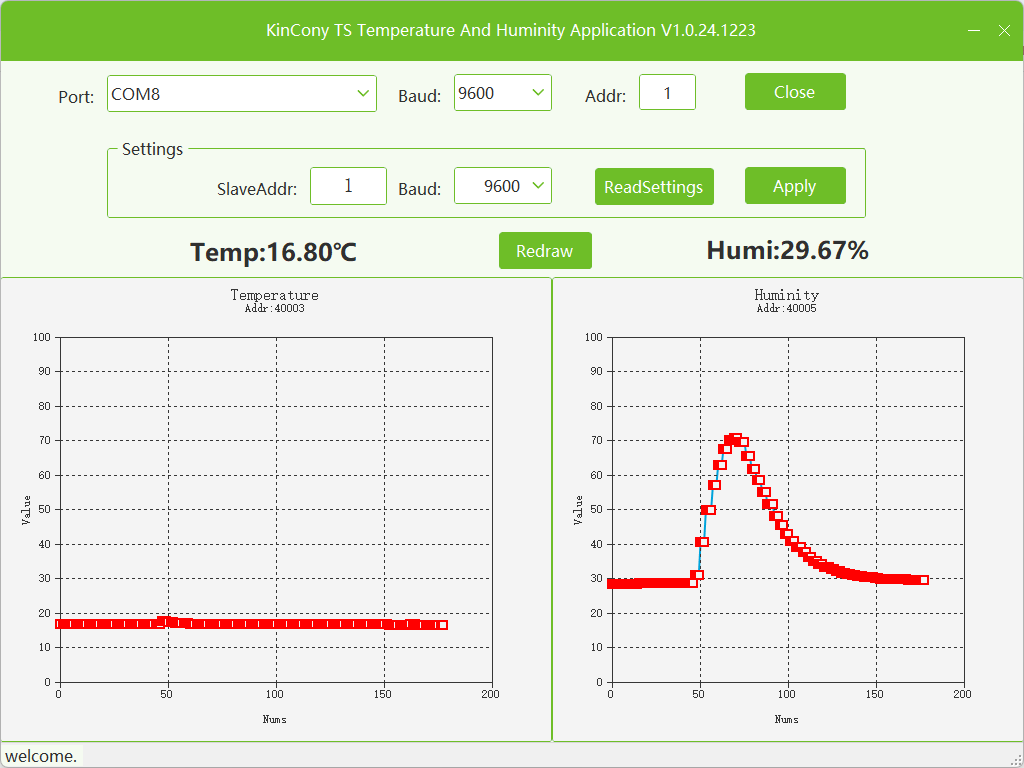

what problem now? can't read temperature value on "Monitor" webpage?
you can use USB-RS485 adapter to read the sensor data firstly, if the address is correct confirmed, then add to B16M set by KCS webpage.
![[Image: ts-pc-3.png]](https://www.kincony.com/images/TS/ts-pc-3.png)
here is details and pc software download link: https://www.kincony.com/tiny-sht30-tempe...ensor.html
