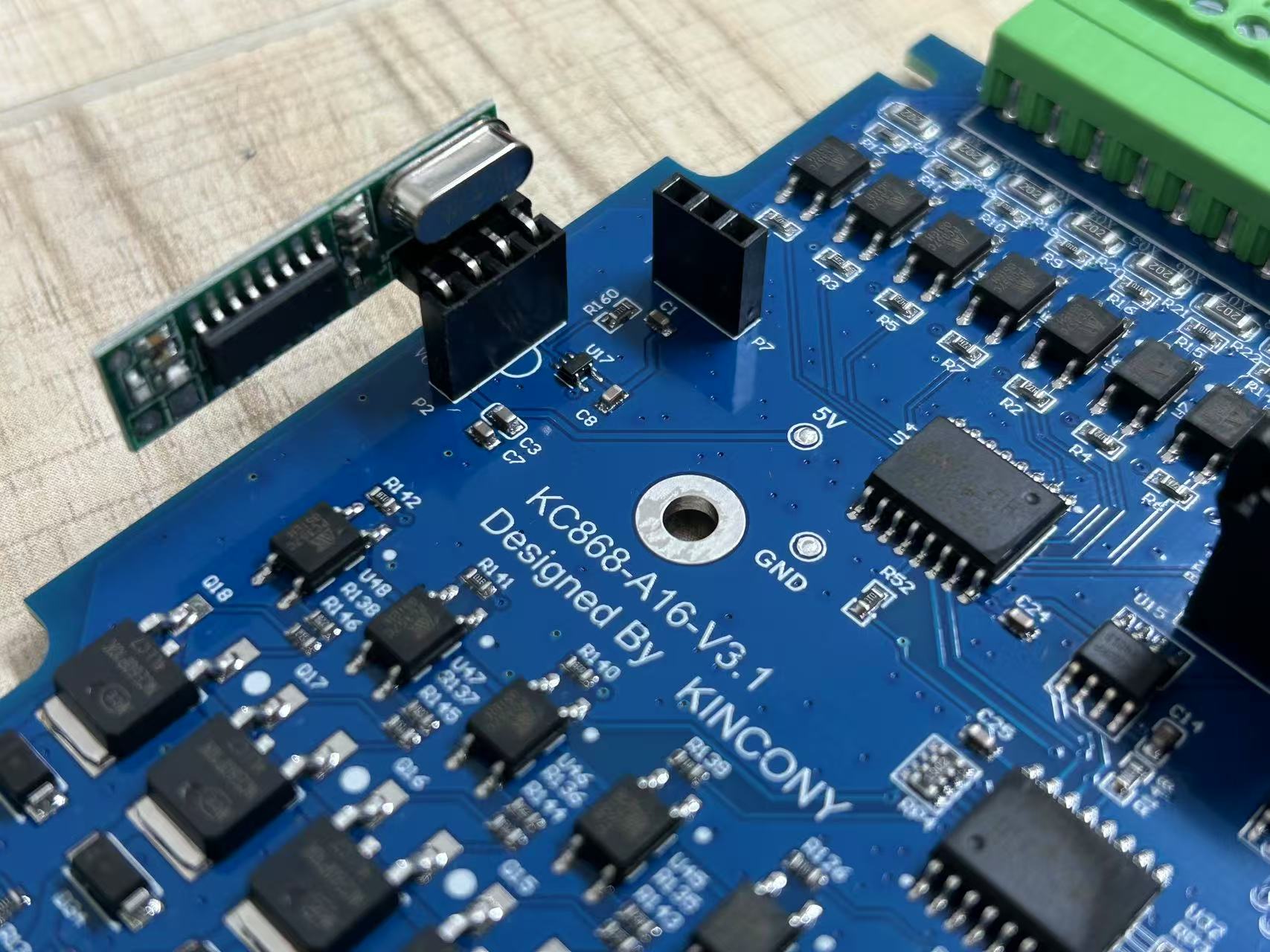

Please can you provide iguidence/nformation on configuring the RF 433mhz receiver/transmitter.
I have tried:
remote_transmitter:
  pin:
    number: GPIO18
  carrier_duty_percent: 100%
remote_receiver:
  pin:
    number: GPIO8
But that results in :
Remote Receiver:
[10:52:38][C][remote_receiver.esp32:065]:  Pin: GPIO8
[10:52:38][C][remote_receiver.esp32:070]:  Channel: 1
[10:52:38][C][remote_receiver.esp32:071]:  RMT memory blocks: 3
[10:52:38][C][remote_receiver.esp32:072]:  Clock divider: 80
[10:52:38][C][remote_receiver.esp32:074]:  Tolerance: 25%
[10:52:38][C][remote_receiver.esp32:075]:  Filter out pulses shorter than: 50 us
[10:52:38][C][remote_receiver.esp32:076]:  Signal is done after 10000 us of no changes
[10:52:38][E][remote_receiver.esp32:079]: Configuring RMT driver failed: ESP_ERR_INVALID_ARG (in rmt_config)
[10:52:38][E][component:082]:  Component remote_receiver is marked FAILED
If I change remote_receiver to :remote_receiver:
  pin:
    number: GPIO8
    inverted: true
  rmt_channel: 4
The error is gone. However the data received by the RF shown in the logs is different from the data received via a KC868-A16 logs for the same transmitting device (door sensor):
KC868-A16v3 RF Logs:
[11:01:52][I][remote.pronto:231]: Received Pronto: data=
[11:01:52][I][remote.pronto:233]: 0000 006D 0019 0000 000D 0027 000C 0027 000C 0027 0028 000B 0028 000B 000C 0027 000C 0027 000C 0027 000C 0027 0028 000B 0028 000B 000C 0027 0028 000B 0028 000B 0028 000B 000C 0027 000C 0027 000C 0027 000C 0027 000D 0027 0028 000B
[11:01:52][I][remote.pronto:233]: 0028 000B 0028 000B 000C 0027 000C 0181
KC868-A16RF Logs:
[11:04:50][I][remote.pronto:231]: Received Pronto: data=
[11:04:50][I][remote.pronto:233]: 0000 006D 0019 0000 000B 0029 000B 0029 000B 0028 0026 000D 0026 000D 000A 0029 000B 0029 000A 0029 000B 0028 0026 000D 0026 000D 000B 0028 0026 000D 0026 000D 0026 000D 000B 0029 000B 0028 000B 0028 000B 0028 000B 0028 0027 000D
[11:04:50][I][remote.pronto:233]: 0026 000D 0026 000D 000B 0029 000B 0181
[11:04:50][I][remote.rc_switch:261]: Received RCSwitch Raw: protocol=1 data='000110000110111000001110'
As you can see the remote.rc_switch data is missing in the V3 data??? Is this expected behaviour?
Is the config correct?
Many thanks
you can try to use my code to test:
remote_receiver:
  pin: 8
  rmt_channel: 4
  dump:
    - rc_switch
  tolerance: 50%
  filter: 250us
  idle: 2ms
  buffer_size: 32kB
[attachment=7247]
tested with A16v3 PCB:
[attachment=7248]
I have resolved the issue - I needed to clear build cache files, then re-flash. Then everything started to work as expected.
I suspect that because I have two boards (original version & V3) the existing cache files were conflicting...
Also the config yaml in the first post includes :
framework:
type: esp-idf
According to info here https://esphome.io/components/remote_receiver.html - the setting 'rmt_channel' is only supported in ESP32 Arduino configuration not ESP32-IDF config...
yes, it's ok.
The PCF8574 addresses for the input are swapped so XO1 is input9. The correct config is the following:
pcf8574:
    address: 0x24
    address: 0x25
    address: 0x22
    address: 0x21
I'm getting in the logs continuously the message: "E rmt: user buffer too small, received symbols truncated" when I use following yaml code
remote_receiver:
  pin: 8
  dump:
    - rc_switch
  tolerance: 50%
  filter: 250us
  idle: 2ms
  buffer_size: 32kB
Does someone know the solution please?
Thanks
if you use RF function, we suggest to use KCS v3 firmware. ESPHome not very well for RF.
