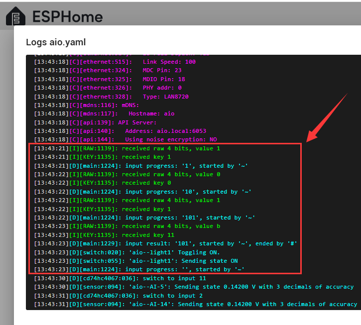

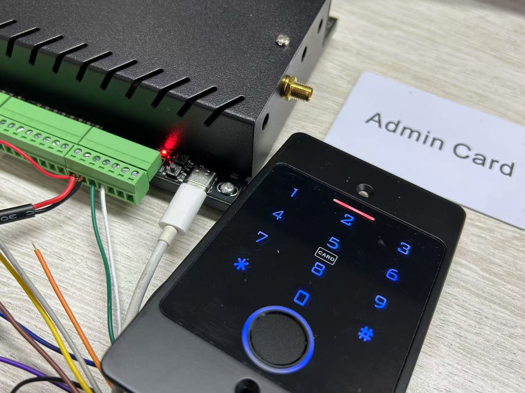

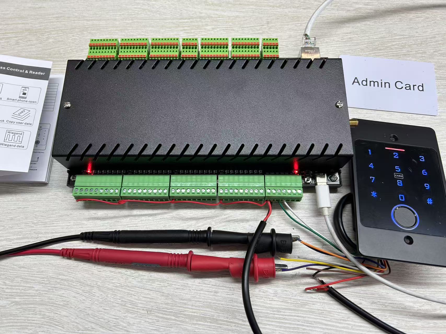

here is demo config file for access control panel. control OUTPUT1 or OUTPUT3 by INPUT NUMBER "101#" and "102#" by touch panel.
[attachment=7154]
[attachment=7152]
[attachment=7153]

wiegand:
  - id: mykeypad
    d0: GPIO14
    d1: GPIO5
    on_key:
      - lambda: ESP_LOGI("KEY", "received key %d", x);
    on_tag:
      - lambda: ESP_LOGI("TAG", "received tag %s", x.c_str());
    on_raw:
      - lambda: ESP_LOGI("RAW", "received raw %d bits, value %llx", bits, value);
# Example configuration entry
key_collector:
  - id: pincode_reader
    source_id: mykeypad
    min_length: 3
    max_length: 3
    end_keys: "#"
    end_key_required: true
    back_keys: "*"
    clear_keys: "C"
#    allowed_keys: "0123456789"
    timeout: 5s
    on_progress:
      - logger.log:
          format: "input progress: '%s', started by '%c'"
          args: [ 'x.c_str()', "(start == 0 ? '~' : start)" ]
    on_result:
      - logger.log:
          format: "input result: '%s', started by '%c', ended by '%c'"
          args: [ 'x.c_str()', "(start == 0 ? '~' : start)", "(end == 0 ? '~' : end)" ]
      - if:
          condition:
            lambda: |-
              return x=="101";
          then:
            switch.toggle: aio_light1
      - if:
          condition:
            lambda: |-
              return x=="102";
          then:
            switch.toggle: aio_light2
    on_timeout:
      - logger.log:
          format: "input timeout: '%s', started by '%c'"
