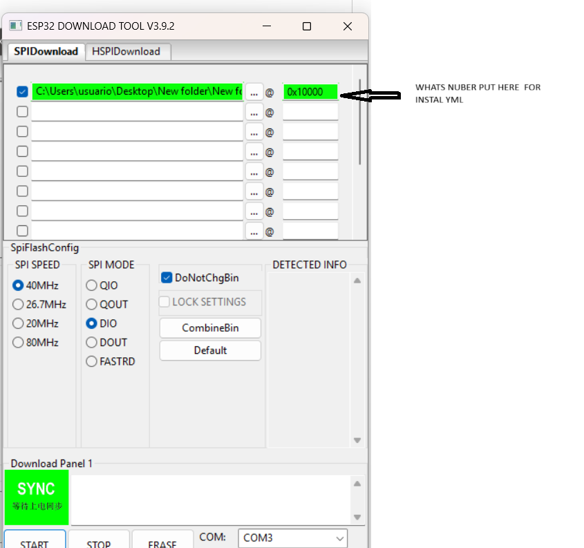

Hello, I would like to know the cost value , and I would like a video explaining how to change the input status to make it temporary using a contactor. I need this information. Thank you.
do you want digital input toggle relay output?
address should be 0x0
(12-01-2025, 02:33 AM)admin Wrote: [ -> ]address should be 0x0
After many attempts, I only got an error: I can't install the yml file.
I need the first 5 buttons to only be lit when a switch is activated. If you have a ready-made bin file that works on Tuya, it would help me.
my order about AliExpress  number 3061729049605348
thanks fernando
just modify esphome yaml file with 5 digital input ports with TOGGLE relay.
