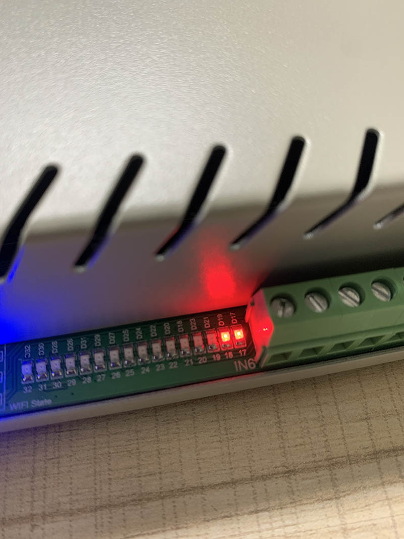

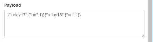

yes, support multi-output by one command. you payload should as this format:
{"relay17":{"on":0}}{"relay18":{"on":0}}
[attachment=327]
[attachment=328]
