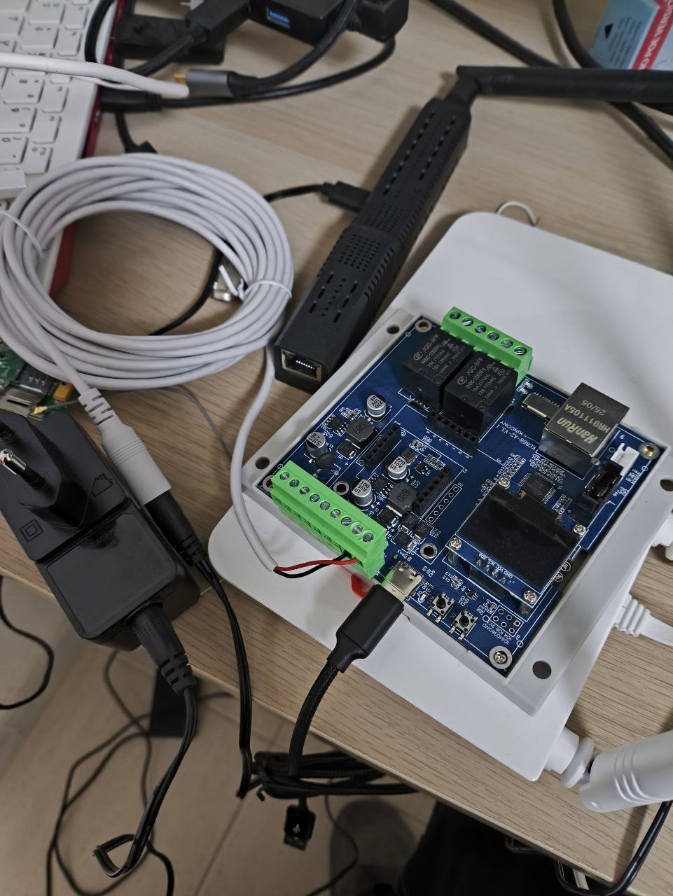

take a photo of your board, how you wire and what power supply you are using.
I'm powering it using a 12V 1A power supply.
Also tested with a 9V 1A before.
[attachment=7974][attachment=7975]
please change another power supply for testing. we usually use 12v 2A
now I also tested a 12V 2A power supply, but still same problem flashing KCS firmware.
