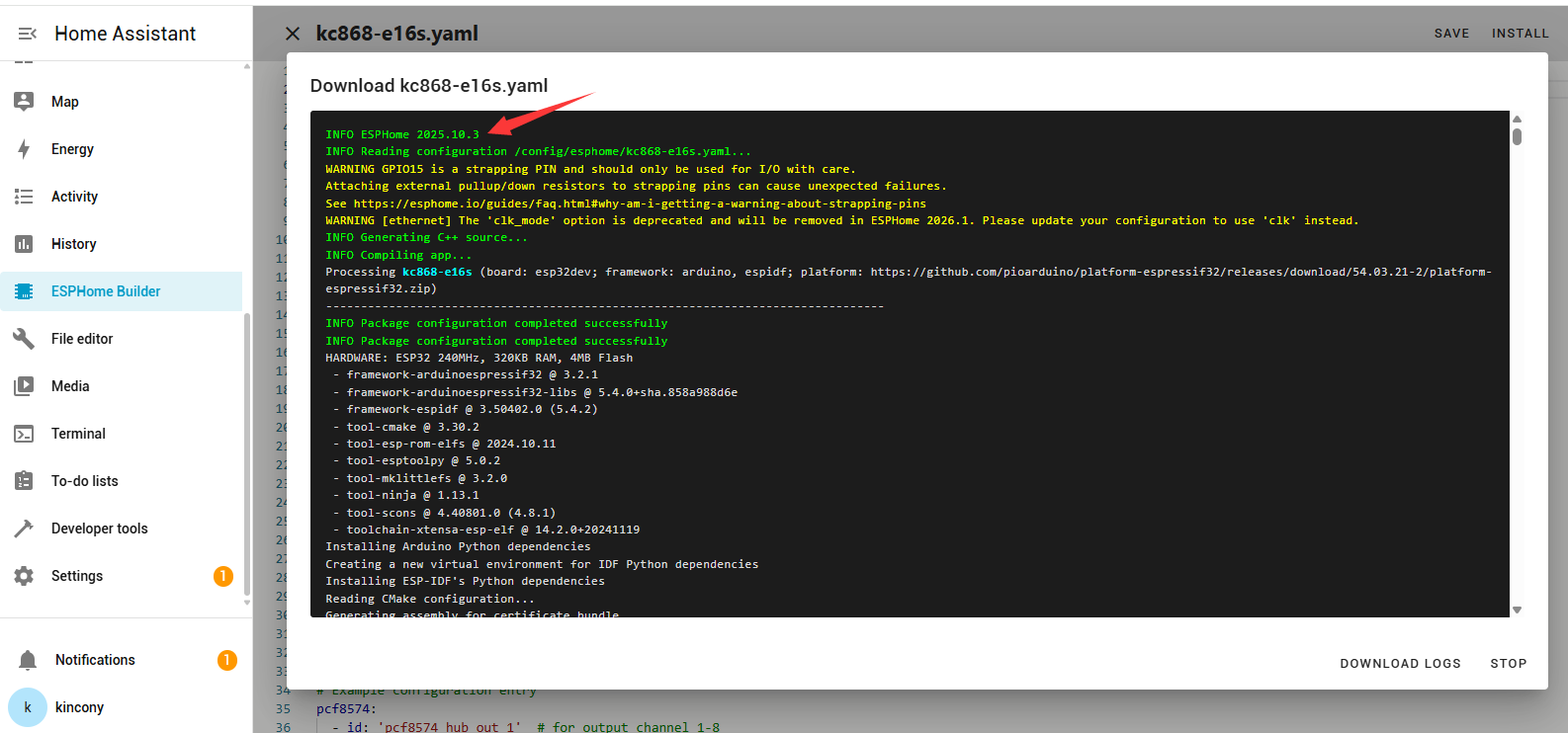

I want to update the ESPHome firmware of the KC868-E16S over OTA. Because of the Version-gap between ESPHome-Builder and the Frimware of the relay-module the integration doesn't work properly in HAOS.
Hardware: KC868-E16S
The Version of ESP Home Builder: 2025.10.1
The Version of the ESP Home Firmware 2023.12.9
I found out, that there are a lot of changes over the time, so I already made some changes in the original YAML-File (see attachet):
- adding on OTA: platform: esphome
- changed "dallas" to "one-wire"
but I could not make an OTA.
After trying to make an OTA I get the attachet message.
[attachment=8561]
Please help! What am I doing wrong? What am I missing? Could you please correct the YAML-file?!

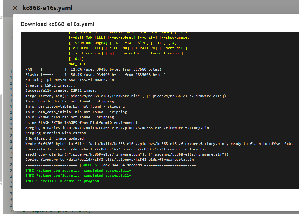

you can use this code, it have complied with newest esphome 2025.10.3
[attachment=8563]
[attachment=8564]
