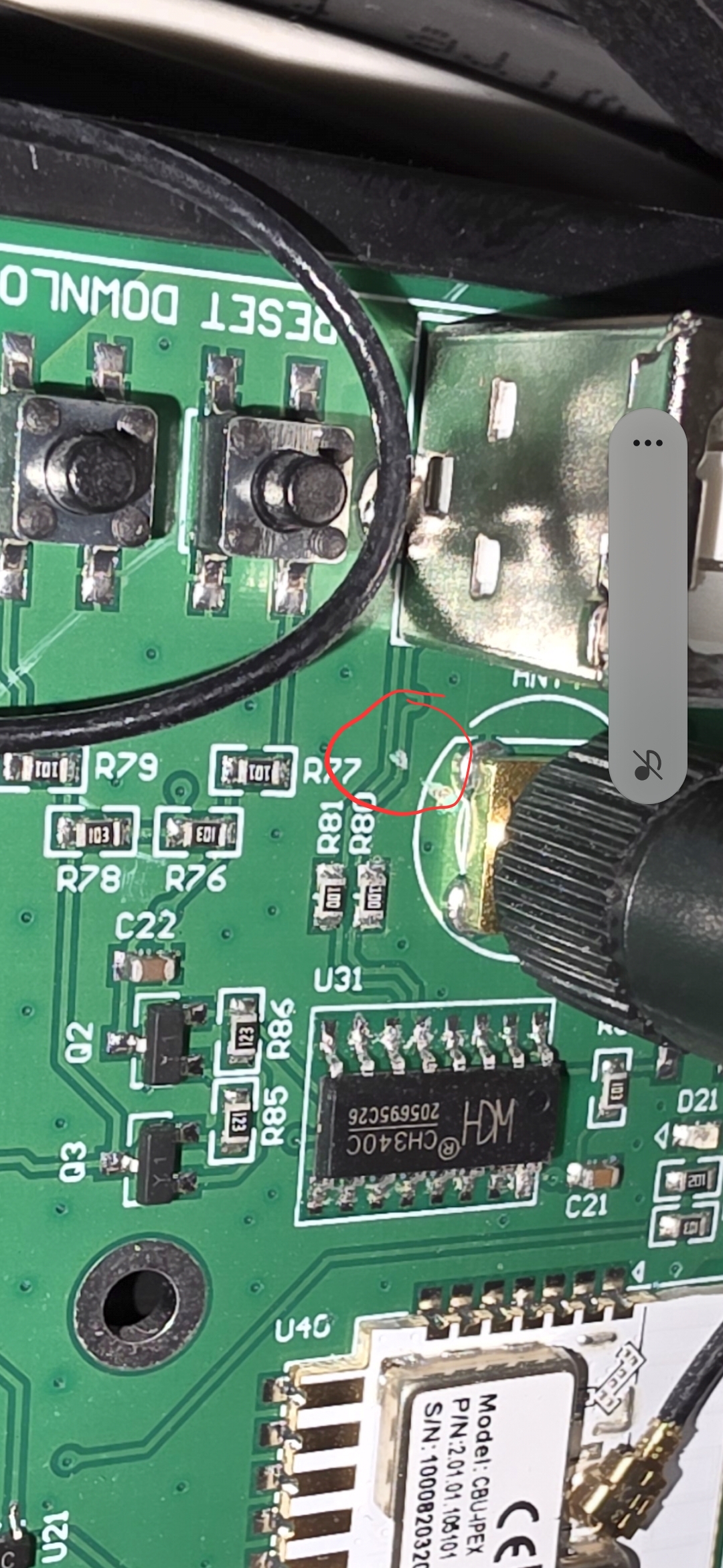

if really can't work, tell us your order number, we re send you a new E16T PCB without relay.
the fault has been found.the track on the board was broken. everything is fixed. e16t is working well
[attachment=9053]
sorry about it.
