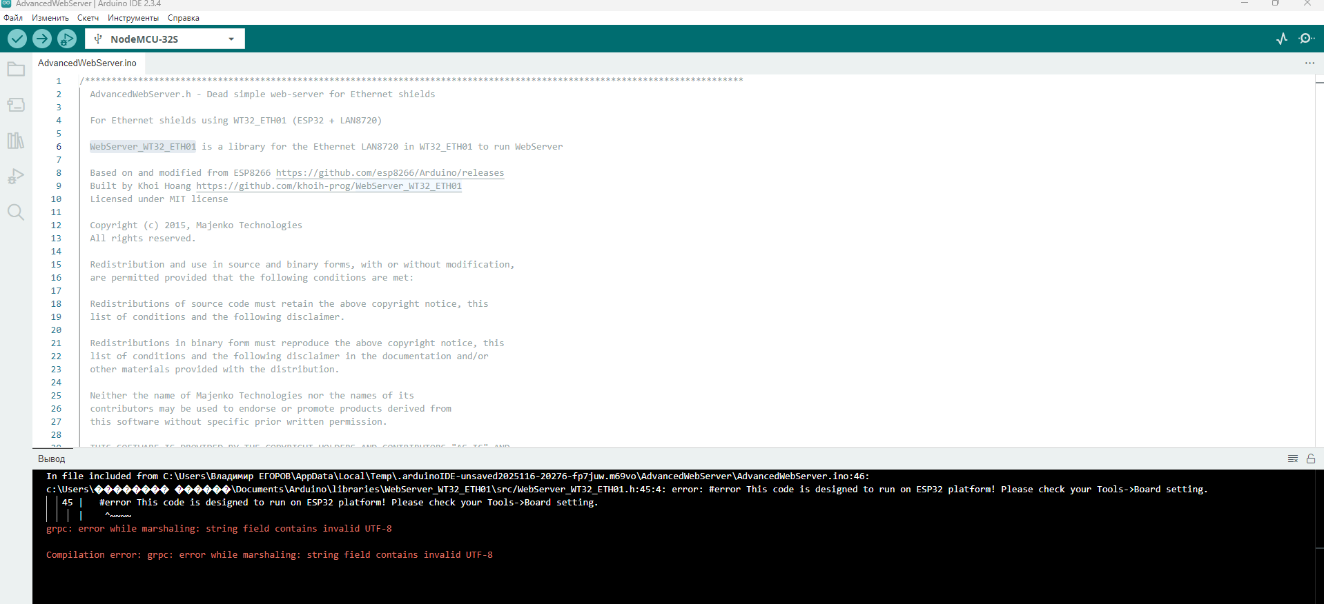

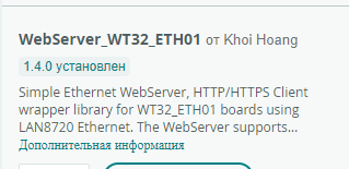

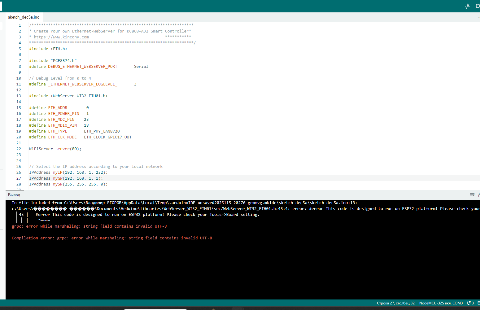

RE: [Arduino IDE demo source code for KC868-A16]--#11-KC868-A16_Ethernet_Web_server_code - egorov_v - 12-05-2025
Hello! Could you please advise me about the board? When I try to write this sketch, I get the following error during compilation.
I installed the latest version of the WebServer_WT32_ETH01.h and PCF8574.h libraries. Big Grin
RE: [Arduino IDE demo source code for KC868-A16]--#11-KC868-A16_Ethernet_Web_server_code - admin - 12-06-2025
do you have downloaded ZIP file and unzip source code to use?
RE: [Arduino IDE demo source code for KC868-A16]--#11-KC868-A16_Ethernet_Web_server_code - egorov_v - 12-06-2025
(12-06-2025, 01:05 AM)admin Wrote: do you have downloaded ZIP file and unzip source code to use?
Yes, that's right, but I downloaded the libraries from the Arduino library manager
When I tried to load the AdvancedWebServer example from the WebServer_WT32_ETH01 library onto the board, I got the same error
please check where have the invalid UTF-8 code.
