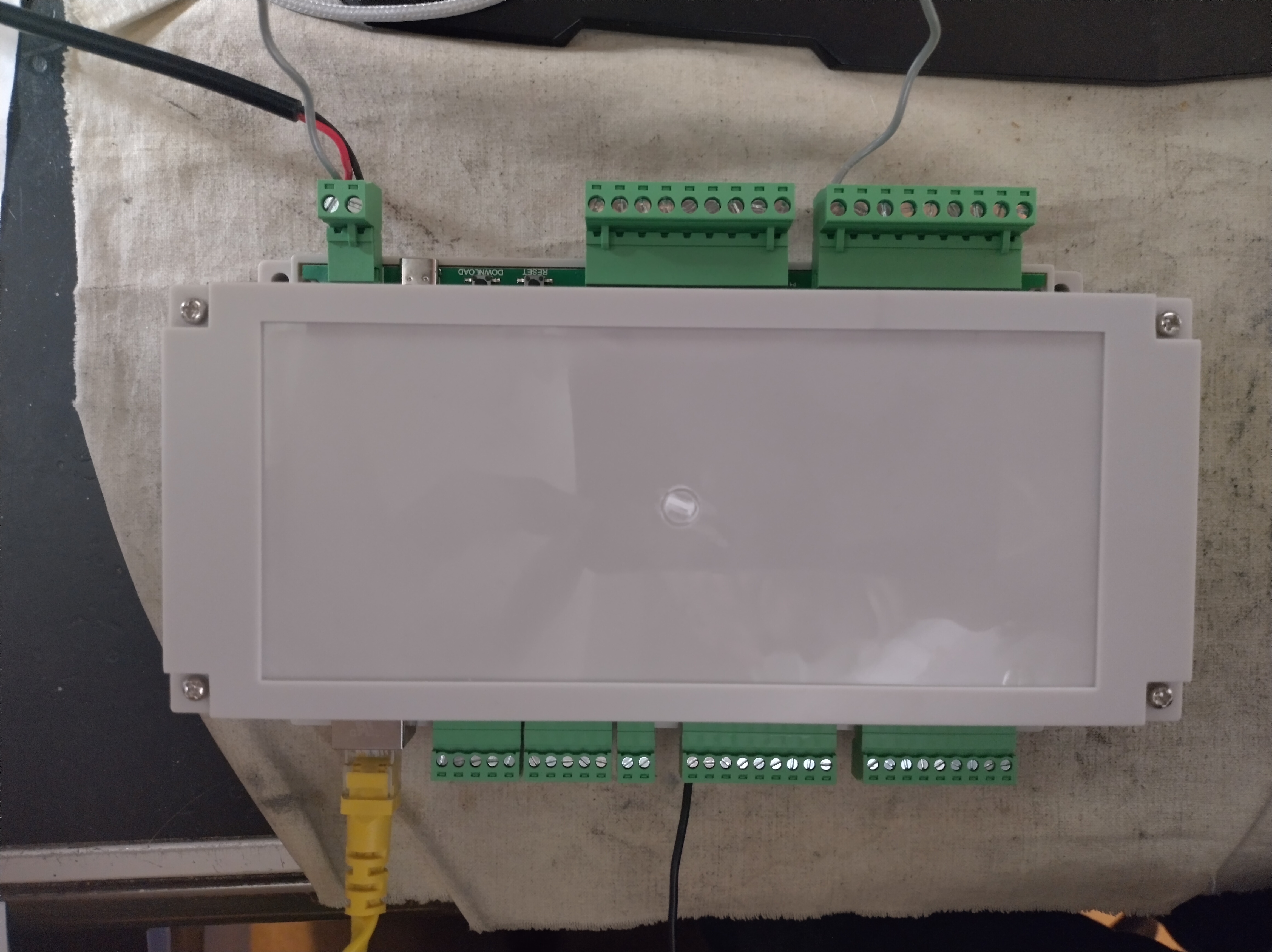

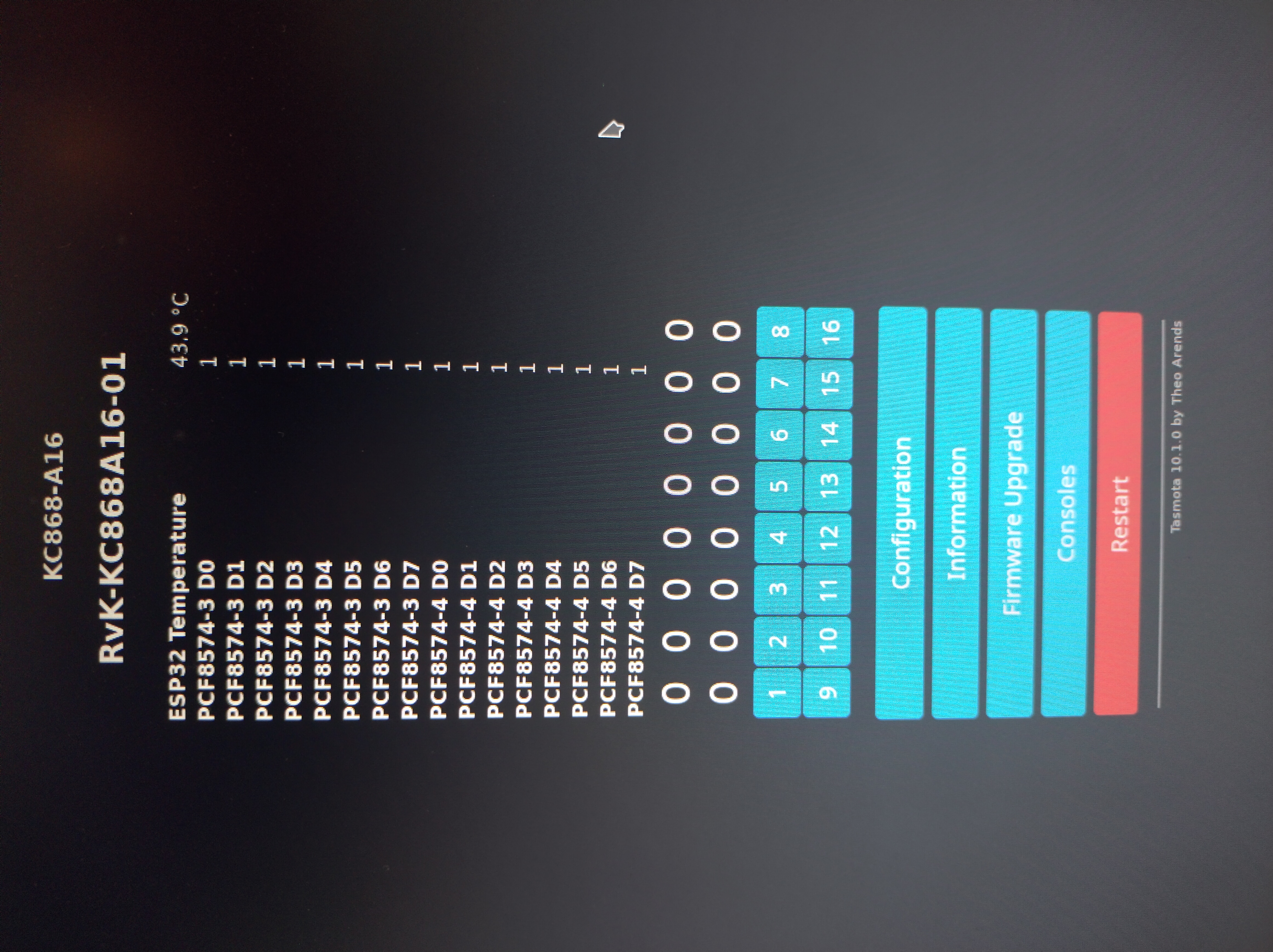

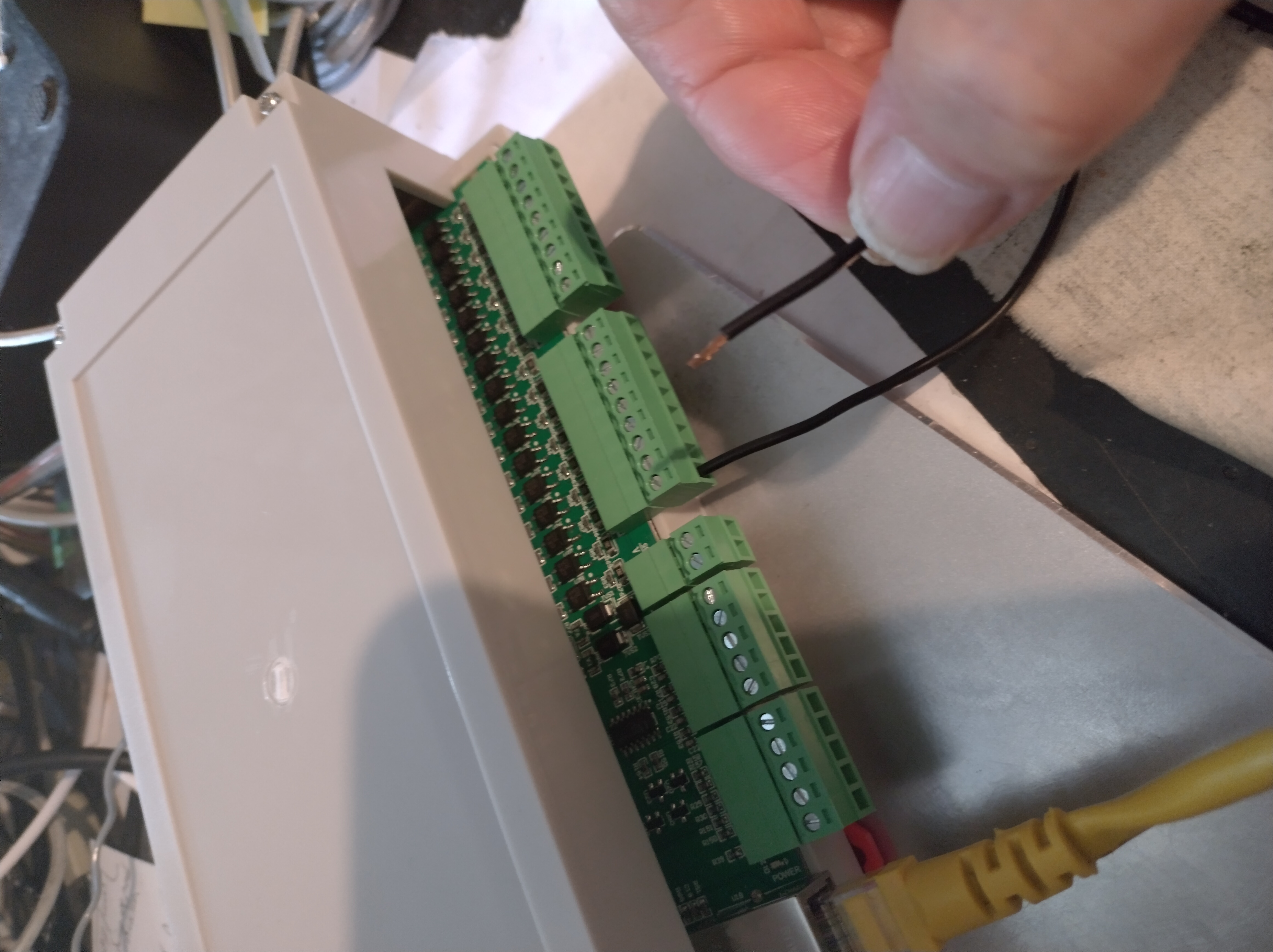

RE: Technical consultation connection KC868-A16 - RvK - 07-12-2024 RE: Technical consultation connection KC868-A16 - admin - 07-12-2024 take a whole photo, i need to see all terminal ports. RE: Technical consultation connection KC868-A16 - RvK - 07-12-2024 No connection on other side except power. RE: Technical consultation connection KC868-A16 - admin - 07-12-2024 so maybe that is problem, if you want output LED work, you should connect Vin terminal with DC12v power supply. i think you have not connected. that's why i need see photo. RE: Technical consultation connection KC868-A16 - RvK - 07-12-2024 I know but the software is not recognizing the input signal. Output 12V is connected to output common-block but also when I select the output in SW the output LED does not light up. [attachment=5565]photo uploaded? Usrr interface active on device. RE: Technical consultation connection KC868-A16 - admin - 07-12-2024 wire is OK, you can download KCS firmware to test digital input ports firstly. if KCS firmware work well, that means hardware PCB is ok. then check tasmota setting. RE: Technical consultation connection KC868-A16 - RvK - 07-12-2024 Ok I will do that. RE: Technical consultation connection KC868-A16 - RvK - 07-13-2024 Great that worked! Boards seems OK for input and outputs. I loaded Tasmota firmware but it is unclear to me what and how to configure it as nothing is working with that firmware .. . . . . . Any suggestions where I can find a procedure? RE: Technical consultation connection KC868-A16 - admin - 07-14-2024 just config digital input ports for PCF8574, make sure you downloaded firmware that enabled PCF8574 library. |
