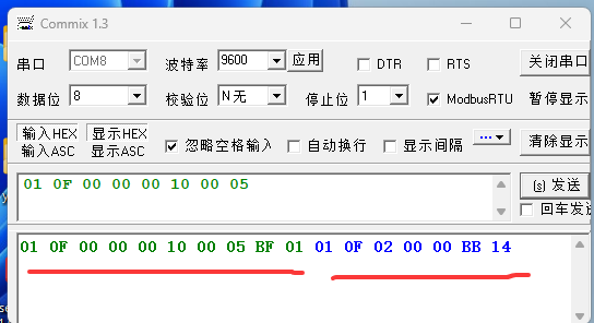

RE: Modbus CRC mistake - admin - 01-19-2025
for example, if you want turn ON output1,output3, others all off
send:01 0F 00 00 00 10 00 05 BF 01
receive:01 0F 02 00 00 BB 14
note about the "send" command:
01: address
0F: functon code
00 00: address 00 fixed
00 10: because KC868-A16 have 16 channel output, so it's 0x10
00 05: means OUTPUT1, OUTPUT3: ON, others: OFF
BF 01: CRC

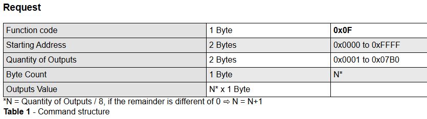

RE: Modbus CRC mistake - jltluc57 - 01-21-2025
Ok, it works for you.
but for me it is not the modbus standard, the "ByCout" byte is missing
I have been using my software for over 20 years and it works with all PLCs.
Here is an example with a Twido PLC
SLave :1
Cf : F
Adress : 0 0
Nb : 8
BYTE Count : 1
CRC : BE D5
RE: Modbus CRC mistake - admin - 01-21-2025
can you let your software output command remove "BYTE Count"? it MUST need included.
RE: Modbus CRC mistake - jltluc57 - 01-25-2025
Hello
By going outside the Modbus standard, without the Bycout, it works.
So I can't use this product with (CF15) on products that respect the standard like Schneider PLCs.
