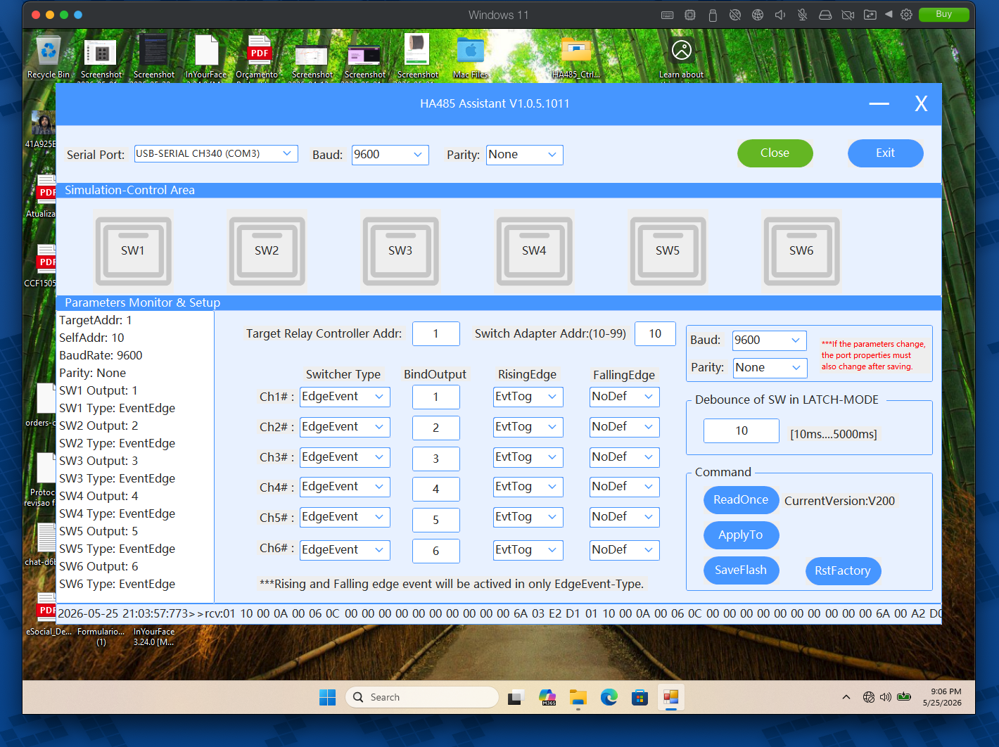

Is there a way to configure the module using MacOS?

do you means HAv2's PC software use on MAC OS?

(05-25-2026, 10:11 PM)admin Wrote: do you means HAv2's PC software use on MAC OS?
Yes, is there a way? I'm using a Windows virtual machine, but it's paid software:
ALSO, How do I debug the RS485 connection to my E16S using ESPHome?
MY HAV2 board works ok with PC software, but doesn't work in ESPHome

if you download KCS firmware, you can use HAv2 directly. just set RS485 protocol = RTU-HA
if you want config by ESPHome, you can see these video tour:
https://youtu.be/s5Htc43HqAc
https://youtu.be/S679QX6Hc6I
