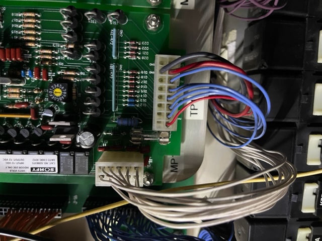

KC868-32BS -ve/ground output - udayansarma - 03-03-2022 I've about 15 shades operated by 12vdc board. Please take a look at the attached photo. The blue wires are the triggers for the different electric motors for the shades. When I connect the blue wires with 12VDC ground(-ve), the shade operates. Is there a way to configure the H32BS to output ground/-ve 12vdc? Thanks much RE: KC868-32BS -ve/ground output - admin - 03-03-2022 when connect with GND or -12V will work? 0v or -12v? RE: KC868-32BS -ve/ground output - udayansarma - 03-03-2022 (03-03-2022, 12:17 AM)admin Wrote: when connect with GND or -12V will work? 0v or -12v? Ground, this is completely 12vDC no AC at all. By -ve I was referring to ground (or floating ground), please look at the attached diagram RE: KC868-32BS -ve/ground output - admin - 03-03-2022 H32BS' MOSFET is output high level, if you want to output low level. you can let H32BS connect to KC868-E16, E16 relay's COM connect with Ground. when Turn ON relay, then output 0V. RE: KC868-32BS -ve/ground output - udayansarma - 03-03-2022 (03-03-2022, 12:23 AM)admin Wrote: H32BS' MOSFET is output high level, if you want to output low level. you can let H32BS connect to KC868-E16, E16 relay's COM connect with Ground. when Turn ON relay, then output 0V. Got it. Thanks (03-03-2022, 12:31 AM)udayansarma Wrote:(03-03-2022, 12:23 AM)admin Wrote: H32BS' MOSFET is output high level, if you want to output low level. you can let H32BS connect to KC868-E16, E16 relay's COM connect with Ground. when Turn ON relay, then output 0V. Tried it with E16 relays and it all worked. Thanks much |
