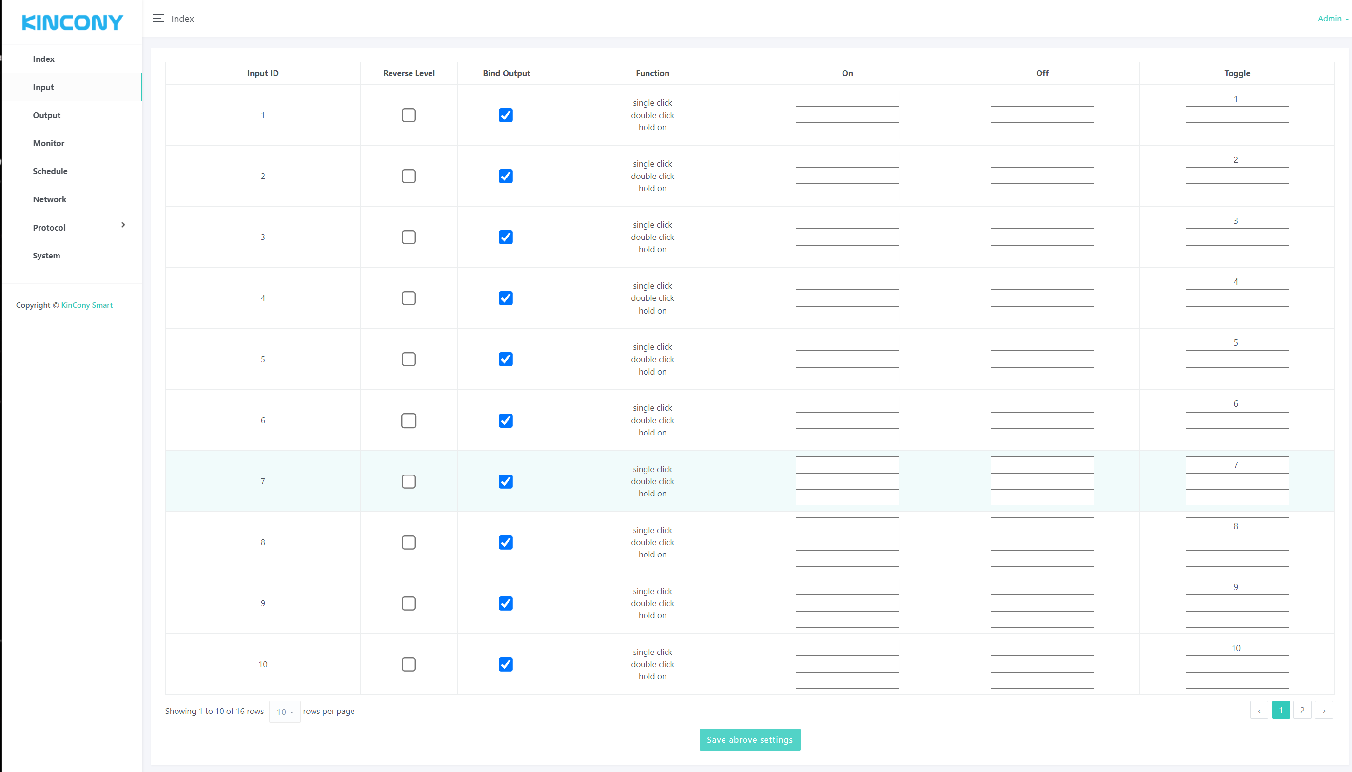

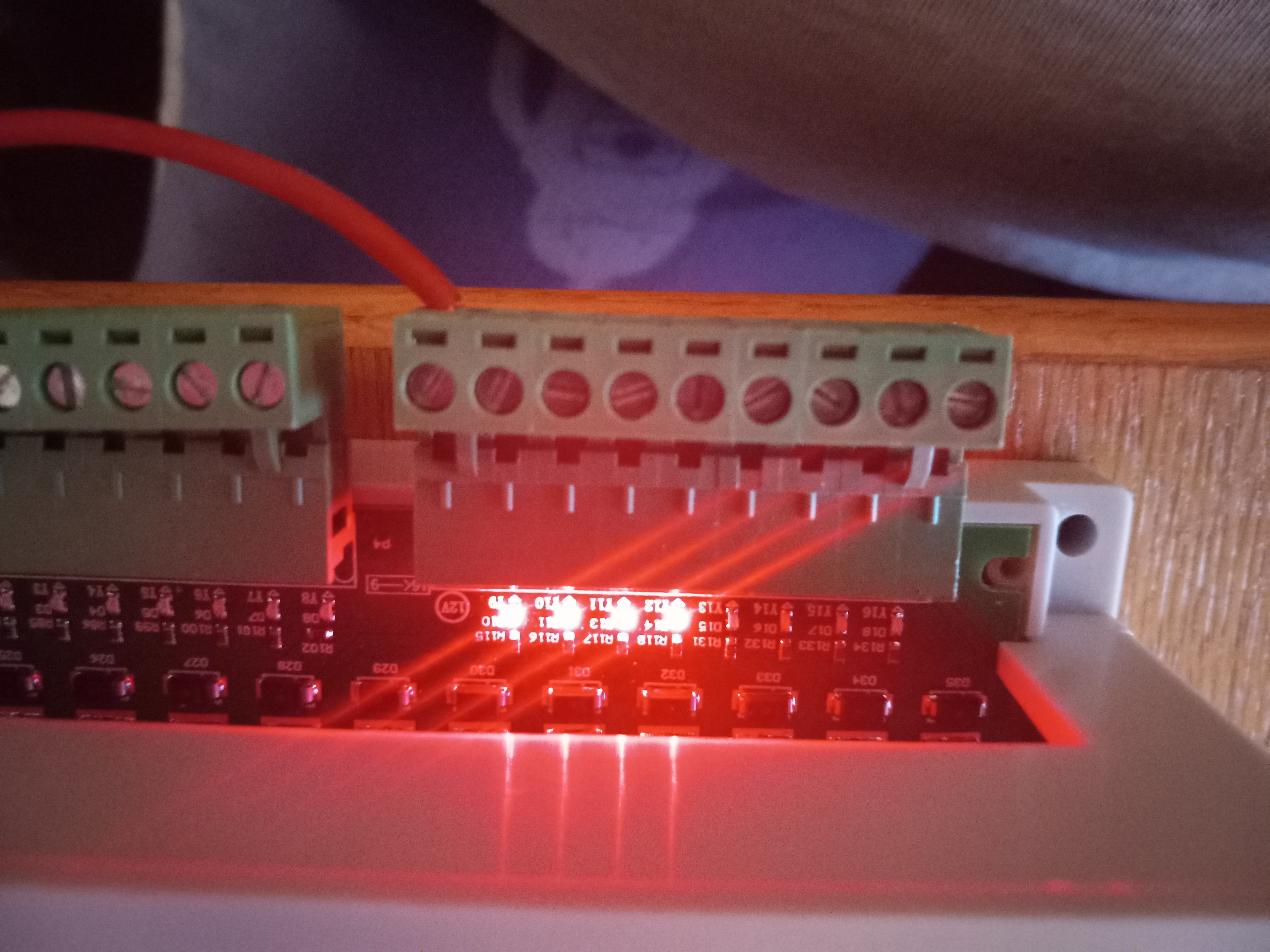

Strange Behavior - Philadam - 03-13-2023 I have a 4 gang momentary switch connected to input positions 1-4 and GND on my A16. When I push the buttons I would expect outputs 1-4 to be triggered, instead outputs 9-12 are triggered. Plus, if I push the buttons fast, the A16 seems to get confused and the outputs either freeze or aren't triggered. I have the latest KCS firmware installed v1.0.15. Any ideas on why this is happening. I have attached pictures. RE: Strange Behavior - admin - 03-14-2023 ok, we will update this issue. later send you new firmware. RE: Strange Behavior - Philadam - 03-14-2023 Thanks RE: Strange Behavior - admin - 03-14-2023 firmware updated v1.0.19, sloved your problem. you can download at here: https://www.kincony.com/forum/showthread.php?tid=2686 RE: Strange Behavior - Philadam - 03-15-2023 Thanks, it works now. Is there a way to save firmware settings so they can be easily applied after a firmware update? Also, in your next firmware release you my want to change "Save abrove settings" to "Save above settings". RE: Strange Behavior - admin - 03-15-2023 thanks for your suggestion. |
