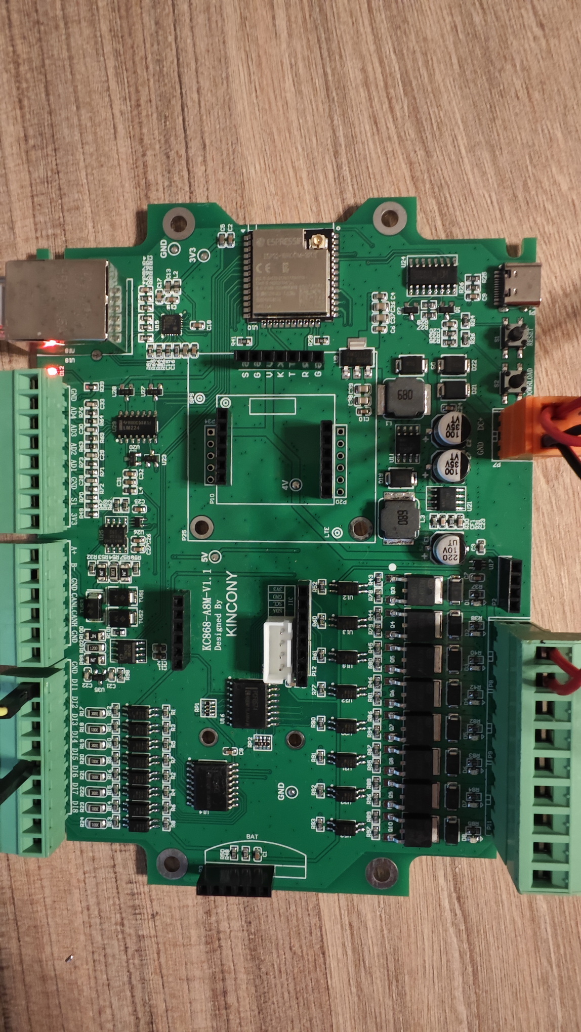

RE: KC868-A8M and PCF857x error - admin - 09-17-2023
take a photo of board, i want to see how you wire.
RE: KC868-A8M and PCF857x error - Madjo - 09-18-2023
The output is not triggered. By input, the values are either at the first input or at the second in random order. There is no reaction to short circuits
