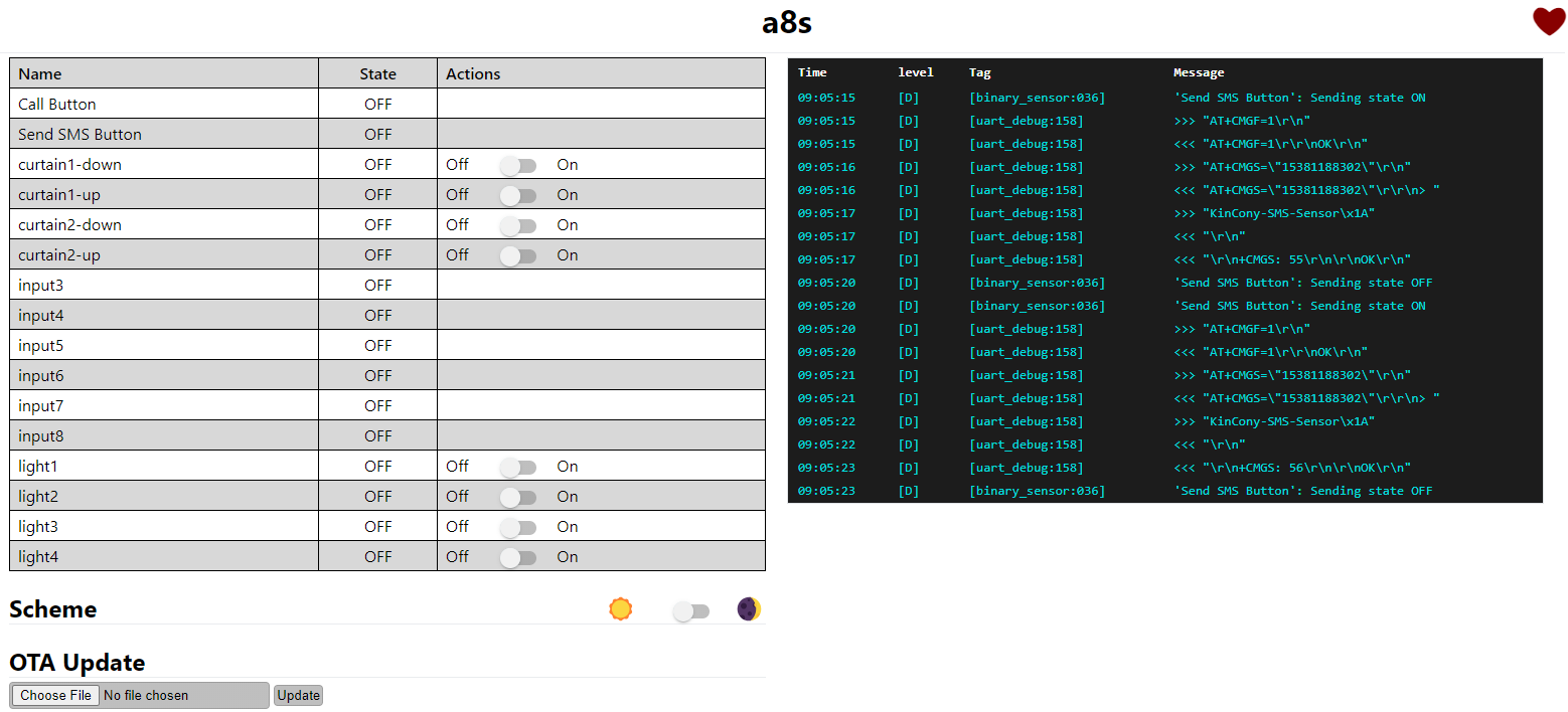

how to use binary sensor send SMS by SIM7600E 4G module in ESPHome - admin - 08-28-2024
the ESPHome yaml demo made for KinCony KC868-A8S relay board. Actually you can use for any KinCony SIM7600 relay board, just replace 4G module's TXD,RXD define.
here is ESPHome yaml demo:

# UART configuration for SIM7600E
uart:
  tx_pin: GPIO13
  rx_pin: GPIO15
  baud_rate: 115200
  debug:
    direction: BOTH
    dummy_receiver: true
    after:
      timeout: 10ms
    sequence:
      - lambda: UARTDebug::log_string(direction, bytes);
binary_sensor:
  - platform: gpio
    on_press:
      then:
        - uart.write:
            data: "ATD15381188302;\r\n"  # Replace with the phone number you want to dial
    pin:
      pcf8574: pcf8574_hub_in_1
      number: 0
      mode: INPUT
      inverted: true
  - platform: gpio
    name: "Send SMS Button"
    on_press:
      then:
        - uart.write:
            data: "AT+CMGF=1\r\n"  # Set SMS to text mode
        - delay: 1s
        - uart.write:
            data: "AT+CMGS=\"15381188302\"\r\n"  # Replace with the recipient's phone number
        - delay: 1s
        - uart.write:
            data: "KinCony-SMS-Sensor\x1A"  # Send the message "KinCony-SMS-Sensor" and terminate with Ctrl+Z
    pin:
      number: 1
      mode: INPUT
      inverted: true

download yaml file:
.txt   KC868-A8S-HA-INPUT-SIM7600-SMS.txt (Size: 4.45 KB / Downloads: 662)
