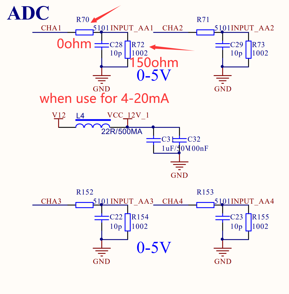

Inputs on KC868-A16. What is correct? - Brouk - 08-30-2024 I purchased KC868-A16 from you via Aliexpress ( Order ID: 3034630932938839). As the menu/specification table says (see the attached image), the device should have: > 16 digital input LOG1 = +8 to 12VDC > and 2 analog inputs 4-20mA. But > the device does not have digital inputs working with a positive signal, i.e. PNP. So I have to buy logic signal converters :o( . > and even (now I found out on your site https://www.kincony.com/esp32-board-16-channel-relay-hardware.html ) that there are no analog current inputs. Is that so? Do you have inaccurate information when selling? What is the truth? Regards RE: Inputs on KC868-A16. What is correct? - admin - 08-30-2024 1. you don't buy from KinCony's Official store, we don't have your order number. 2. digital input: when digital input =0v, just short with GND, means trigger. when digital input =8-12v, means NOT trigger. digital input mainly use for dry contact signal. 3. KC868-A16 have 4 channel analog input ports. actually the circuit is same, if use for VOLTAGE or CURRENT, just replace two resistance for SWITCH. for example, if you want CHA1 use for 4-20mA, you can replace R70 resistance with 0ohm, R72 resistance with 150ohm. every analog input channel switch as the same way. so if you want 4 channel of 4-20mA, just replace with all resistance. RE: Inputs on KC868-A16. What is correct? - fproof88 - 11-28-2024 Do you have a drawing showing both the input options? Trigger = 0vdc Not trigger = 8vdc-24vdc I'm having a hard time understanding how to wire the inputs pnp. RE: Inputs on KC868-A16. What is correct? - admin - 11-28-2024 you can use dry contact with digital input. if SHORT digital input port with GND = logical "1" . if input DC 12v or 24V = logical "0" RE: Inputs on KC868-A16. What is correct? - fproof88 - 11-29-2024 I do not get what that means can you show it in a picture please. If I wanted to connect a switch how would I connect the wires? 24vdc to one side of the switch and input 1 to the other side? RE: Inputs on KC868-A16. What is correct? - admin - 11-29-2024 if you switch output 24V DC. 24V signal wire connect to digital input1, another GROUND wire conenct to GND. RE: Inputs on KC868-A16. What is correct? - fproof88 - 11-29-2024 24vdc---------switch---------Input 1 GND ‐-‐---------------------------GND What do you mean by switch output 24vdc? RE: Inputs on KC868-A16. What is correct? - fproof88 - 11-29-2024 (11-29-2024, 03:19 AM)fproof88 Wrote: 24vdc---------switch---------Input 1Which one is true for 24vdc input? ################################################################ Input1 ### - platform: gpio name: "HotTub_I1" pin: pcf8574: pcf8574_hub_in_1 # Use pin number 0 number: 0 # One of INPUT or OUTPUT mode: INPUT inverted: true ################################################################# Input2 ### - platform: gpio name: "HotTub_I2" pin: pcf8574: pcf8574_hub_in_1 # Use pin number 0 number: 1 # One of INPUT or OUTPUT mode: INPUT inverted: false RE: Inputs on KC868-A16. What is correct? - admin - 11-29-2024 can you draw a diagram on paper, take a photo. RE: Inputs on KC868-A16. What is correct? - fproof88 - 11-29-2024 (11-29-2024, 11:19 AM)admin Wrote: can you draw a diagram on paper, take a photo. |
