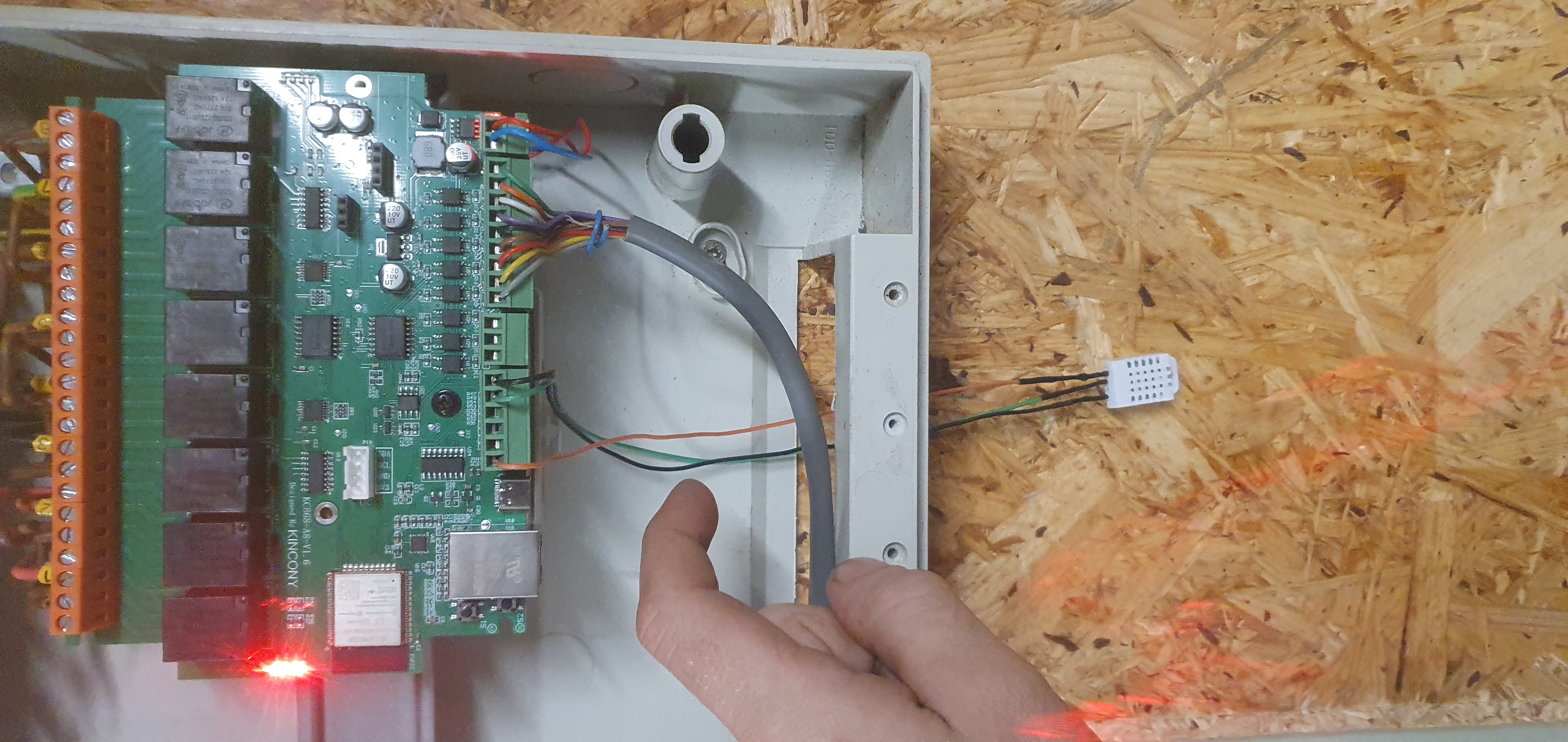

Now i want to add dht22 , but i´m not sure of the wering.
I added pic .
Also the iic poort , i have a small monitor , can i just plug it ? Or is this for diffrent project where you do coding your self ?
Tnx
RE: Kc868 a8 in workshop - admin - 12-25-2024
1. connect with DHT22 sensor, but DHT22 need useby 5v VCC, not 3.3v. you can connect to RF receiver or RF sender module's socket pin, there is 5V pin.
2. config sensor in KCS webpage, then will be work well.
RE: Kc868 a8 in workshop - Verresen - 12-26-2024
