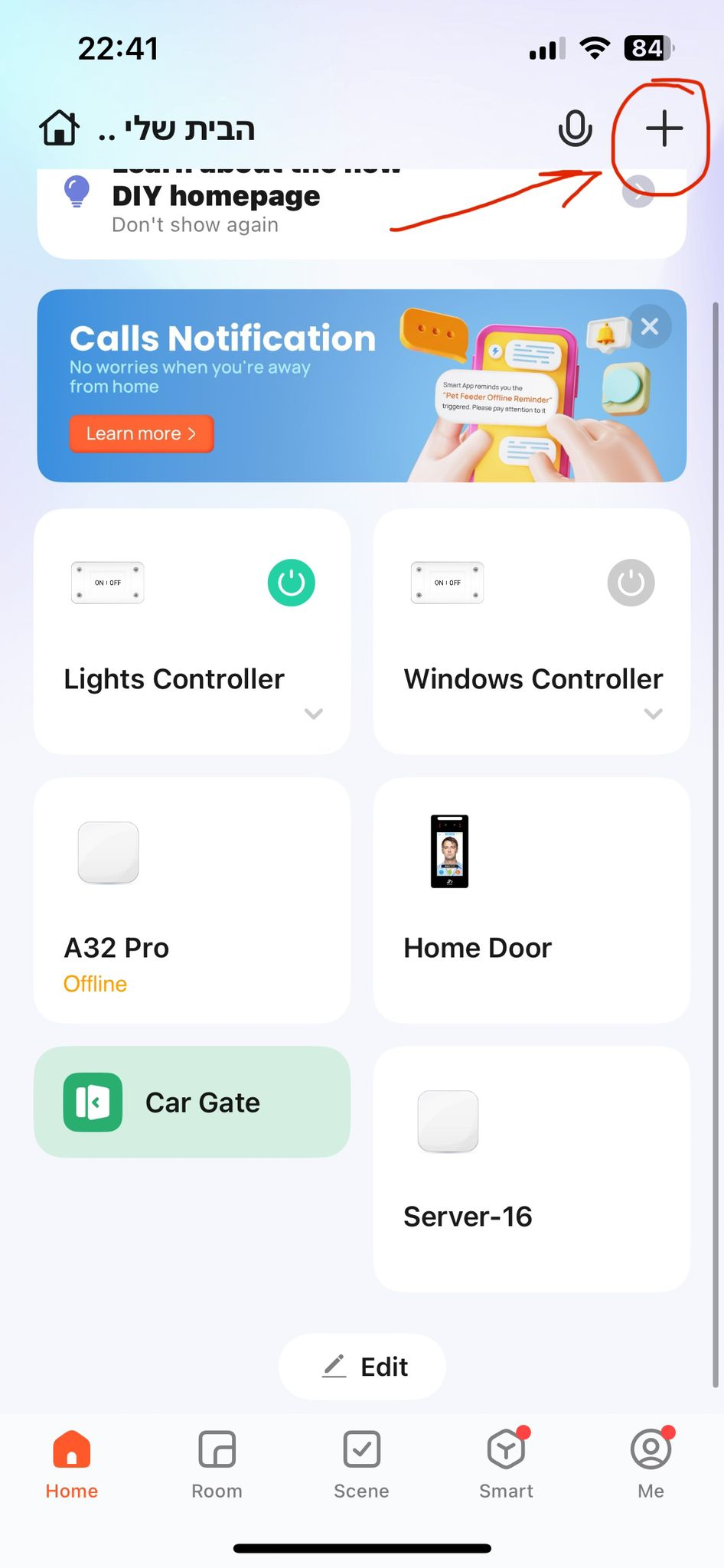

server16-tuya control - Saif Kitany - 06-19-2025
Hello suppoert team,
i have kincony server 16, and i did all the steps configurations to control it by tuya app,
but when i scan the QR code by the app, it show that the device is offline.
- I added Kincony Tuya Mqtt component to home assistant by HACS
- I copied and pasted the yaml file
- I chaned device Id as the same as i got from kincony
- I chaned device secret as the same as i got from kincony
- I changed the Region
what could i have missed?
RE: server16-tuya control - admin - 06-19-2025
post your setting information.
RE: server16-tuya control - Saif Kitany - 06-19-2025
I can give you remote control on my pc.
My WhatsApp: +972505594173
our whatsapp number: +86-15381188302
RE: server16-tuya control - admin - 06-21-2025
tuya_mqtt:    replace with    kincony_tuya_mqtt
RE: server16-tuya control - Saif Kitany - 06-21-2025
now it works Smile

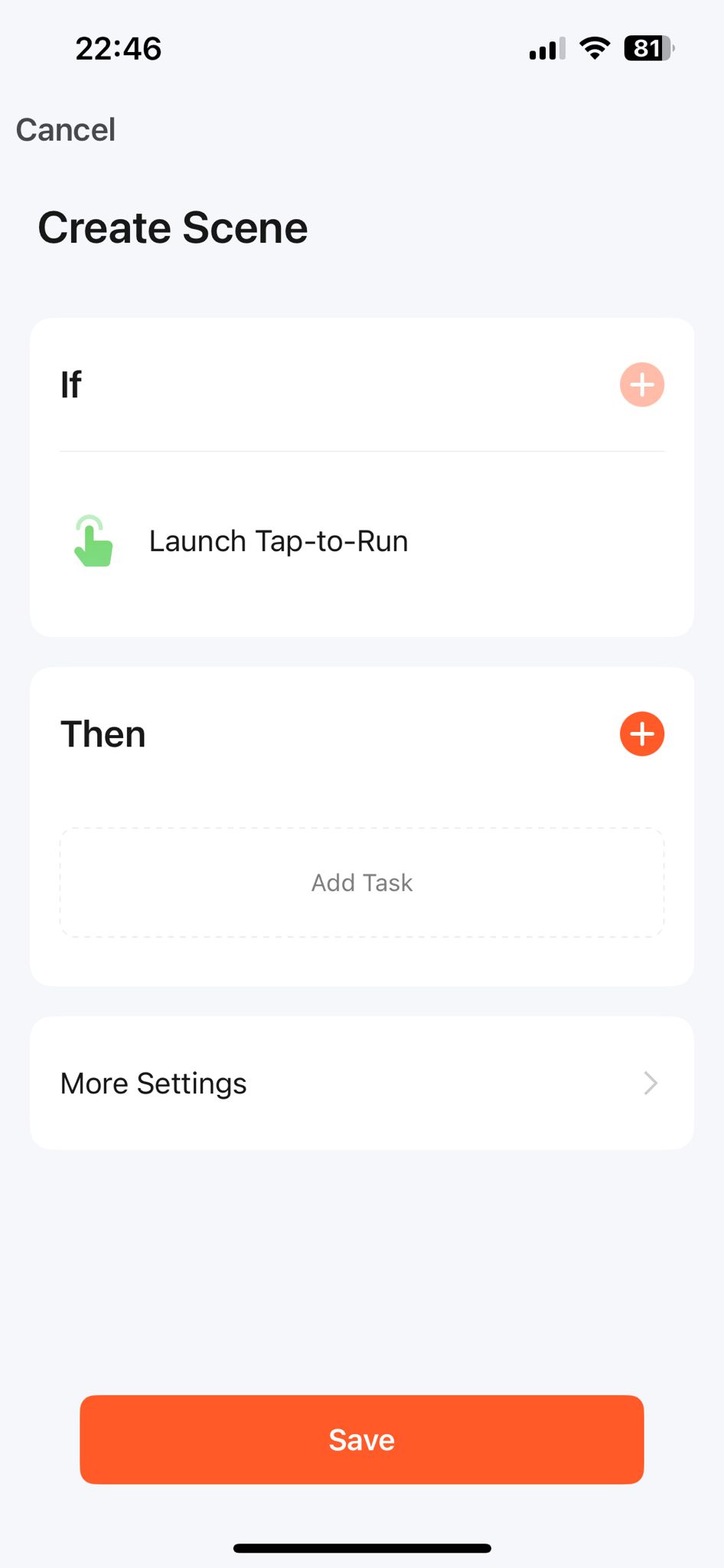

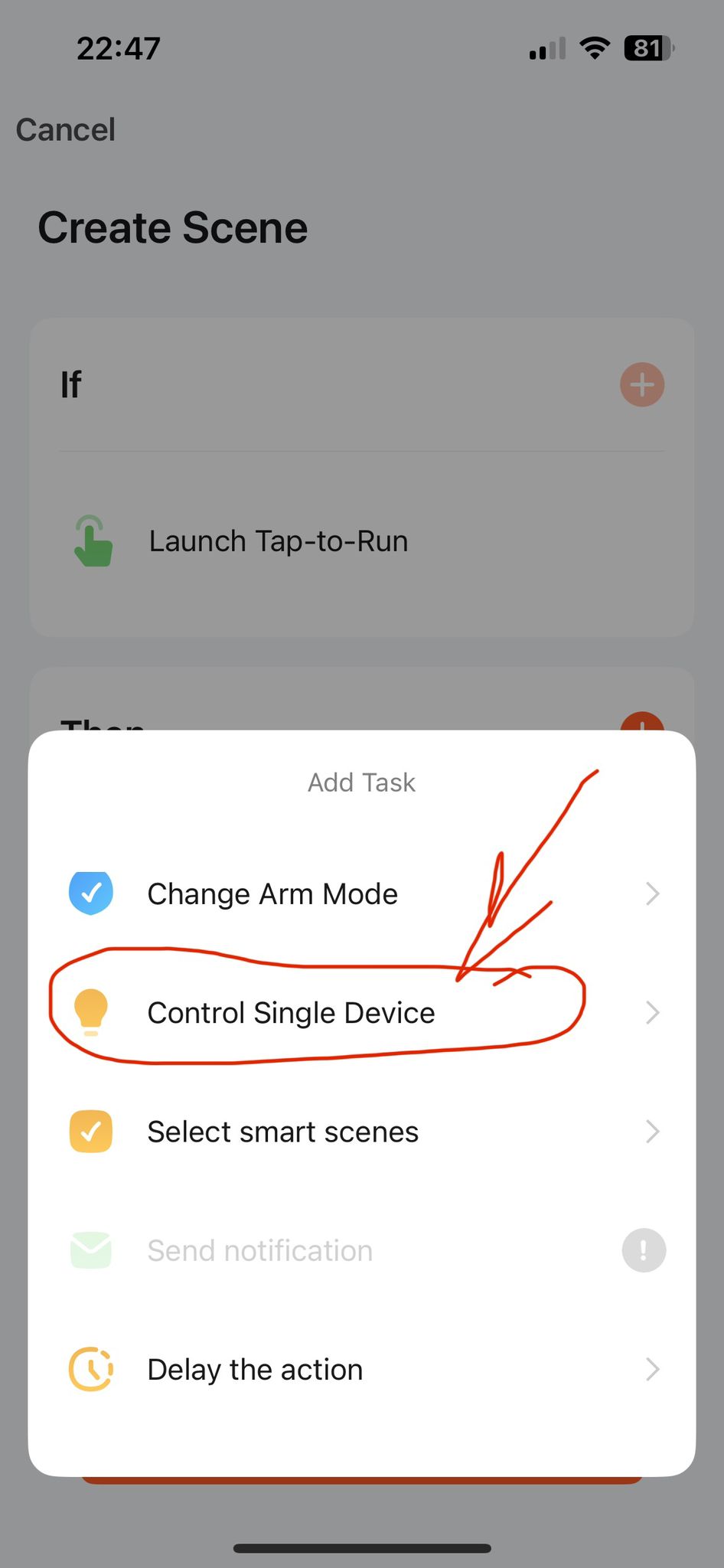

RE: server16-tuya control - Saif Kitany - 06-23-2025
ok. works.
from the other hand, when I try to do it by Tuya app, it doesn't show me the the device "server-16".
for example:
making ascene: IF  "Launch Tap-To-Run"------> THEN "conrtrol single device"
then it shows device list to choose the device i want tocontrol, and i don't the server-16 in the list!!!
RE: server16-tuya control - admin - 06-24-2025
we have updated tuya program code. now you can set again, it should be work fine.
