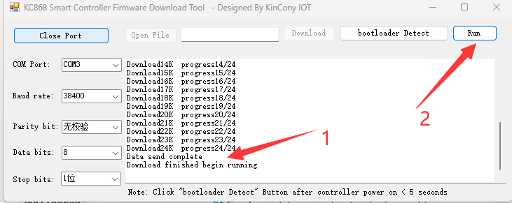

1. set baud rate=38400bps.
2. open com port.
3. power on Nx board, during LED fast blink when the "bootloader Detect" button right now. Then board will go to bootloader mode.
4. open BIN file
5. press "Download" button, begin download firmware, after finished, press "Run" button, ARM CPU begin work.

no, need use by USB-RS485 adapter for download ARM CPU firmware.

if you want update N60 ARM CPU firmware, you should use USB-RS485 cable, not use USB-C cable, USB-C use for download firmware to ESP32.
