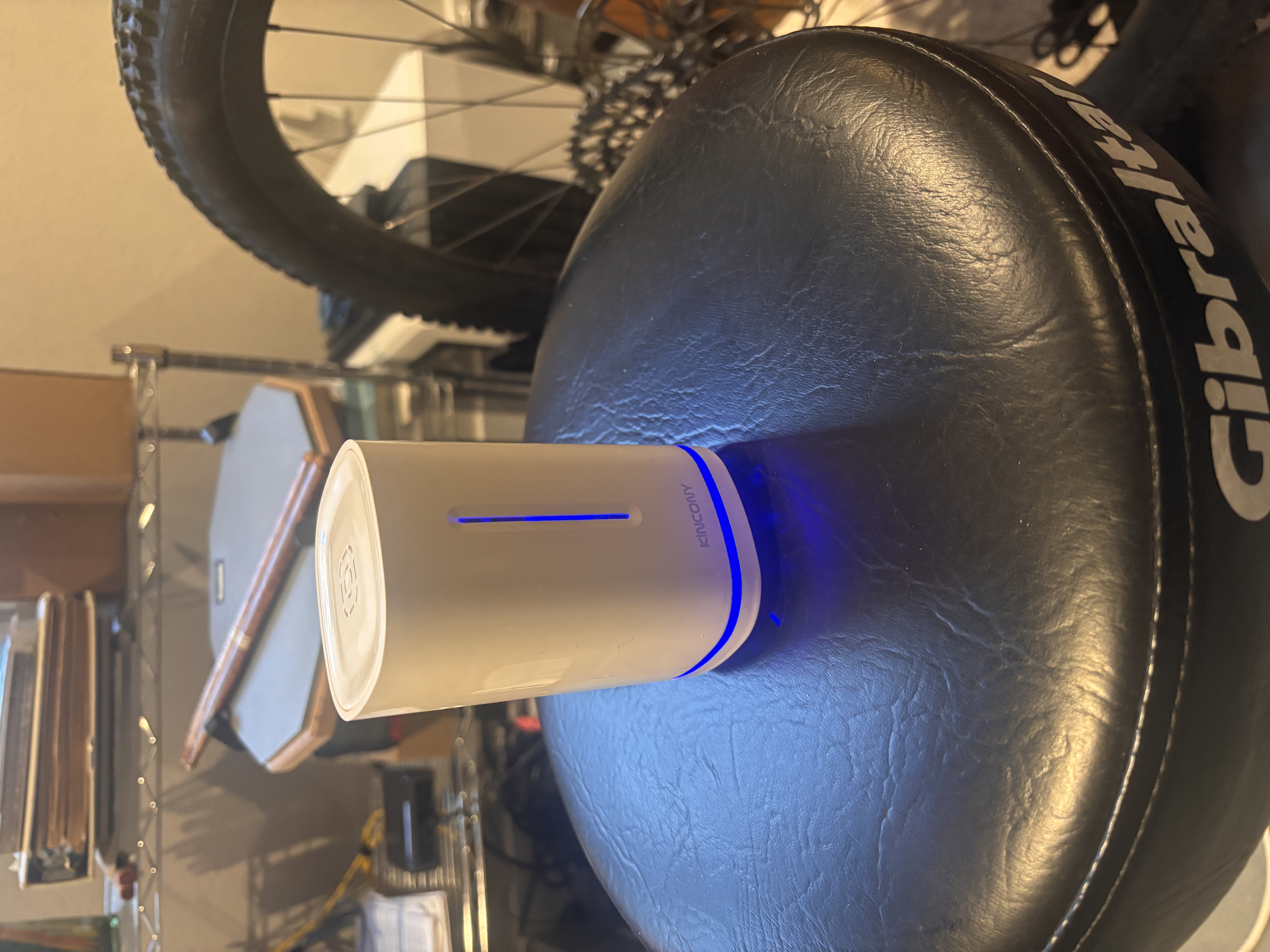

I just purchased a AS-ESP32-S3 device to act as a voice assistant for my Home Assistant. When I received the unit, something inside it was rattling around loosely - like something had broken inside. Not sure if that's ultimately important or not.
When I plugged the device into the HA server, all of the lights turned blue and a tone built up in about 3 steps to a steady tone. The tone continued without stopping for as long as I had the device plugged it (up to 15 minutes, when I unplugged it). It doesn't seem to me that it was flashed with any new firmware as described in this YouTube video: https://www.youtube.com/watch?v=g-KsrZjFljY

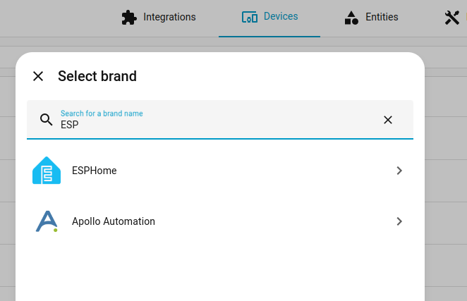

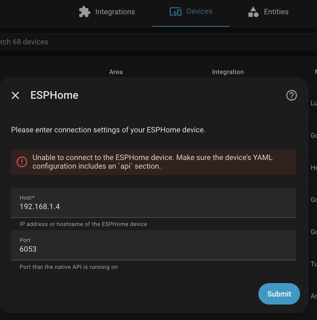

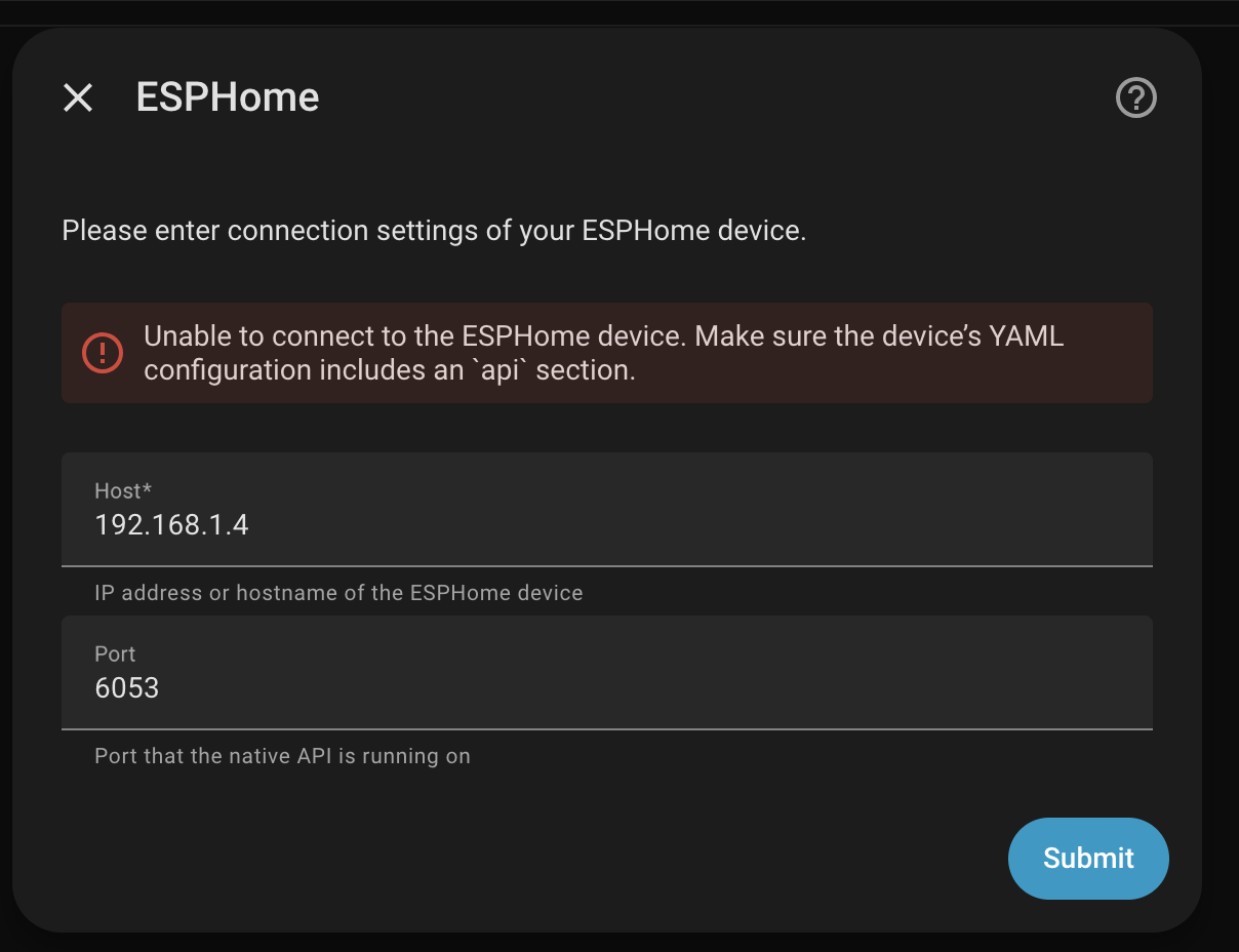

While the tone was sounding, I did try to configure the device in my home assistant. I selected "Add Device", saw ESPHome and selected it, and was presented with a modal asking for the host ip address, which I provided. I got a "Unable to connect to the ESPHome device. Make sure the device's YAML configuration includes an 'api' section." as shown in the attached screenshot. I have no way to access any YAML that the device might be using since I can't access the device and can't do anything with it in Home Assistant.

As shown in my first post, I can't install it b/c whatever YAML it's trying to use doesn't have an `api` section... it's like a race condition.

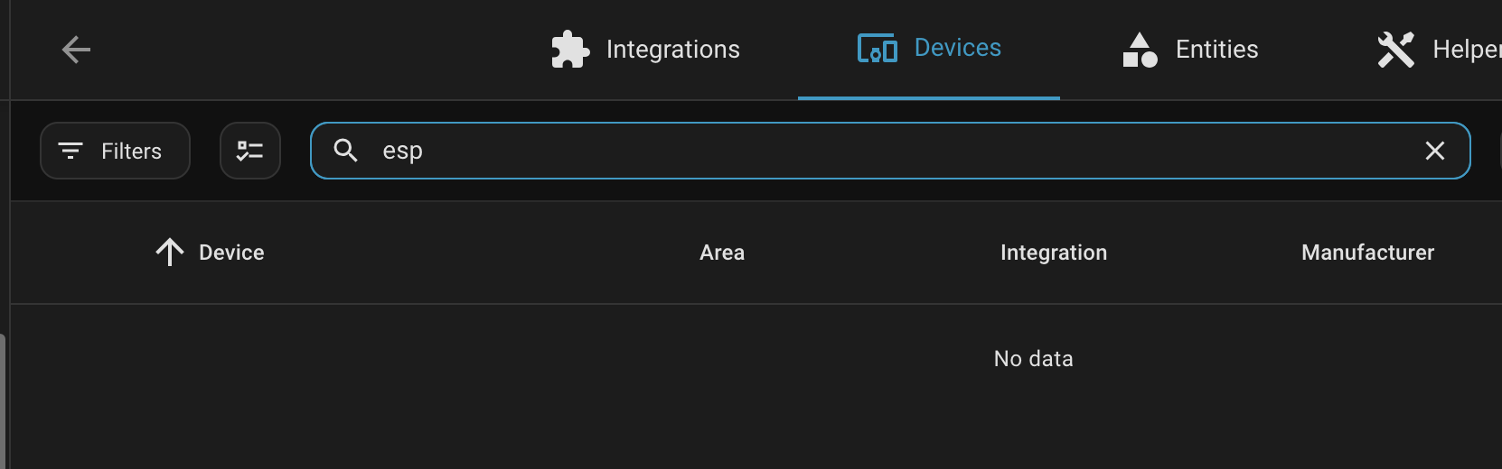

I don't know where you expect me to get the YAML from since I can't see the device, can't add the device, can't create an integration - see screenshots below. I don't know where I'd put one either. I believe this device is defective since it apparently won't flash and the test firmware never finishes its test.

ok. The problem was that I had not installed the ESPHome add-on. I don't recall reading or seeing (in the "setup" YouTube video) that this step was necessary. Once I installed the add-on then I was able to get it working.
I now the see the comment earlier on this thread "install esphome on home assistant, then create yaml paste our code." but I thought that meant to install an integration, which I wasn't able to do.
