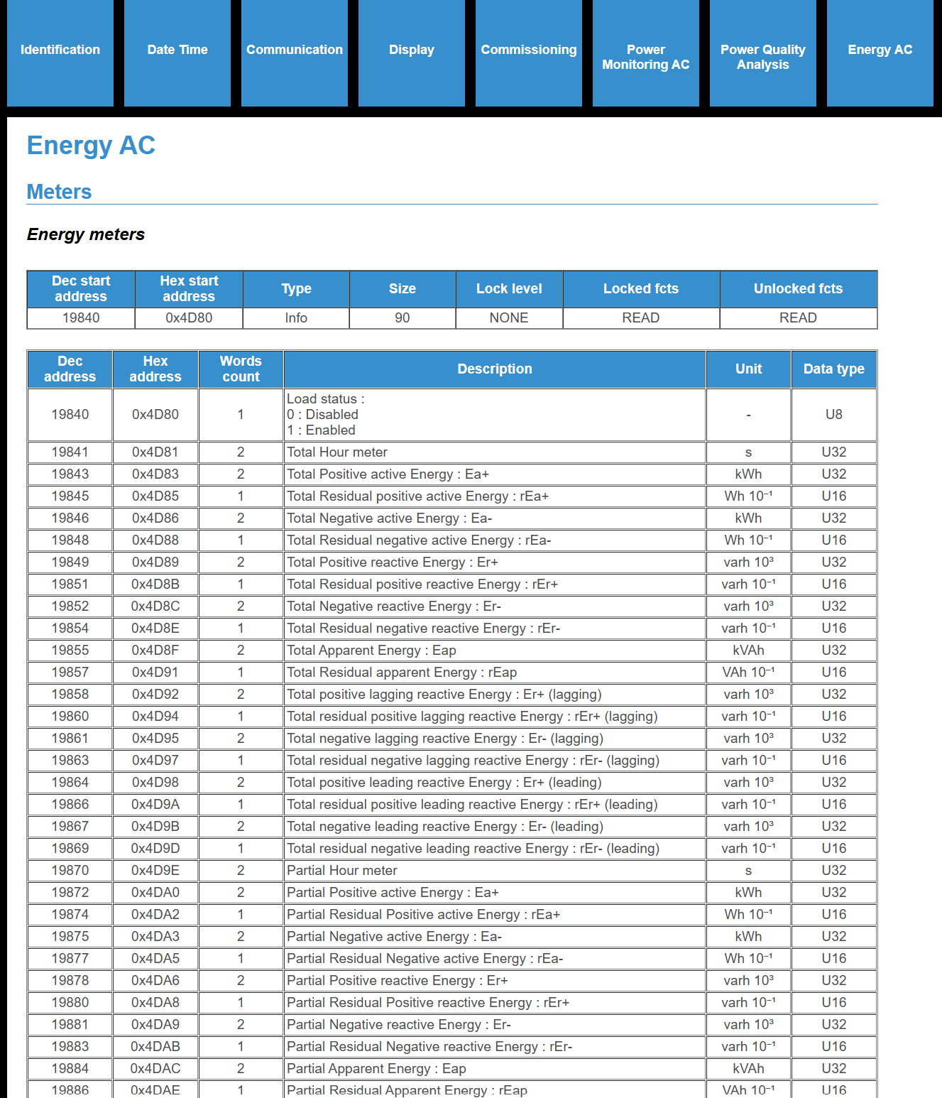

I know that power meters we are using at my work (of brands Socomec and Janitza) keep the positive and negative values for Energy separated so we can see exactly when we consume or deliver. I can do that in my Data Historion but it would be a nice feature.

[URL] https --> emea.socomec.com/sites/default/files/2021-06/DIRIS-A-40---MULTIFUNCTION-MEASURING-UNIT---PMD_CATALOGUE---PAGES_2021-06_DCG_EN.pdf
The modbus registers for a device like this:
[URL] https  -->  www.socomec.fr/sites/default/files/2024-03/DIRIS-A-40-1.7.4_COMMUNICATION-TABLE_2022-01_CMT_EN.html#Energy%20AC
I know these are advanced measuring devices usin in the industry. but the concept is not that different from what the BL0910 does.
If total energy would be splitted into two registers one for +  and the other for - it would also allow tot totallize these registers to get the effective energy consumed.
