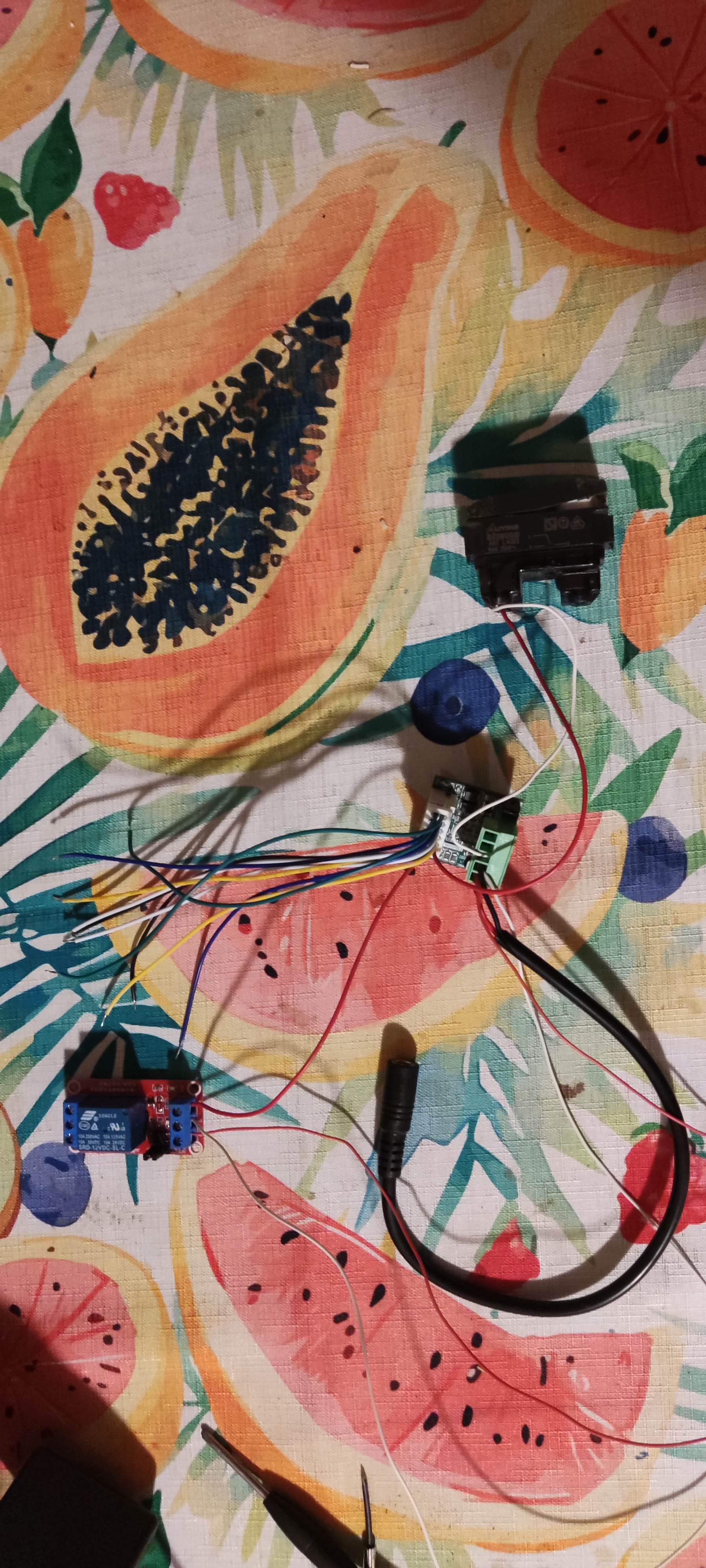

RE: problem with kc868 has v2 - Gianfranco Pepi - 05-22-2026
(05-21-2026, 10:12 PM)admin Wrote: where is kincony product? HAv2? take a photo.
Here is the way I'm testing the board, same relay power supply and kc868hav2, the output is connected to the already set relay input which must receive the negative according to your wiring diagram present in the forum, button connected to input 1 and the board is in default so in theory since it is in rising Edge in toogle output mode every time I close the button it should vary the output, this does not happen! the relay works because if I jumper the negative with the input it activates, I also tried with other inputs and other outputs nothing to do, this board just does not want to work! obviously when I am connected with the rs485 adapter through your software every time I press the button the software shows me hexadecimal codes so let's say that the input works, it is the set logic that is not working!
RE: problem with kc868 has v2 - admin - 05-23-2026
if you want use HAv2 output for relay, your relay need driver, HAv2 output only mA level, can't drive relay directly.
when short HAv2 INPUT with GND, it will feedback RS485 command. But INPUT not TOGGLE with OUTPUT directly.
INPUT feedback message to RS485, OUTPUT control by RS485 command.
if you want INPUT toggle OUTPUT directly, you can use any kincony controller. just set digital input toggle relay output by IFTTT.

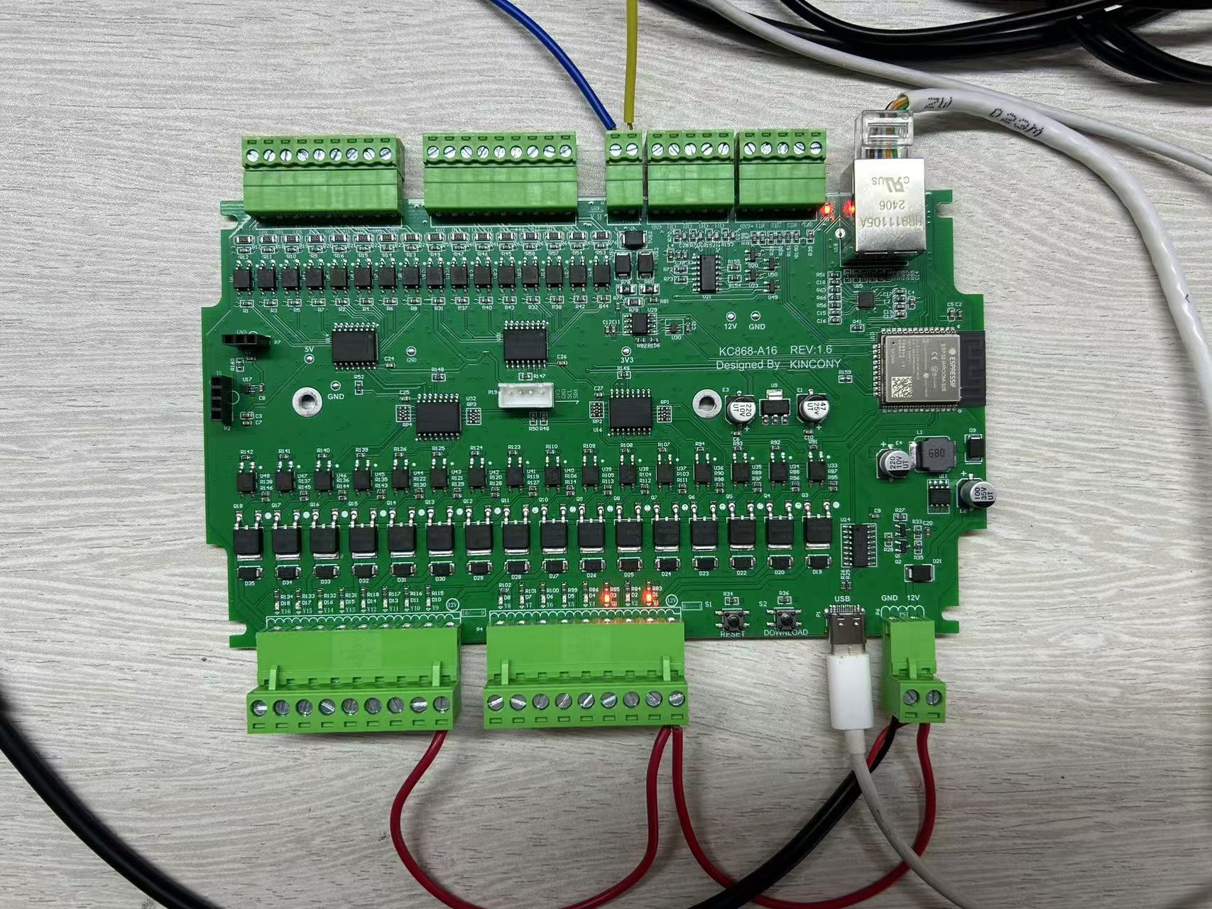

KC868-A16 is P mos output, when turn on, it will output 12v or 24v. see this photo, maybe you have not connect with RED cable with "DC" terminal.
