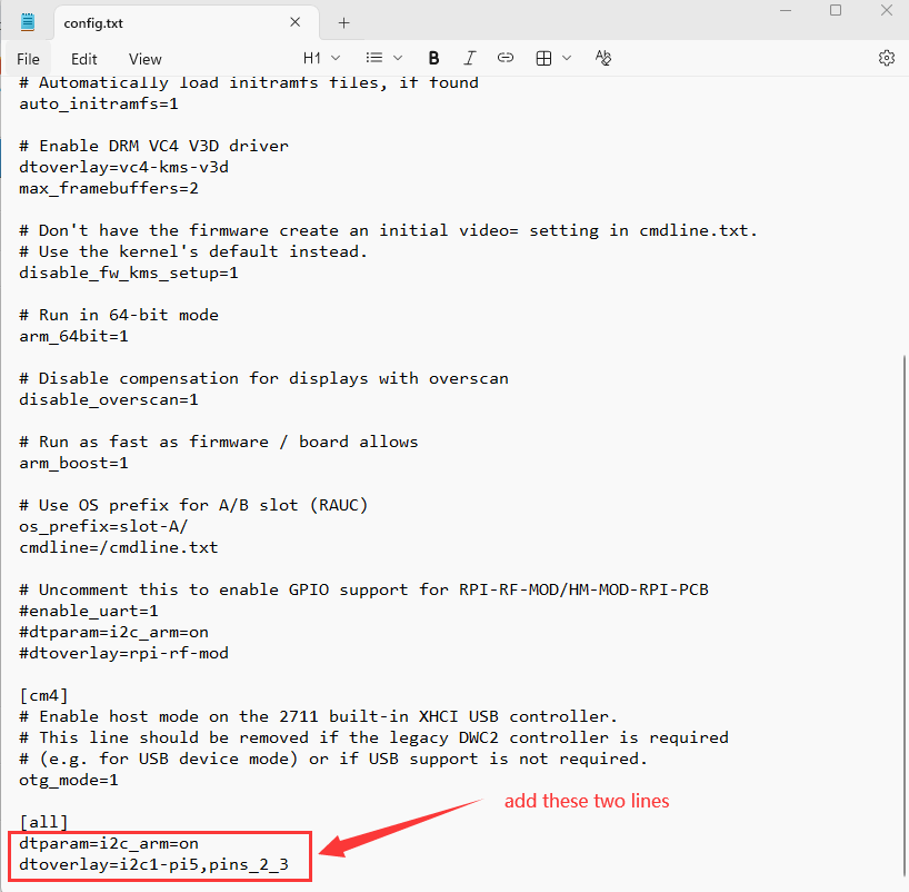

In the root of the hassos-boot partition, add a new folder called CONFIG.
In the CONFIG folder, add another new folder called modules.
Inside the modules folder add a text file called rpi-i2c.conf with the following content:
i2c-dev
In the root of the hassos-boot partition, edit the file called config.txt at last add two lines to it:
dtparam=i2c_arm=on
dtoverlay=i2c1-pi5,pins_2_3
restart home assistant.
