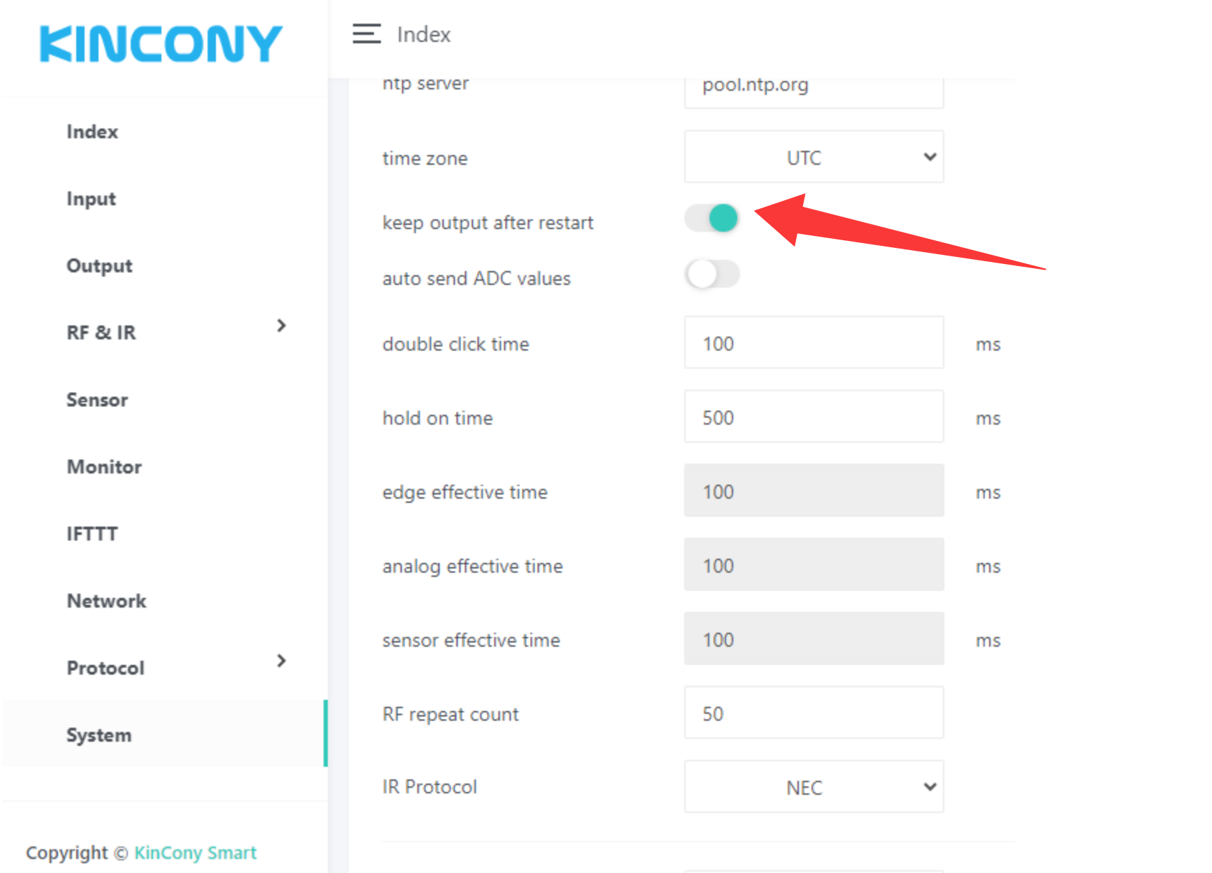

Hi everyone,
I'm using the KCS v2 firmware and would like each relay to restore its last state automatically after a power outage. Right now, all relays switch to OFF every time the controller reboots.
Is there a built-in setting in KCS v2 to save the relay state in flash memory and restore it after startup, or does this need to be handled through MQTT or Home Assistant? If anyone has configured this successfully, could you share the required settings or steps?
Thanks!
RE: Relay state after power restore? - admin - 07-22-2026
just enable this option.
