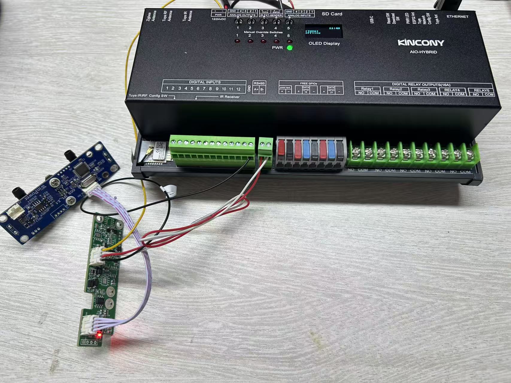

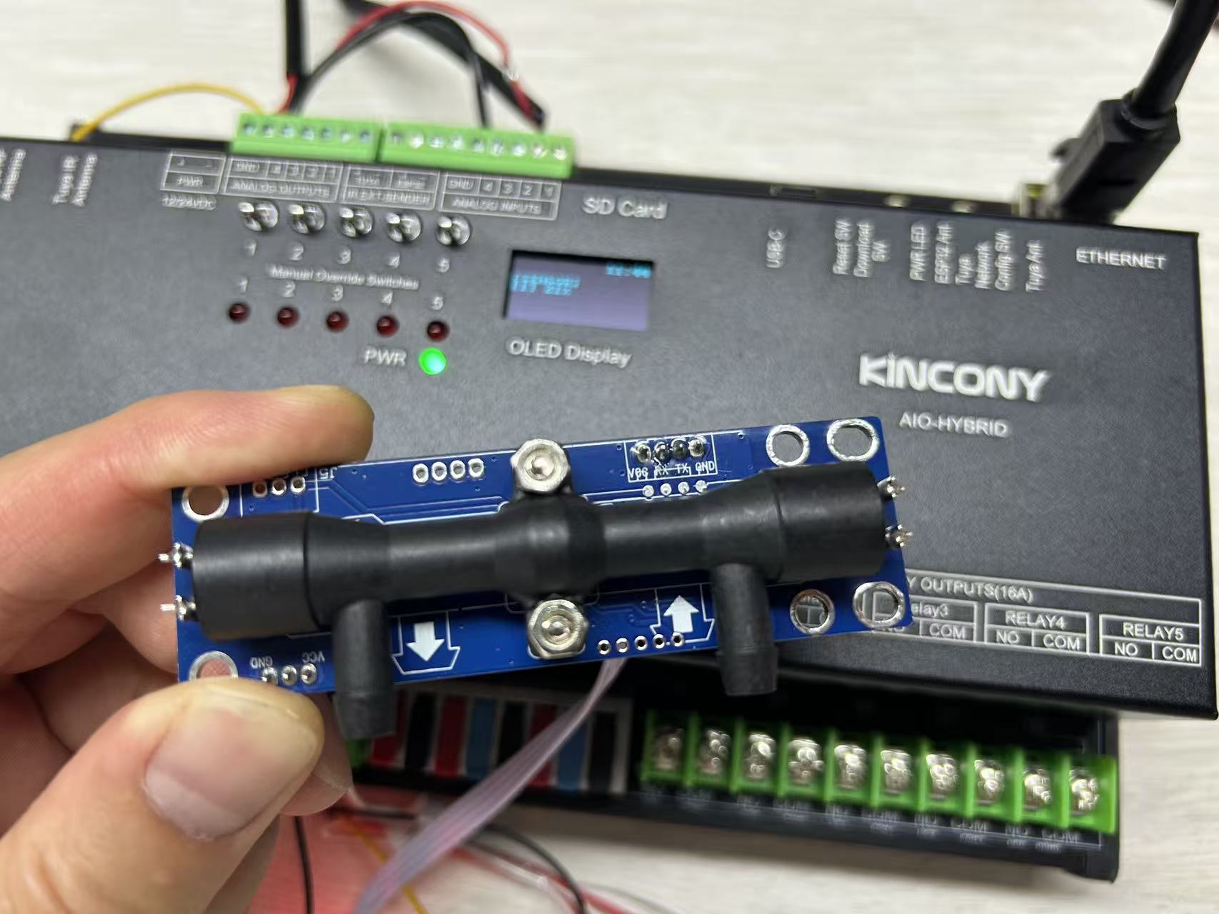

here is KinCony AIO Hybrid smart controller work with oxygen modbus sensor using RS485

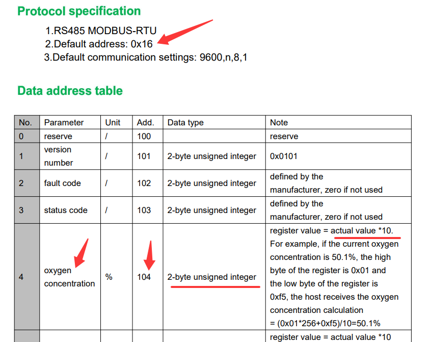

here is oxygen sensor modbus protocol:

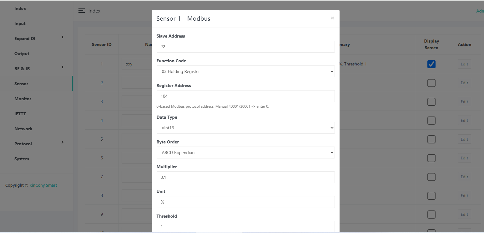

here is config sensor in KCS "sensor" webpage, chose "modbus" type of sensor.
slave: 22
function code: 03
register: 104
data type: uint16
byte order: abcd big endian
multiplier: 0.1

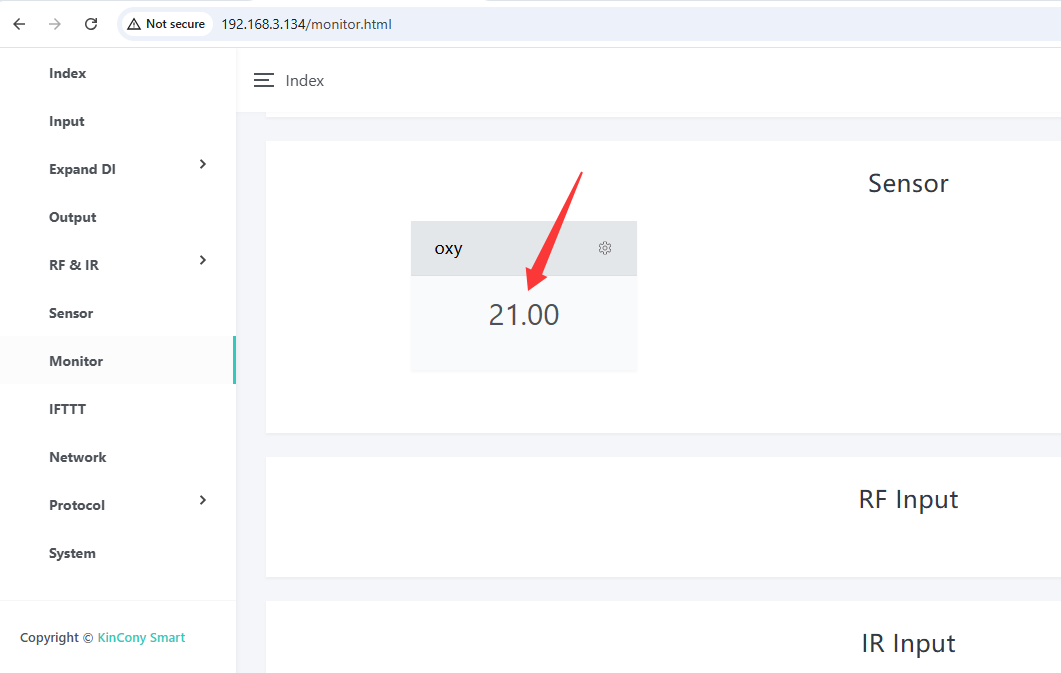

KCS monitor will show the sensor value:
