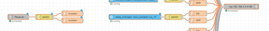

oh, just realized that the relays on this flow are only visible on a node red dashboard, which I have no interest in creating. I would like to keep the switches on the main HA dashboard. I can control the relays on the relay board, but can't get feedback from the board when a switch is manually operated on the expansion board.
Is there a way to connect these two ends:
