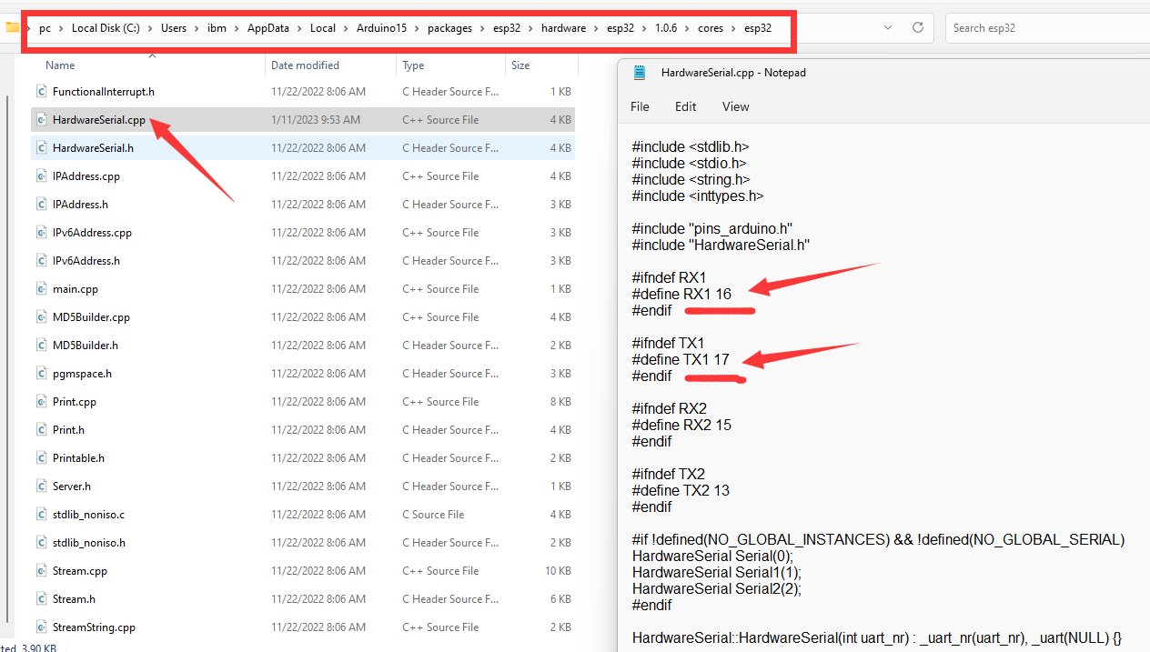

i have tested code, sorry for my before error photo.
just set serial1 pin define as these will be work fine. here is photo.
#ifndef RX1
#define RX1 16
#endif
#ifndef TX1
#define TX1 17
#endif

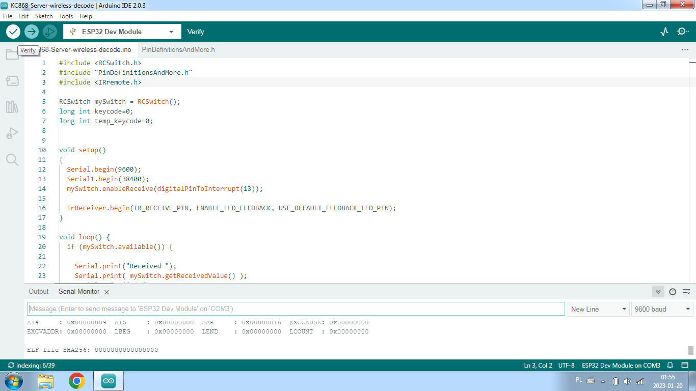

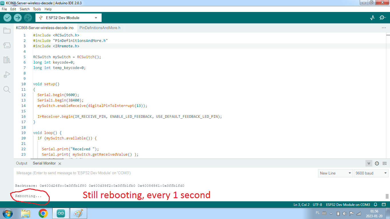

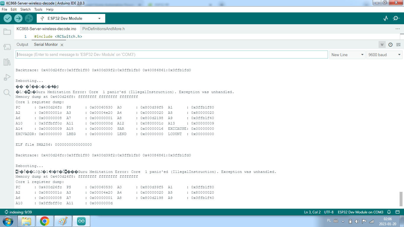

I tried flash esp32 via USB C cable. I want start use RF decooding, i do every steps form https://www.kincony.com/forum/showthread.php?tid=1797, lesson 11.
I verify file before flashing, was OK, i Flash untill 100%, restart and now ESP32 in my kc-868 server keeps rebooting. Propably i need clear, new file to flash ESP32??

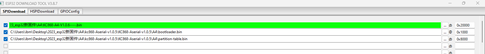

#28
because you have not upload full file. you can download these file in different addrss, see this photo.
your BIN file at     0x20000
bootloader.bin      0x1000
partion-table.bin   0x8000
here are  bootloader.bin  partion-table.bin  just download zip file, unzip it.
.zip   bootloader.zip (Size: 15.42 KB / Downloads: 394)
.zip   partition-table.zip (Size: 271 bytes / Downloads: 397)

#30
any user bin download at 0x20000
your BIN also download at 0x20000
