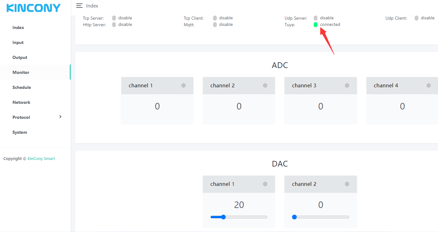

you can test this V1.0.18 have fixed this bug. here is download firmware:
.zip   KC868_A8S_V1.0.18.zip (Size: 720.1 KB / Downloads: 557)
mqtt feedback message for analog input range is 0--4095
#14
Thankyou Very much for the quick update and firmware
works perfectly, now the values sent through to MQTT
Thankyou Again

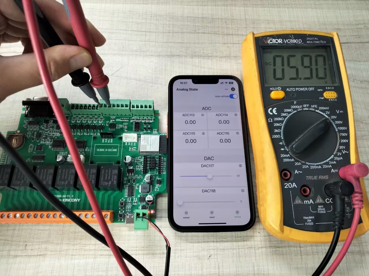

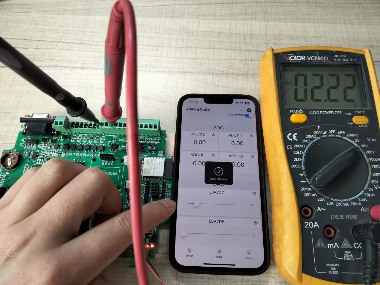

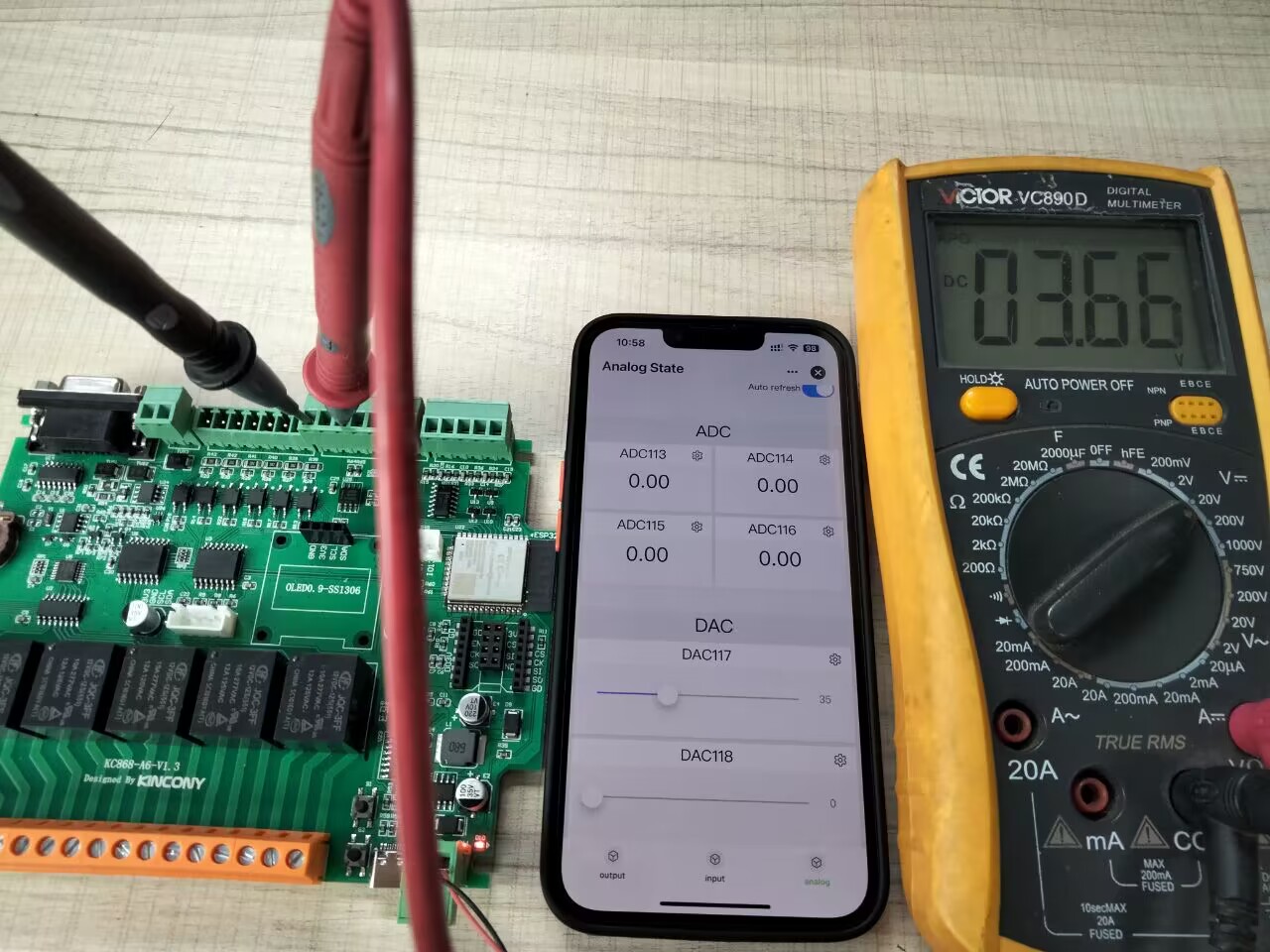

maybe it's internet problem, you can switch your mobile phone by wifi or by 4G for a test. we have tested A6 with tuya, all are work fine.
